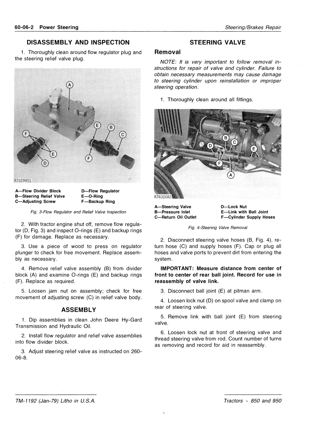

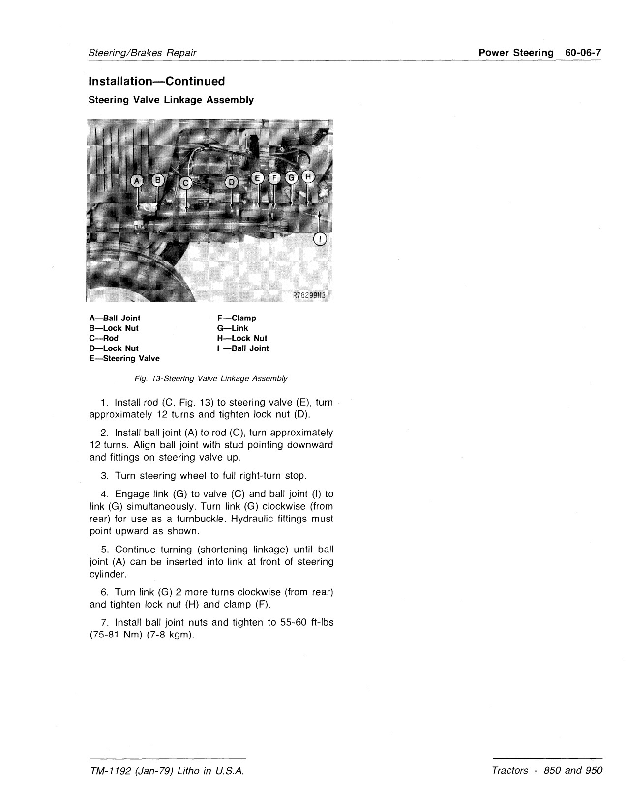

On the YM2500 and other models like it along with the Deere JD850/950/1050 - - -
WIP, got to get better quality
Possible to glean info from any of this. ;)

/ Crazy idea? #44
OK, the YM2500 = JD850 & YM4300 = JD1050
Possible to glean more info - - -
high-res, just click and click to zoom in
