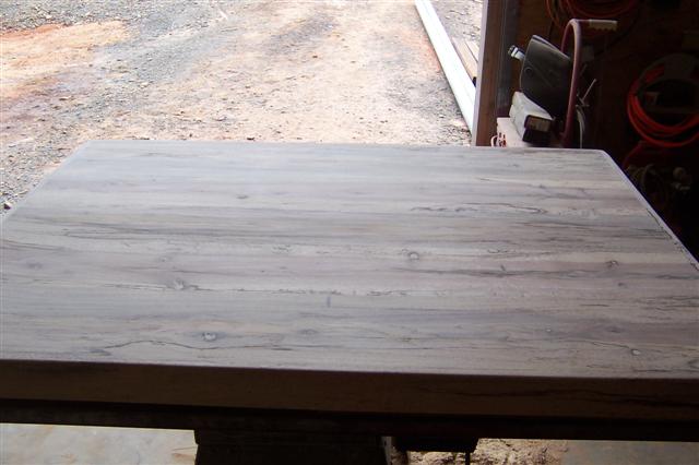

First Picture,
I spent the morning sanding the table top with my 120 sand paper. I got it nice and smooth, then wet it down with a rag and sanded it again after it dried.

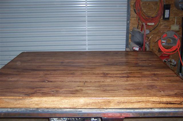

Second Picture,
I stained it with some Minwax stain called Early American. Then after letting it dry all day, I put a coat of Minwax Polycrylic. It's still wet in this picture, so it's looks shinier than it will when dry.
I've found that those cheap foam brushes work the best for putting on the finish coat. No streaking or hairs from a brush.

Hey Eddie. Lookin' good.
I'm assuming you will be putting more than one coat of finish on the table top. Now is a good time to gently rub out the first coat. If you ended up with much dust in the first coat, you can very gently sand, almost like dusting, the surface with 220 or 240 grit aluminum oxide paper. Don't touch the corners, they will take care of themselves.
If the first coat is pretty much dust free, then gently rub out the surface with 0000 steel wool. If you sand the surface first, you will still want to go over the surface with steel wool. You'll be able to feel the surface smooth out, you don't need to be extreme, just try for a uniform level of smoothness.
This will result a finish that more closely resembles the oiled finish look you are shooting for.
Rub out your final coat with 0000 and burnish lightly with a cotton denim rag. You will find that the final coat rubs out much easier than the first coat.
Remember, leave the corners alone so you don't rub through your stain. By the time you're done the corners will be nice and smooth just from the 0000 having skimmed them while rubbing out the flat surfaces.

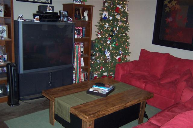

   / Creating a Coffee Table for Steph
#58
Hi Mike & Scotty,
Thanks for the advice.
Before I stained, I finish sanded with my 110 paper to a nice smooth finish, then I wet the wood and let it dry to raise the grain. I sanded again before staining.
When I put the first coat of finish on, it felt like the grain was raised again. I sanded with some 320 paper to a super smooth finish and cleaned it real good. The second coat of finish dried very smooth, but not perfect. I sanded that one just lightly. The third coat dried to a perfectly smooth finish. It's so smooth it feels soft. Isn't that funny when hard oak can feel soft to the touch? hahaaha

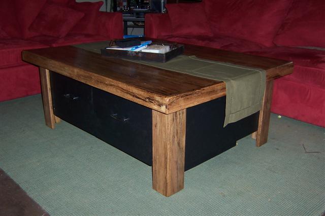

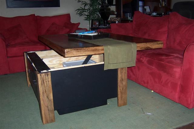

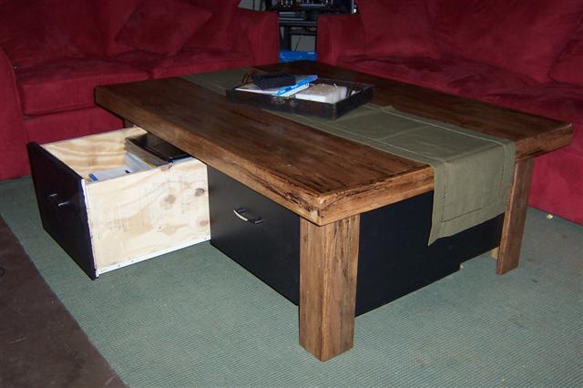

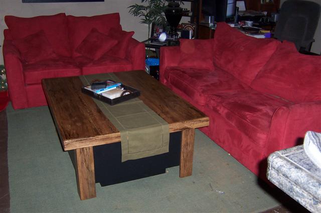

Last night we put it all together. Mounting the angle iron to the table top was tricky, but after awhile I figured it out.
The toughest part of the brackets was to make them the right size and mount them in the right location so it would be comfortable to eat when in the upright position from our sofa. It took more hours than I want to think about, but now that it's together and working right, it was all worth it.
We had our first meal on it last night and wouldn't change a thing. Then after we ate, she set up her scrap booking stuff and finished off day one of our honeymoon. She kept remarking about how much room she has and how nice it is to have the table up at the perfect height. When she was done, she put everything away in the drawers and we lowered the table.
She is very happy with it, so I'm very happy!!!
Thank you everyone for your help and advice,
Eddie
