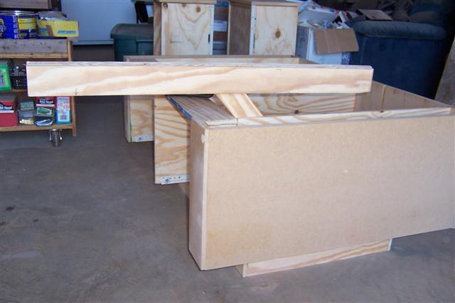

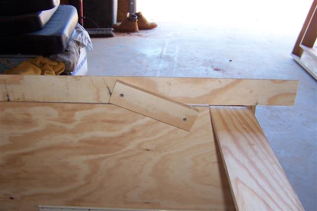

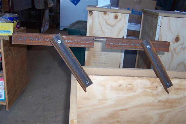

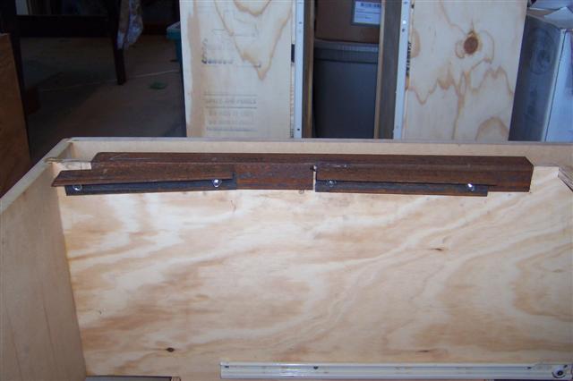

One of the goals of this coffee table is for the top to be able to raise and convert into a table to eat off of while sitting on the sofa watching TV. I priced brackets from various online sources and thought they were way too much money.
Being cheap and a do-it-yourselfer, I decided to make my own bracket. My brain always starts out on these things in the most complicated way to accomplish it. There is a process that I have to go through to get to a practical, working design that will work and do the job.
Once I cut out all the extra BS in my deisign, I realized I only needed three pieces for each side. Then I cut some scrap plywood to size that I guessed would workd and started to test my plan.
When I knew how long the metal had to be and where the holes needed to be, it was pretty simple to cut some angle iron to size and drill holes for the bolts.
Eddie

   / Creating a Coffee Table for Steph #37
Eddie,
in picture 53, it looks like you are going to have some interference. Are you going to notch the wood or cut down the angle iron so the top doesn't touch the moving part of the hinge?
Derek
#38
Derek,
Thanks for mentioning that. I thought I took the picture after I cut the ends down and rounded off the edges. I didn't even look at them very closely when I posted them, but now I remember that I didn't take a picture of it after that.
Now the brackets are painted and ready to be put together, but the box and drawers are waiting for Steph to prime and paint them.
Eddie

Mornin Eddie,
Your gonna need your brother over your place to lift that thing up into position ;) :) :D I mean a big strong guy like your self to move that monster ;) Lookin good !
#40
Morning Scotty,
I've been wondering about that. How hard will it be to lift? Two of us will be able to do it easy, but can Steph lift it by herself?
On the ones they sell for $150, the metal is much thinner and they seem sort of flimsy overall, but they have springs on them. I'm wondering if some heavy duty springs might help?
I'm just confused on how to do it right now. I know that it's something I can add at any time, so it's not a rush, but it is something I'm thinking about.
