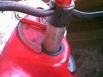

I made a new steering column tube for my 8n after finding some thin walled 1.5" OD pipe that was a few thousands over sized on the OD where the tube needed to be pressed into a cast top cover for the box. on the other side, the ID needed to be opened up a few .00X to press in a steering bushing.
I used my poor mans spinning deal I detailed above and used emory paper to turn down the OD, and on the ID, I used a stone chucked into another hand drill and let them counter rotate. again. it took longer to drill out the 2x4 and nail it down to my bench than it did to pull a few .00X off the OD of one side and the ID of the other.
that tube has been living in my 8n for right at 10ys now...
soundguy
