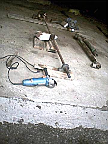

Here's a couple pics of the shaft turning method I mentioned.
The shaft is set in the pillow blocks, pulley installed and motor (blue - upper right) hooked up to spin shaft. Then I used my small grinder to grind it down to within about .030, then finished it to size with the file.
