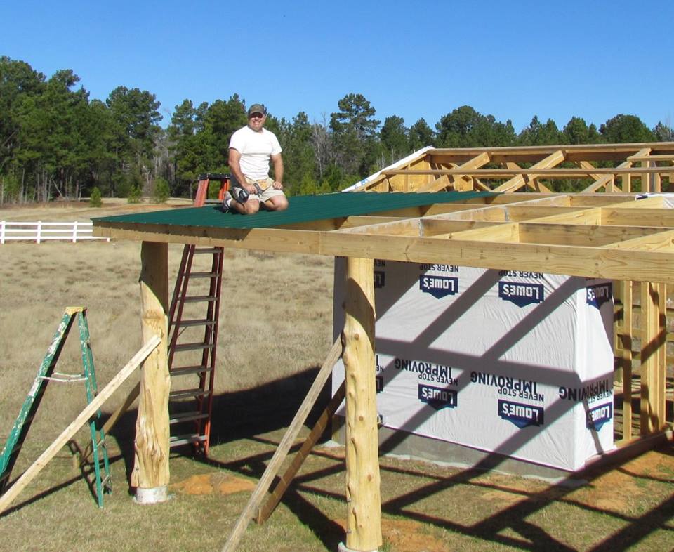

Are you also doing the fence in the background? When you get the chance could you please do a quick "how to" on putting up a ridge beam? Thanks
Yes, part of the project is fencing in four acres for the horses. This is also part of our driveway, so I want it to look nice as we drive past it every day.
As for the ridge beam, it's just a matter of going to Gable Roof Framing Calculator - Gable Roof Plans - Online and putting in the dimensions of the building. They do all the calculating. Then I print it out and cut everything like they say to. For this job, the bottom of the ridge beam is 2 ft 1 3/4 inches. I had Karen cut the boards and we just placed the ridge beam on top of them.

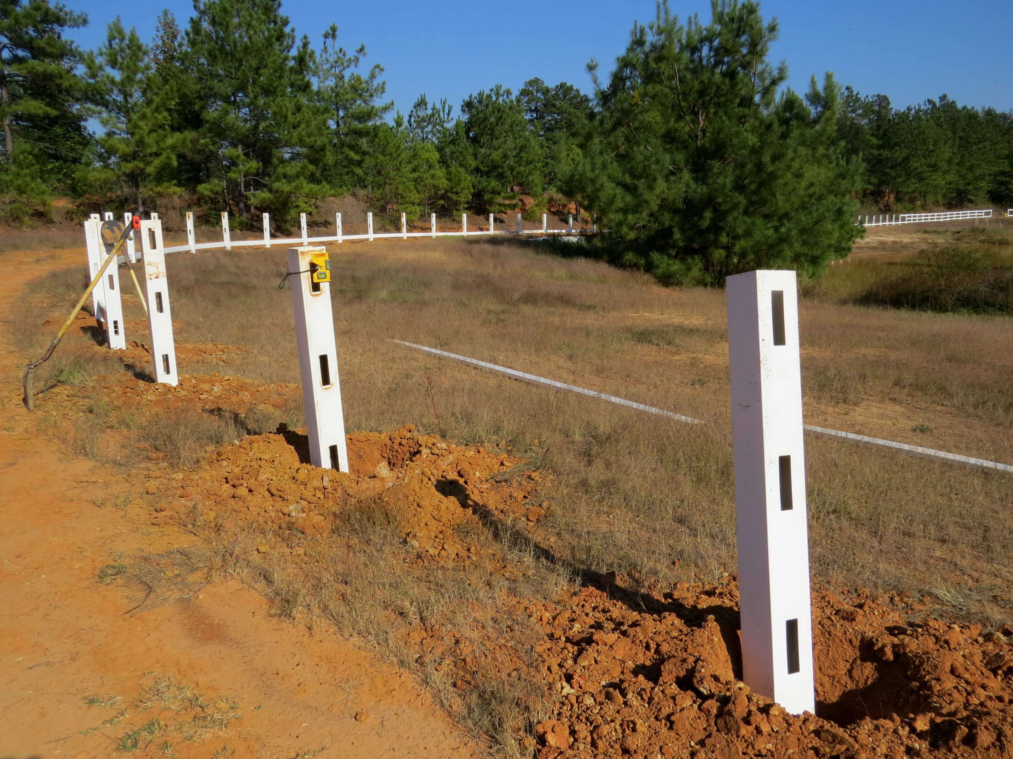

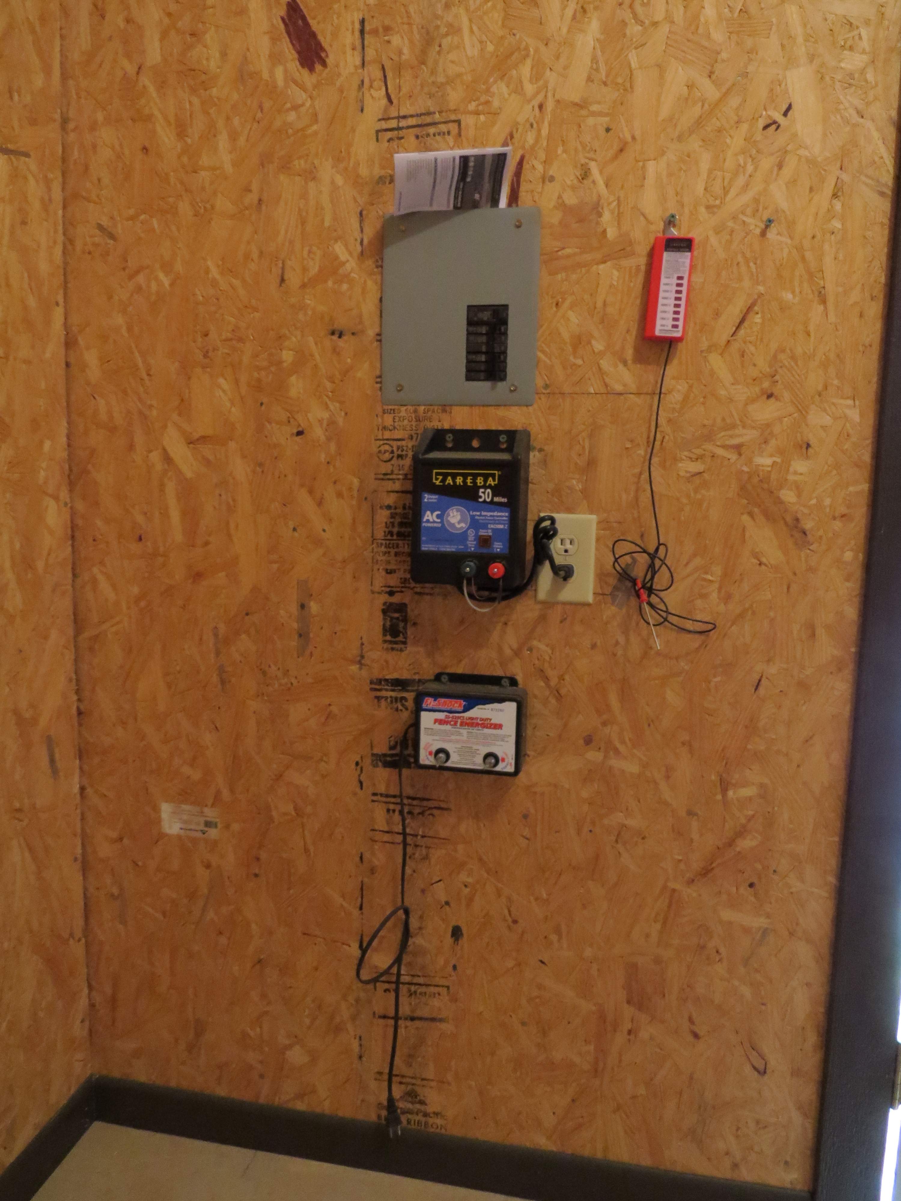

Yes. We really like the look of the white vinyl three rail fence. Unfortunately it's not strong enough to keep anything in, so we are running three rows of aluminum for a hot wire. Top wire is for the horses, middle wire is for Oscar, and the bottom is to keep critters out.
I'll post some pictures when we have the wire strung and everything working.

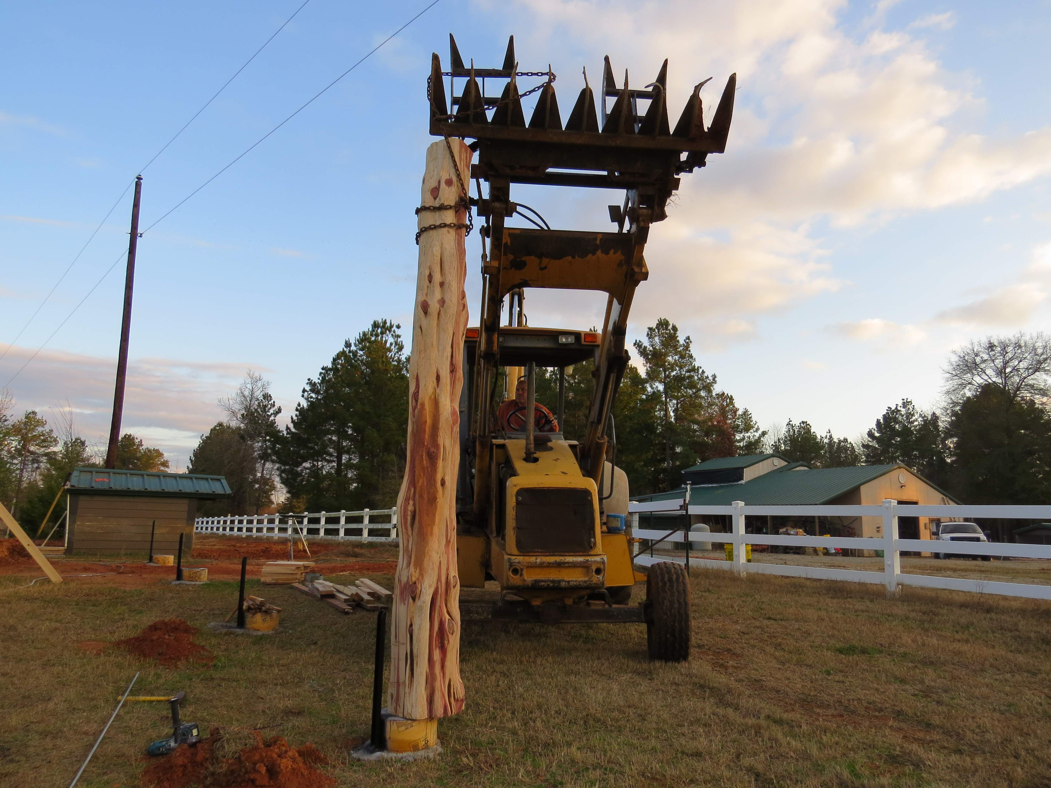

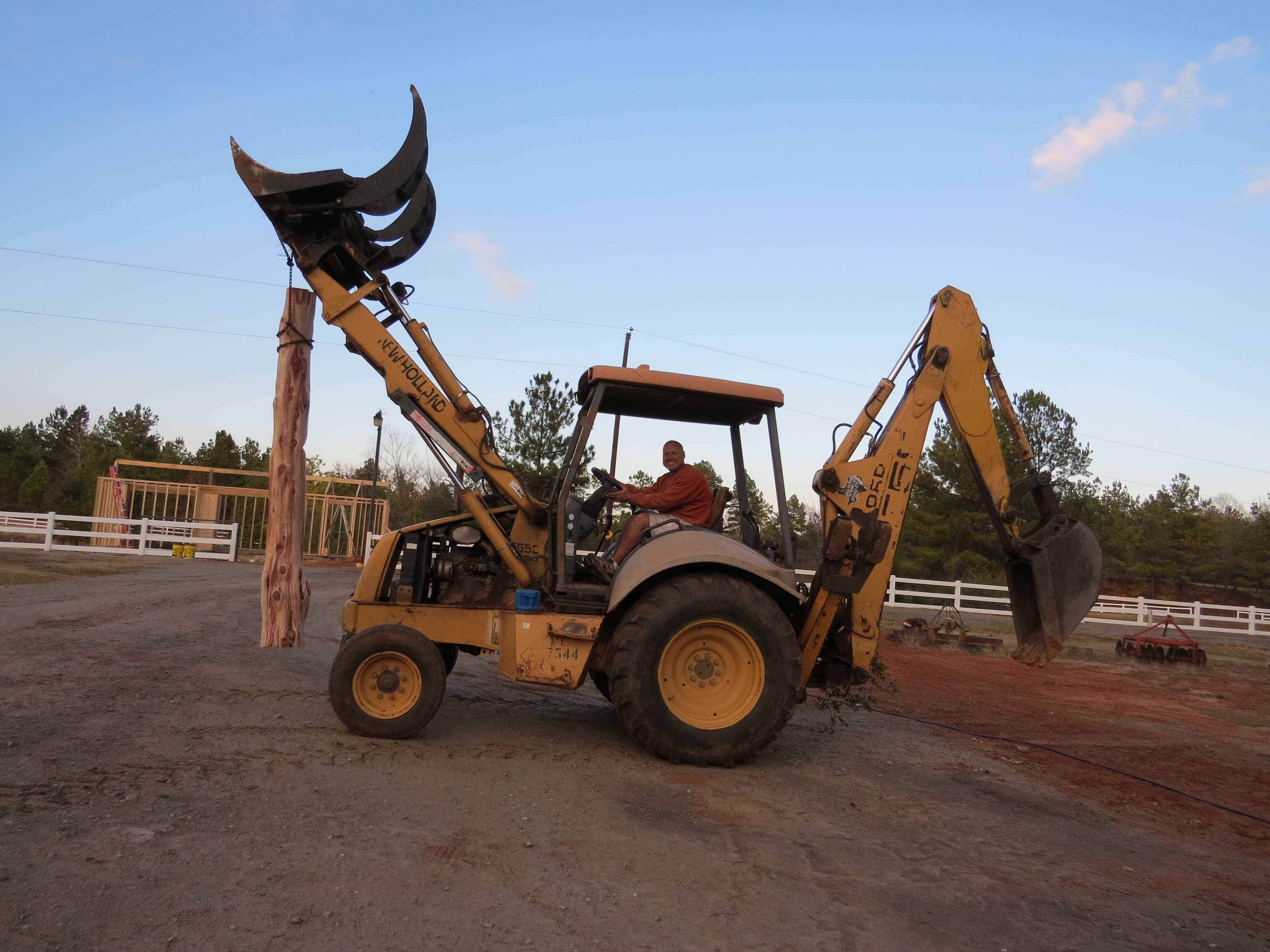

There is going to be a porch type roof coming out about 12 feet from the barn with four cedar posts supporting it. Karen and my parents spent the day working on the posts.
