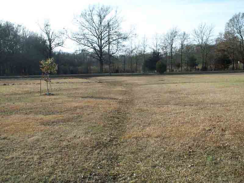

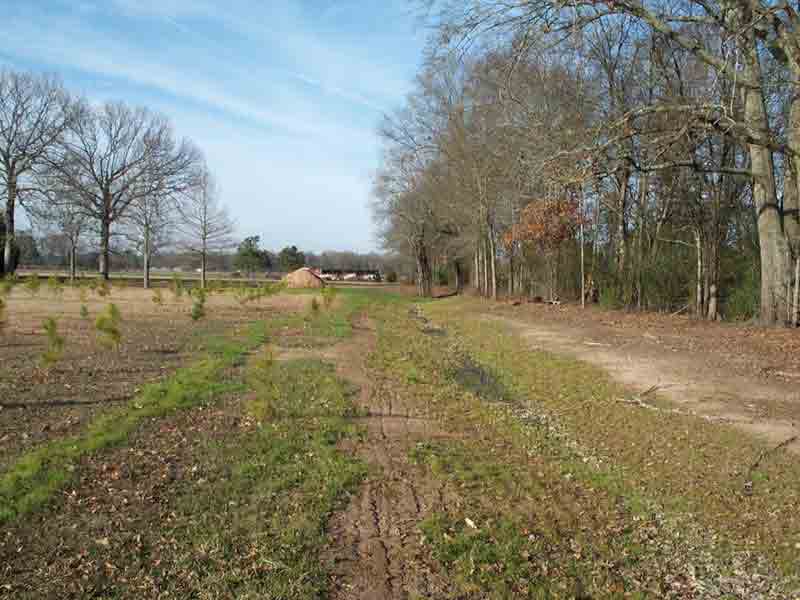

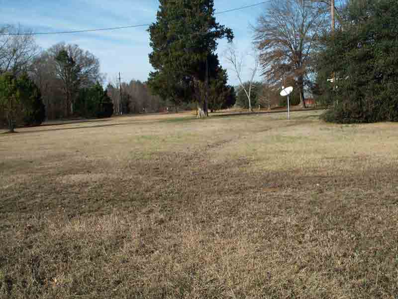

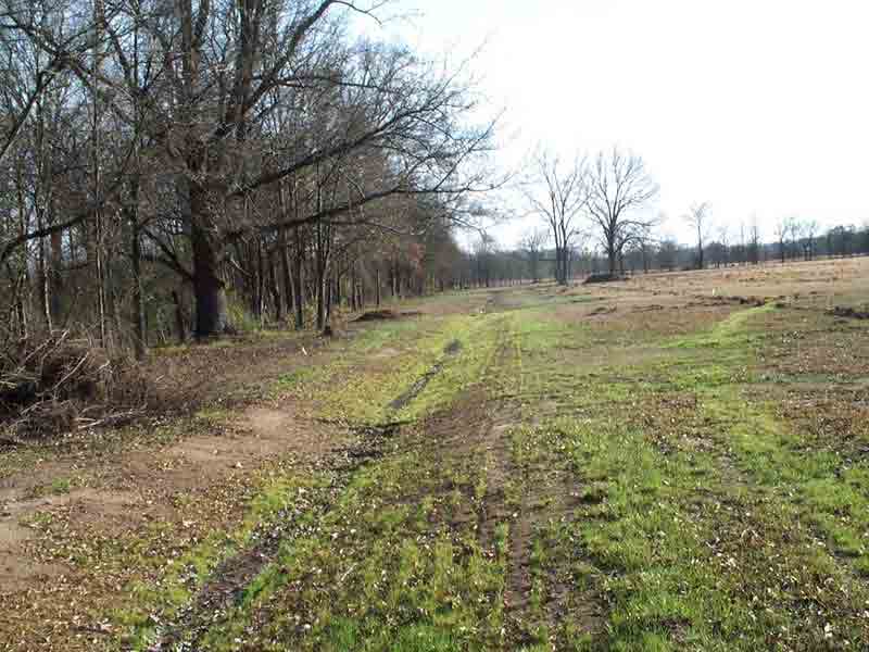

Where are you in Louisiana? It sounds as though it’s just as wet where you are as it is here! I used my box blade set with a “tilt” to make my ditches, but when I got about 12” or so deep I used my FEL to move dirt quicker. At one point I used a middle-buster in the center of the ditch to get more depth, set one side of my tractor tires in the trench, and dug with the FEL. It’s easy to get the ditchbank too steep this way.
The first two attachments show shallow swales across part of the pasture/yard to help with drainage around the house and shop.
The next four show a ditch I dug along the property line south to north about 600 feet to drain the back corner of our 20 acres into a bayou. The pictures don’t depict the ditch depth very accurately, but where it drains into the bayou I probably had to cut down five feet, and to keep a grade on the sides of the ditch where I could cut it stretched out pretty wide. You’ll be surprised how much dirt you’ll pile up so plan on what you’re going to do with it!
