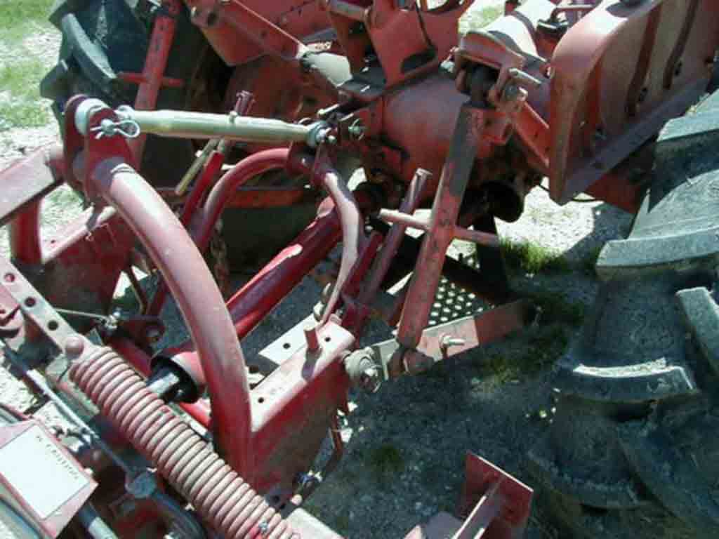

The top link on your 3pt hitch is length adjustable. Changing the length of the top link will make a difference in how the cutting edge of the box blade cuts into the soil. Most of the box blades I've seen had two cutting blades, one within the box for pulling dirt and the other on the back side of the box for pushing in reverse. The angle of approach can be adjusted by "rolling" the box using the top link.
Looking at your tractor from the rear, there is a vertical link on the right lift arm that is adjustable also. Changes in the length of this link will allow adjustment of the angle of the implement, from level with the ground, or lower the right side to the desired angle to create your "swale" or ditch. I have seen tractors with adjustable links on each side. See the attached photo.
Top & Tilt refers to replacing the manually adjusted top and side links with hydraulic powered links enabling you to make adjustments without leaving the tractor seat.
