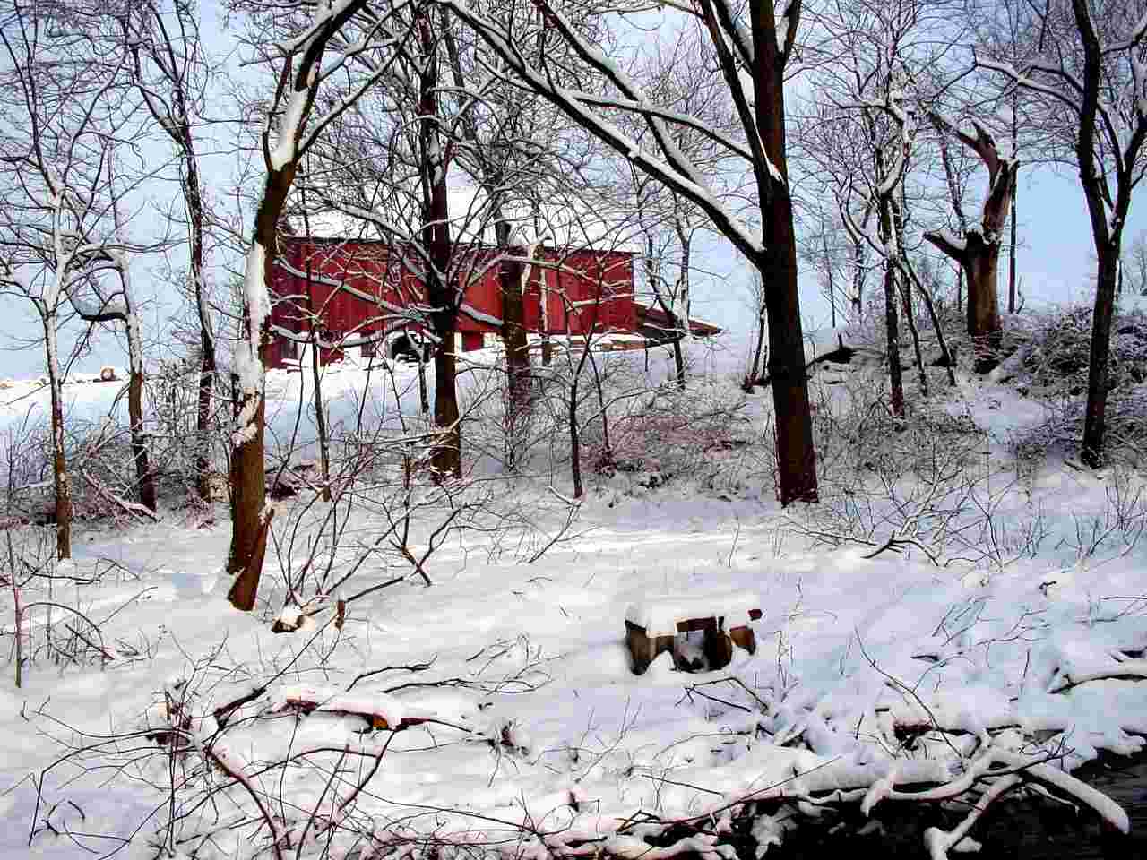

Here's my crossing.. on the far side.. I graded the ramp to a lesser angle.. still need more stone to cover over it to prevent washout. On the near side.. I had the same problem as you.. very mushy.. I ordered a 20 ton load of 3-4 inch rock.. and spread on the path going into the creek.. def. makes for a very bumpy ride.. but provided a good rock base. I then bought a load of "crushed run" to go over the big rocks.. and packs down nicely.
The creek at this crossing point is about 2 ft.. after very heavy rains it's like a flash flood.. I just don't go across it then.

   / Creek Crossing for Tractor #22
Though I don't have a picture of the nearside road.. (it would be to the left of this picture).. you can get a feeling of the steepness going down to the creek crossing.
