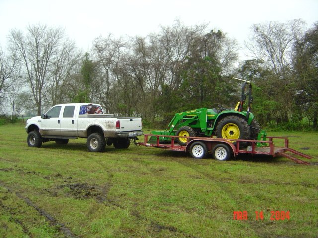

Hey Mitch, I drove a 4710 today. Do you think it would be good for bush hogging with a 6' cutter my 15 acres of lush pasture.
I would also need a loader to move dirt forever to improve drainage.
Thanks,
   / Creek crossing pictures? #38
Here's mine.....................chim
   / Creek crossing pictures? #39
That's exactly what I use mine for. I have the LX6 and 460 FEL. I actually started my tractor shopping with a 790, it's a nice little tractor but was told by way too many people that it was too small for 30 acres!
I don't regret getting the 4710, it's done everything that I've asked from it. Just got the 50 hours service done on it this week!
Good Luck!
