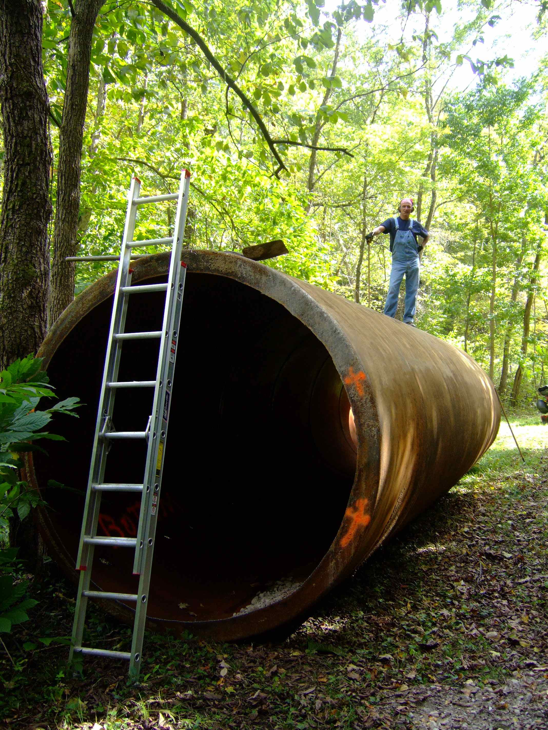

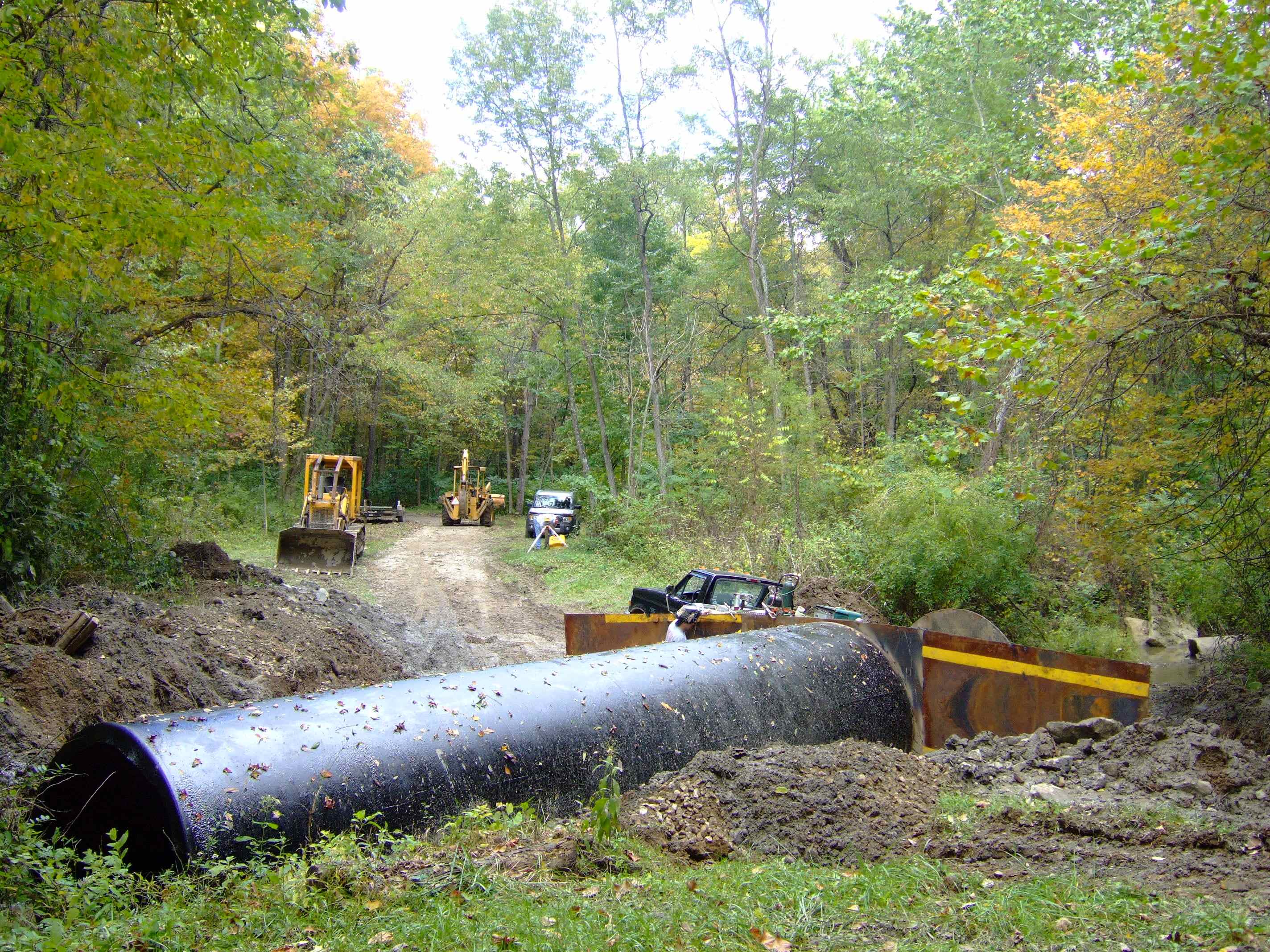

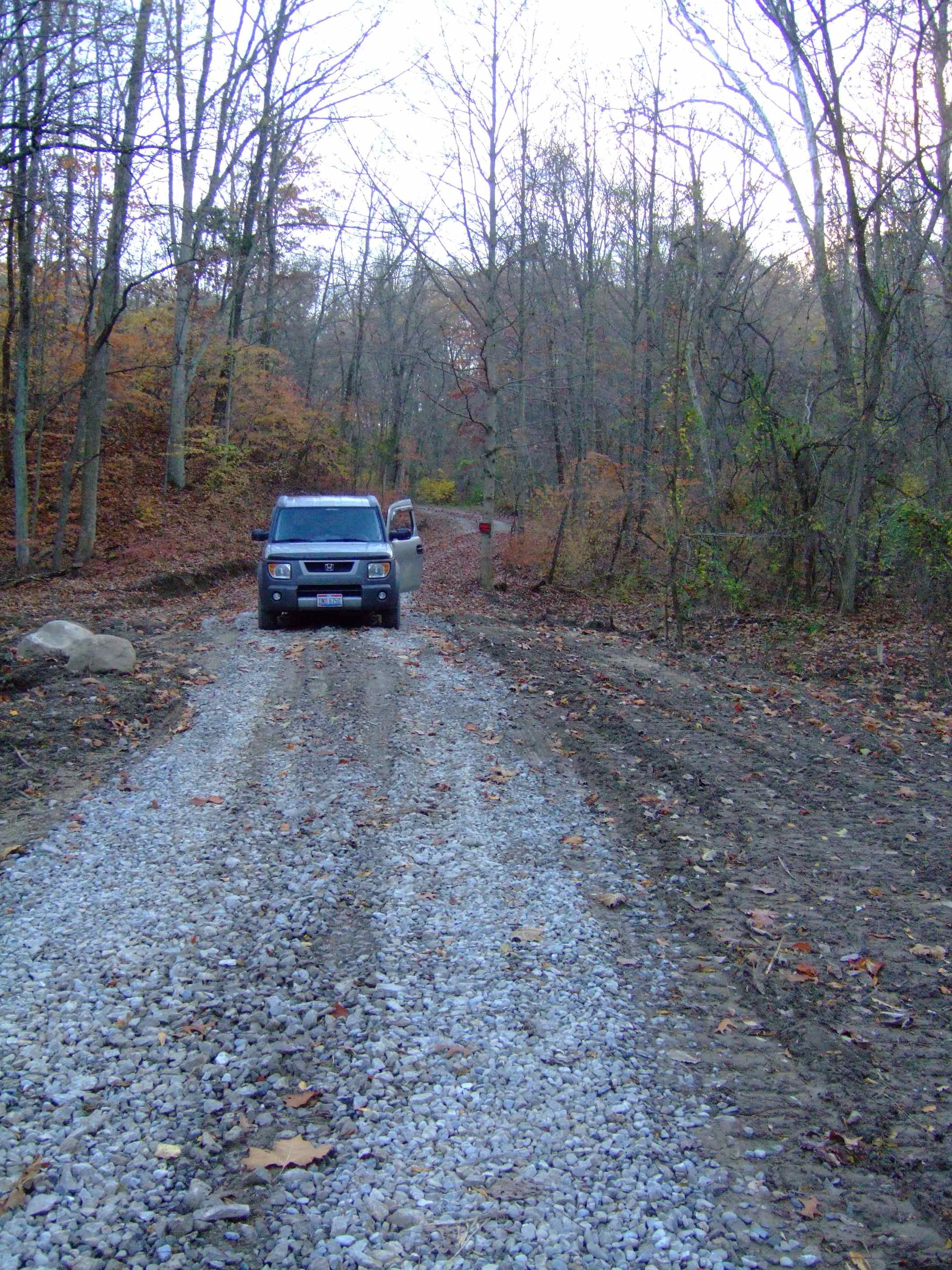

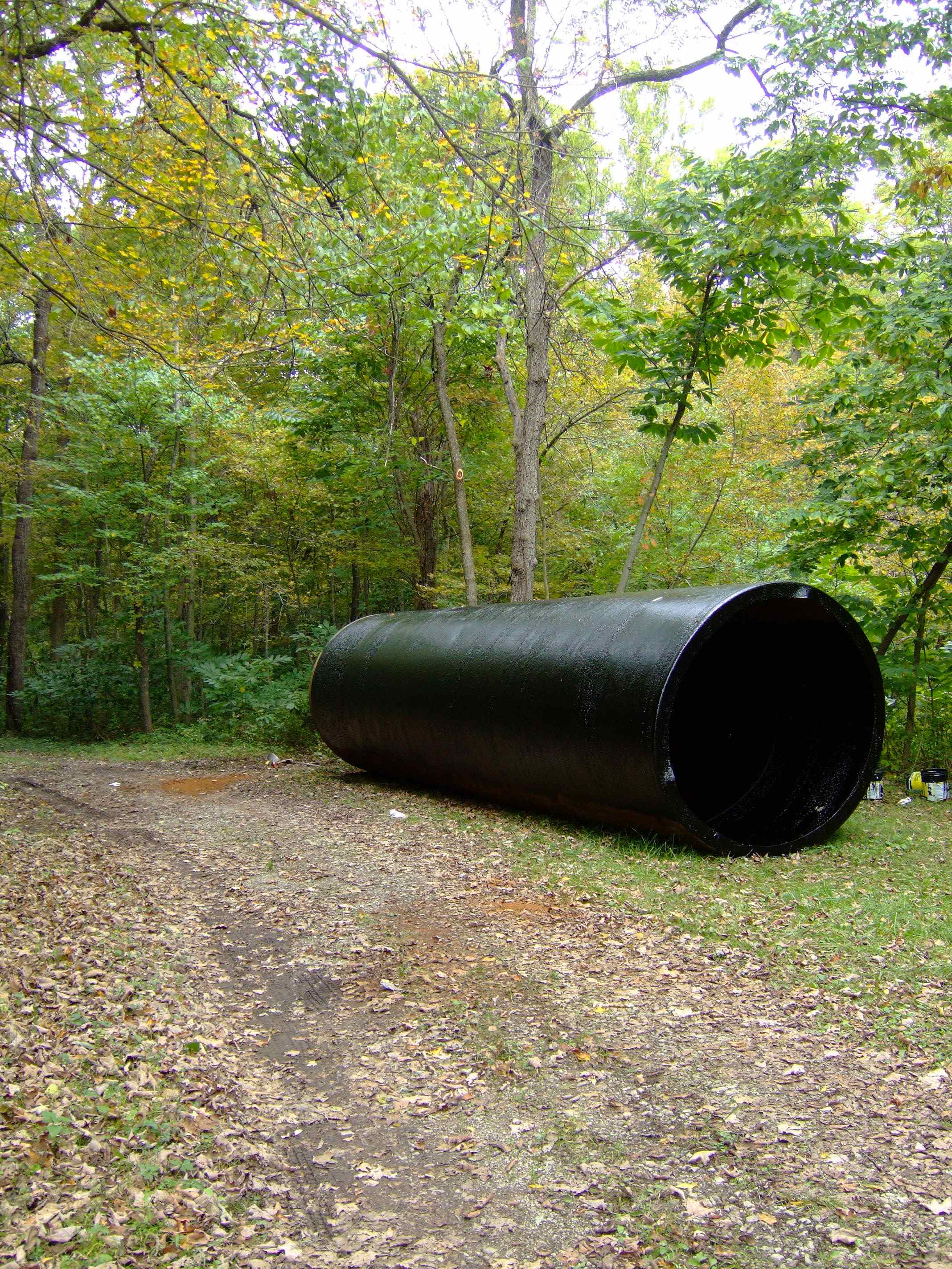

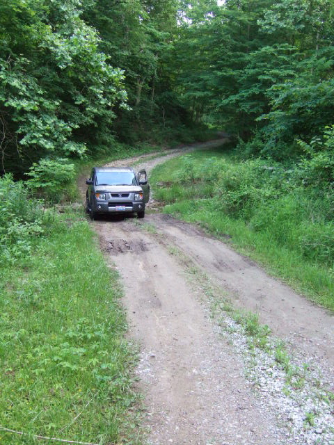

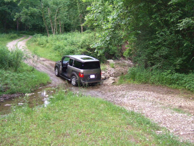

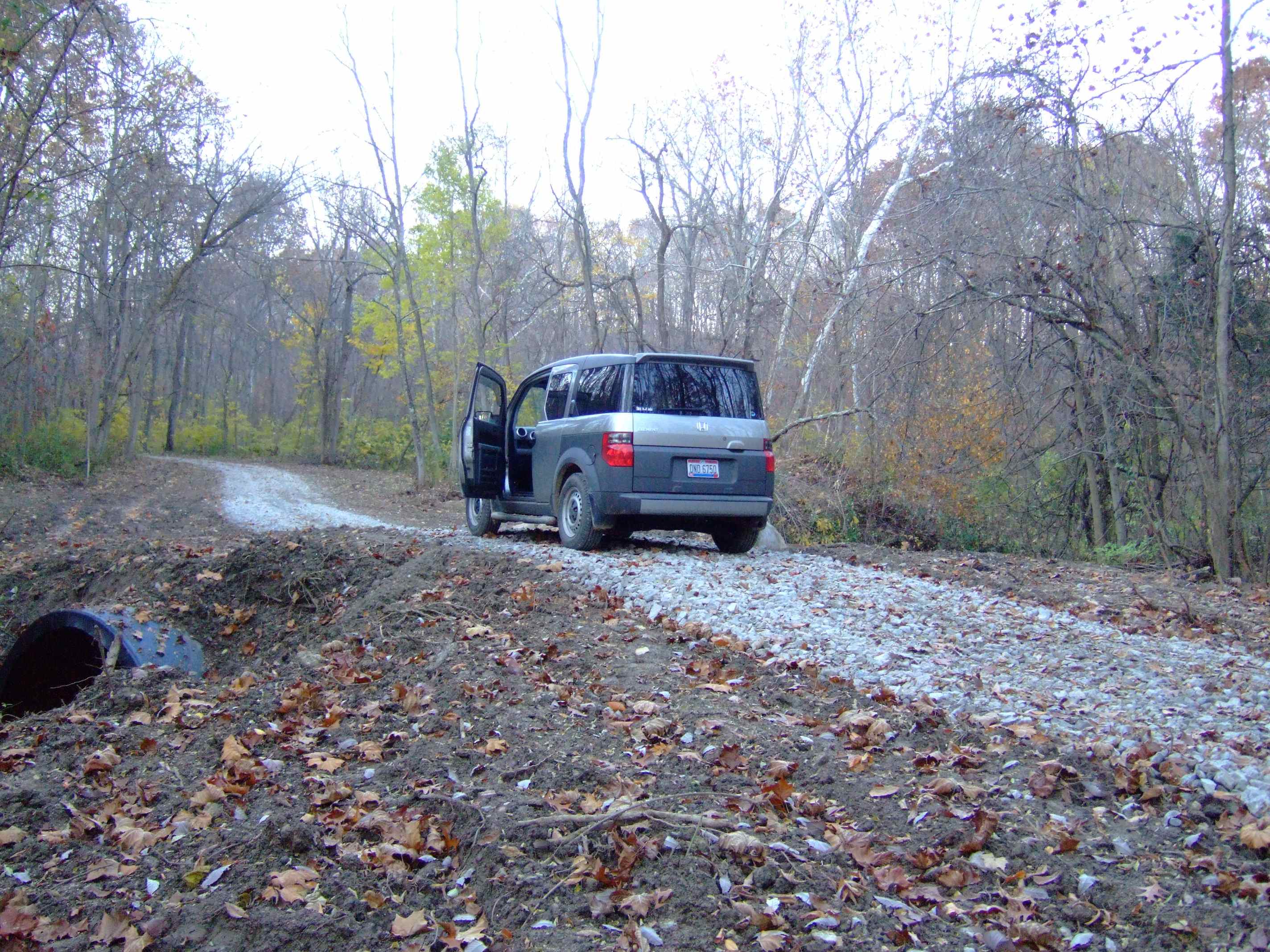

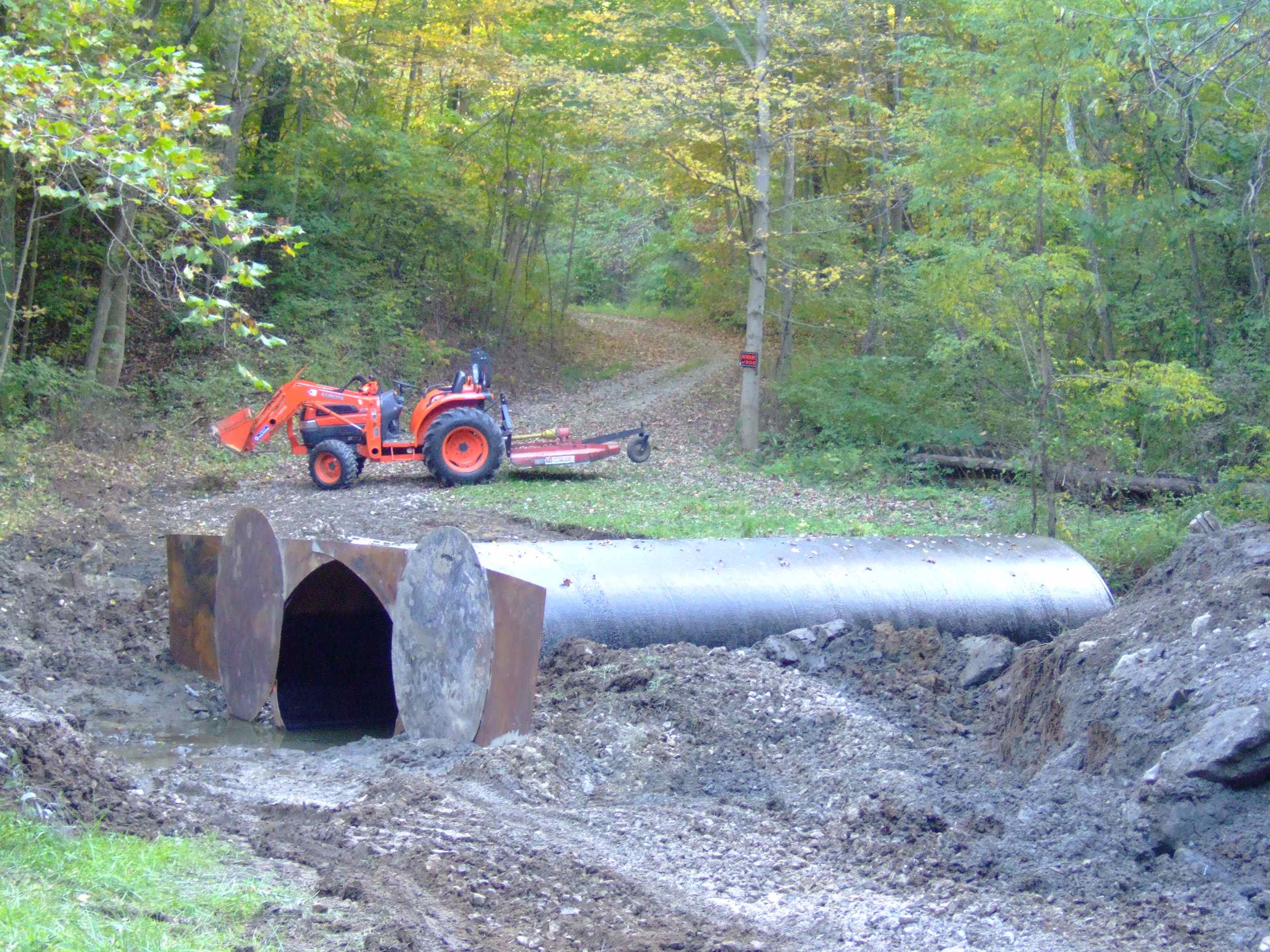

Here's mine... before, during, and after installation. It is an 8 foot reclaimed steel fuel tank with the ends cut out and used as retainer "wings" on downstream side.
Anyone have any thoughts on how to do a guardrail? I just need one to give people something to aim for, not to actually hold vehicles back. Maybe something with a handrail to keep kids away from edge.
