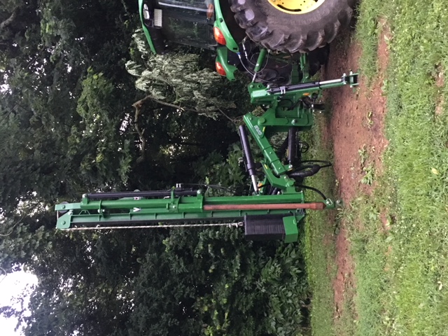

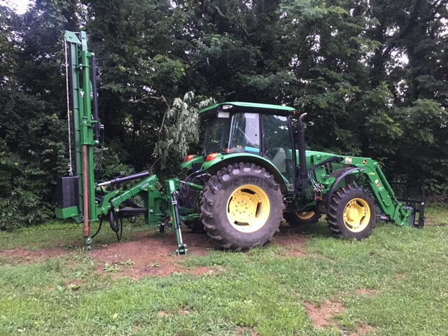

The problem I've run into... is the quality of the posts I am trying to drive. I began WAY BACK IN THE BACK of my property, thinking I'd make my learning curve mistakes where they wouldn't show too badly. And am I glad I did. I purchased (through a local and well respected vendor) 1200 posts and 5000 poplar planks. (The good thing is, I've only taken possession of 1 small load of posts (7 bundles I think). But THESE POSTS SUCK!
Out of the 50 in a bundle, at least 1/2 of them are crooked to the point that my driver, even with checking for level 3-4 times per post and adjusting accordingly, cannot put them in straight. When I remove the driver, the post 'SPRINGS' into whatever direction its natural inclination deems. I try to compensate, but I'm frustrated.
My wife and I put in about 100 posts over the weekend, and at the end, I looked at it, and am unhappy with about 25 or so. I realize that I can't use inferior materials and expect superior results. So, I need to find straight posts!
What do you look for when you are purchasing posts... (sight unseen)? And actually, strapped in a bundle... I couldn't have tole how crooked these posts were to begin with even if I would have picked each bundle myself.

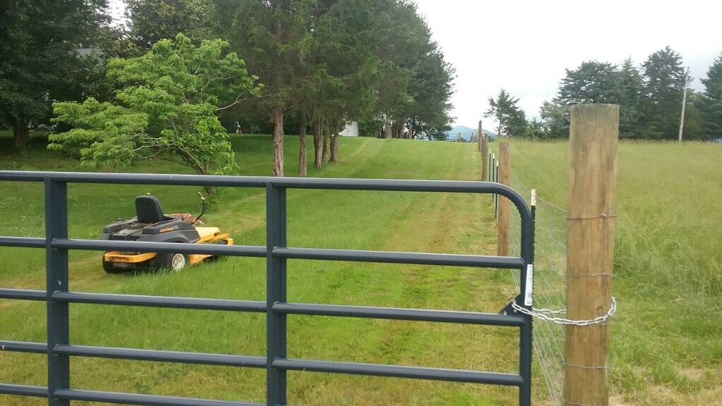

I know you said "I won't even begin discussing cost and alternatives", but curious what the fence purpose is? This shows part of fence I recently put up, drilling post holes then steel posts every 10 ft. and woven wire. It's for horses.
In distance second picture is a small part of neighbors white painted board fence that's been up a couple years.
A white painted board fence is beautiful, and we had one all around our home place when I was a kid, but as you know super high maintenance...neighbors fence already has some warped/twisted boards need replacing, soon will need repainting.
Some farms around here they use treated with white plastic wrap so no painting.
Growing up our neighbor had over 1000 acres with split rail fence which I see a lot in Kentucky. 20180529_173409.jpeg20180529_174049.jpeg
