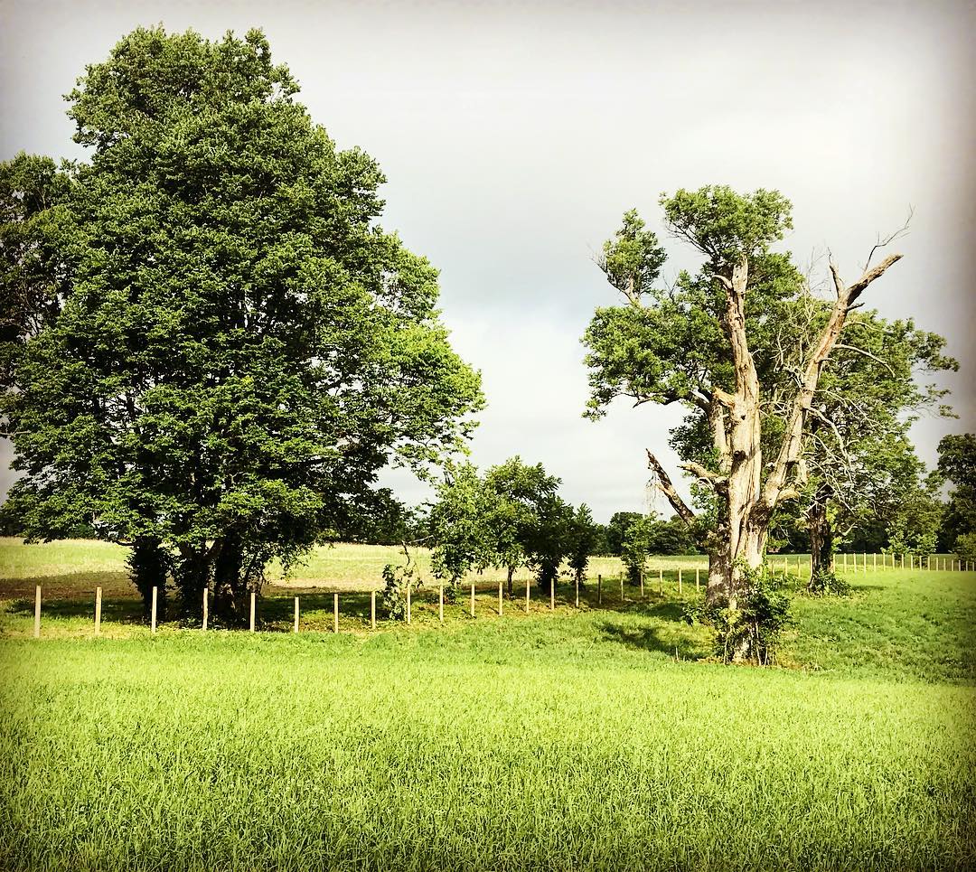

Its not that I am putting them in crooked. It is that THEY BEGIN crooked. And I can't drive a crooked post into a straight post.
I haven't been hitting rock. I only have rock in one place, and I am well away from it at this location. I have a rock spike and a Danuser EP20 with rock auger should I need it.
