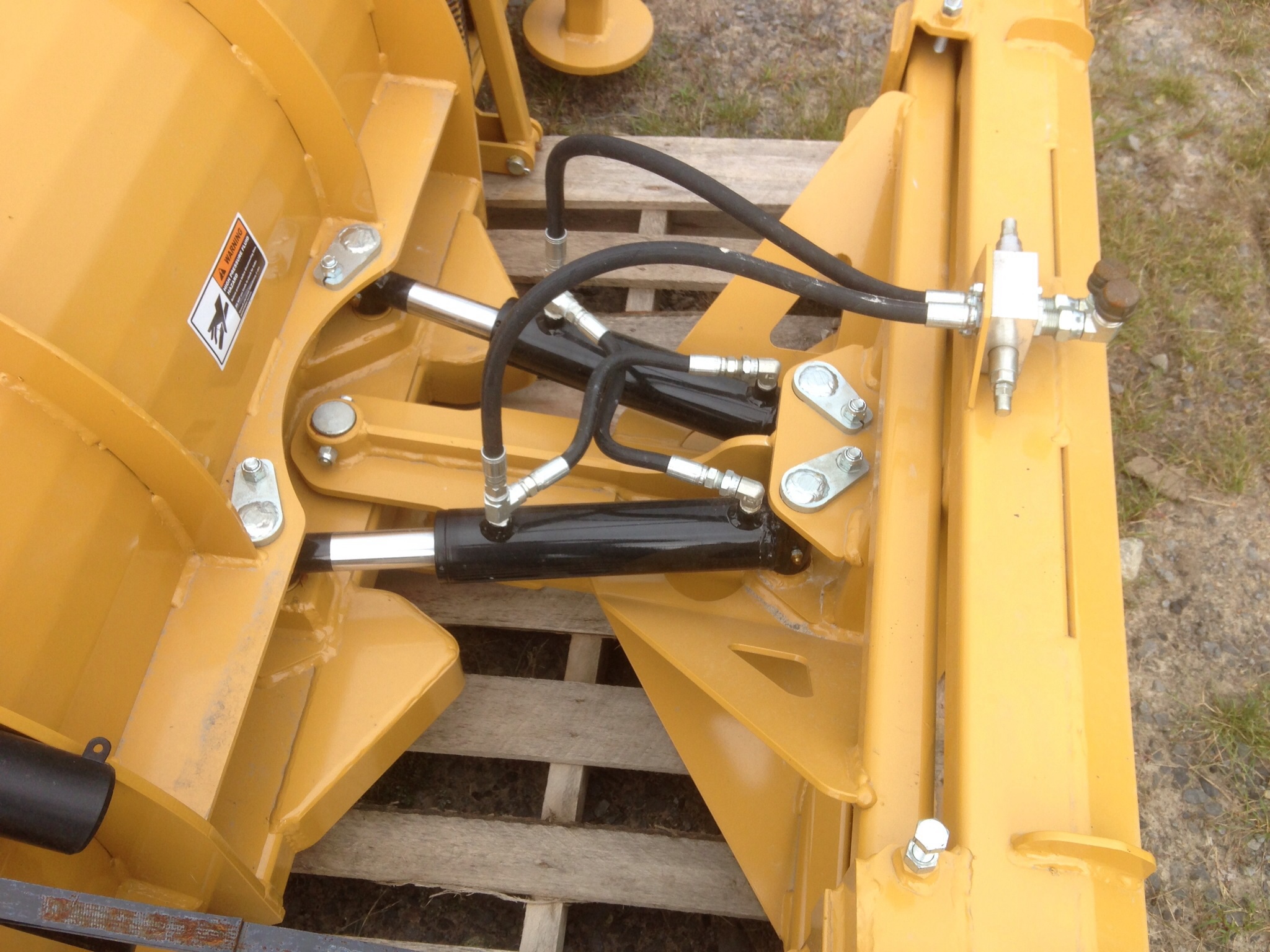

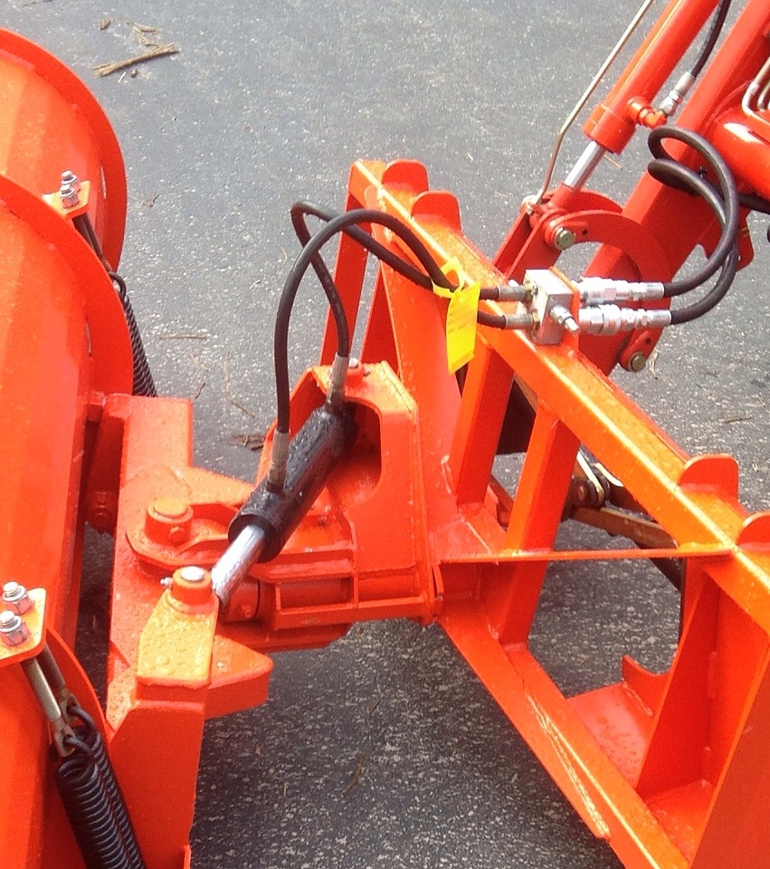

I think I need to put a cross over relief on my FEL mounted snow plow.Anyone have a parts number and pipeing diagram.It is an old Curtis truck plow ,fairly new cylinders&hoses.

   / cross over relief for snow plow
I have two cylinders,one line to each cylinder.So single action?Again how to hook up.Thanks.
   / cross over relief for snow plow #6
Both cylinders are single action. The crossover valve protects the extended cylinder by dumping over to the retracted cyl side.
That system only protects the extended plow corner from collisions with stationary objects like curbs etc., but then when plowing your curb side is always retracted as you push snow to the curb.
They only work with dual single action cylinders.
Install is simple: 2 inlets and 2 outlets and generally 2 adjustments for pressure 'dump over'
The only time they worked for me was when I tried to break frozen snow banks with my extended plow tip, otherwise in 10 yrs of contract plowing they never acted.

   / cross over relief for snow plow #9
Bailey hydraulics sells a crossover relief valve we install on plows that lack them. Crossover relief valves are effective on plows having one double acting cylinder or two single acting cylinders.
