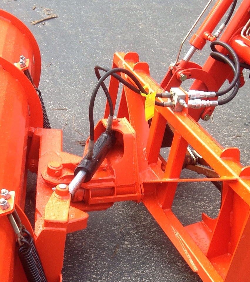

Here's a picture of my old HLA plow showing a cushion valve on an angled single cylinder. (It worked great and kept the blade closer to the tractor)

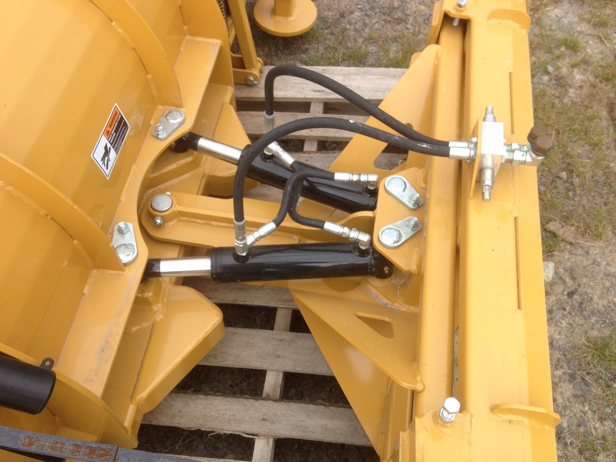

It looks like the same valve on my new plow, which is a dual cylinder. (second photo)

ah... ok now i see whats involved. i can add something like that easily. And i do see how that would be cheap insurance for my expensive plow and loader.

Come to think of it, my backhoe has a cushion valve similar to that second plow with 2 DA cylinders. To protect the lines when you have a heavy scoop and are swinging and go to stop. Without the valve, all of that energy has to be absorbed by the lines when the valve slams closed. The cushion protects that.
Not saying it don't help, but certainly works better with two cylinders as opposed to a single DA. Cause fluid volumes are equal with 2 cylinders.
