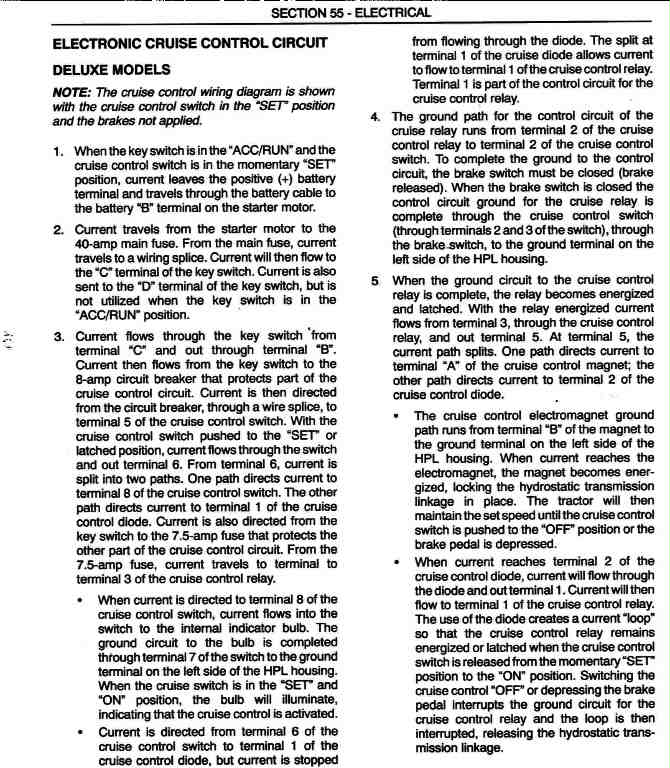

Cruise control circuit description.

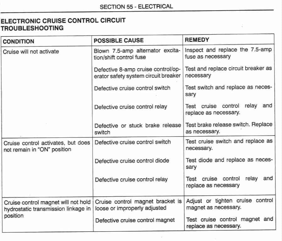

Cruise control circuit troubleshooting.

The cruise on my 40d will not work either. I wonder if this is a common problem?
The light comes on when I push the switch and then truns off as soon as I let go.

The cruise on my new TC33DA did not work when delivered.
The indicator light would go on, but it never held speed
even when holding the switch down.
It turned out to be a defective switch.
