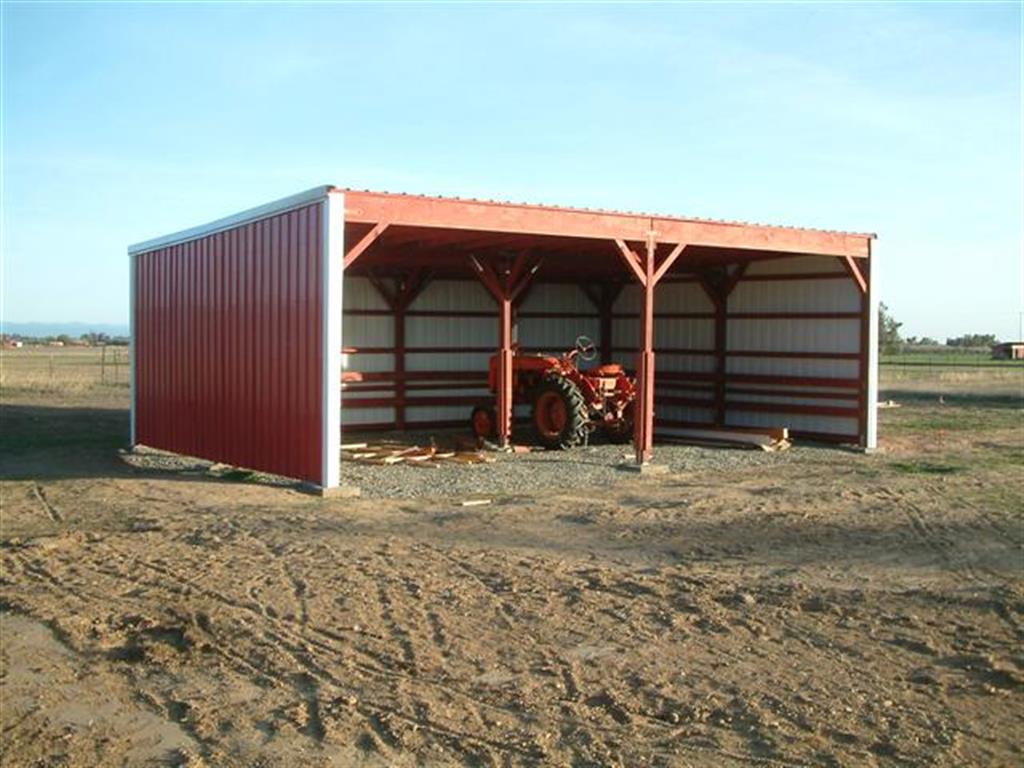

Looking for advice for putting crusher run under my 30x60 pole barn I use for equipment storage. Right now I only have about 4" clearance on my ROPS right now so I need to remove dirt first. For this particular application can I simply remove 6" of soil then add back 4" of crusher run?
No reason why not. Here's my 20 x 28 ft equipment shed with a gravel floor. Works fine. Low maintenance.
Good luck
