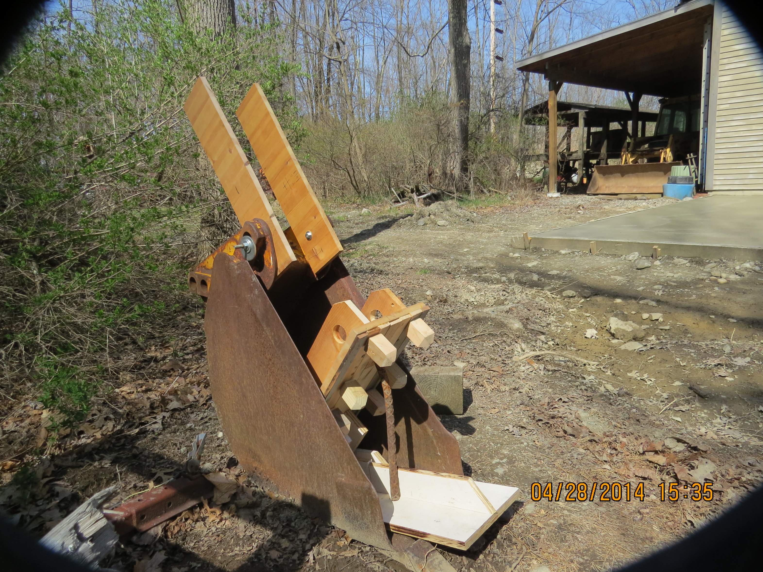

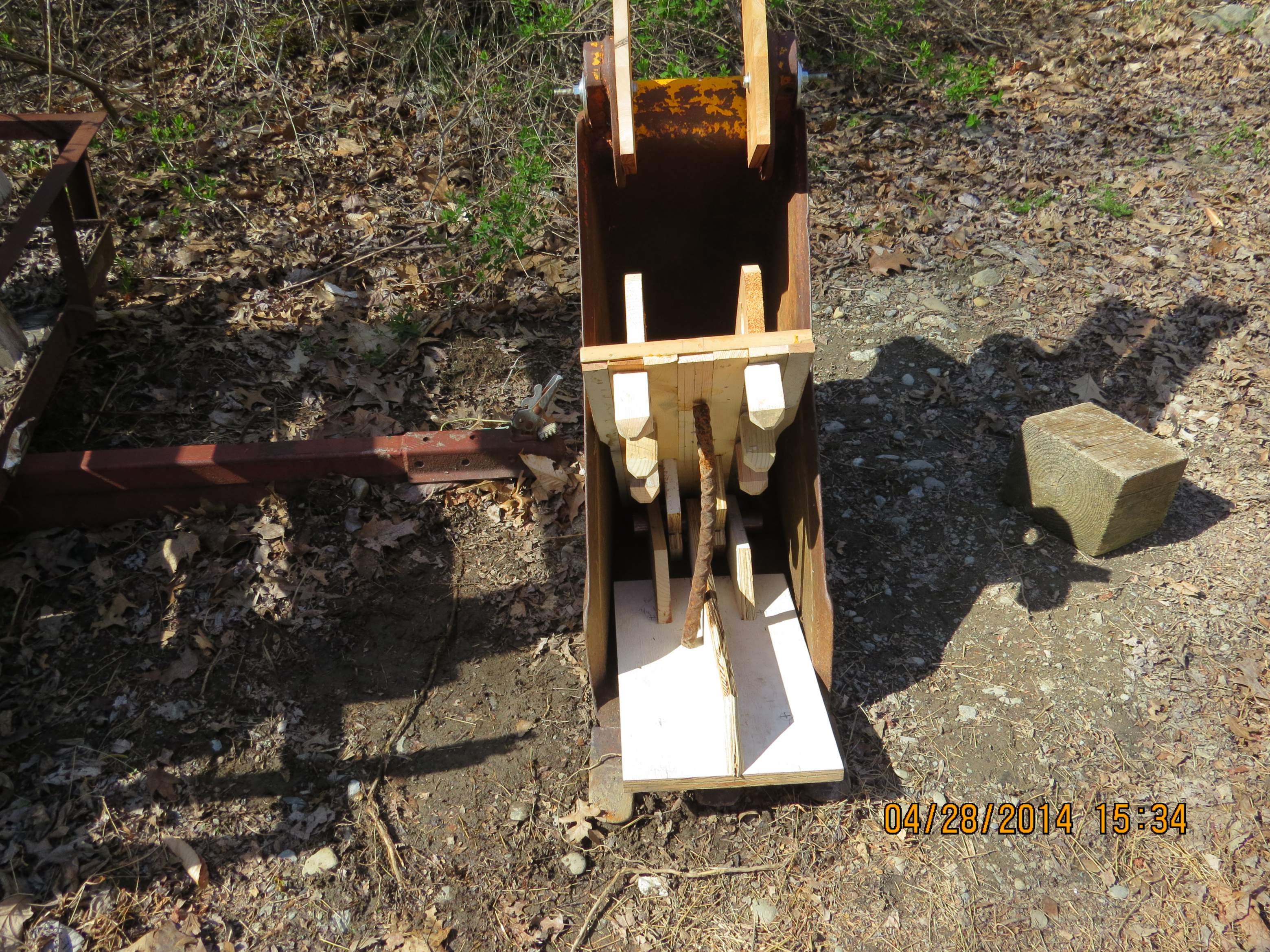

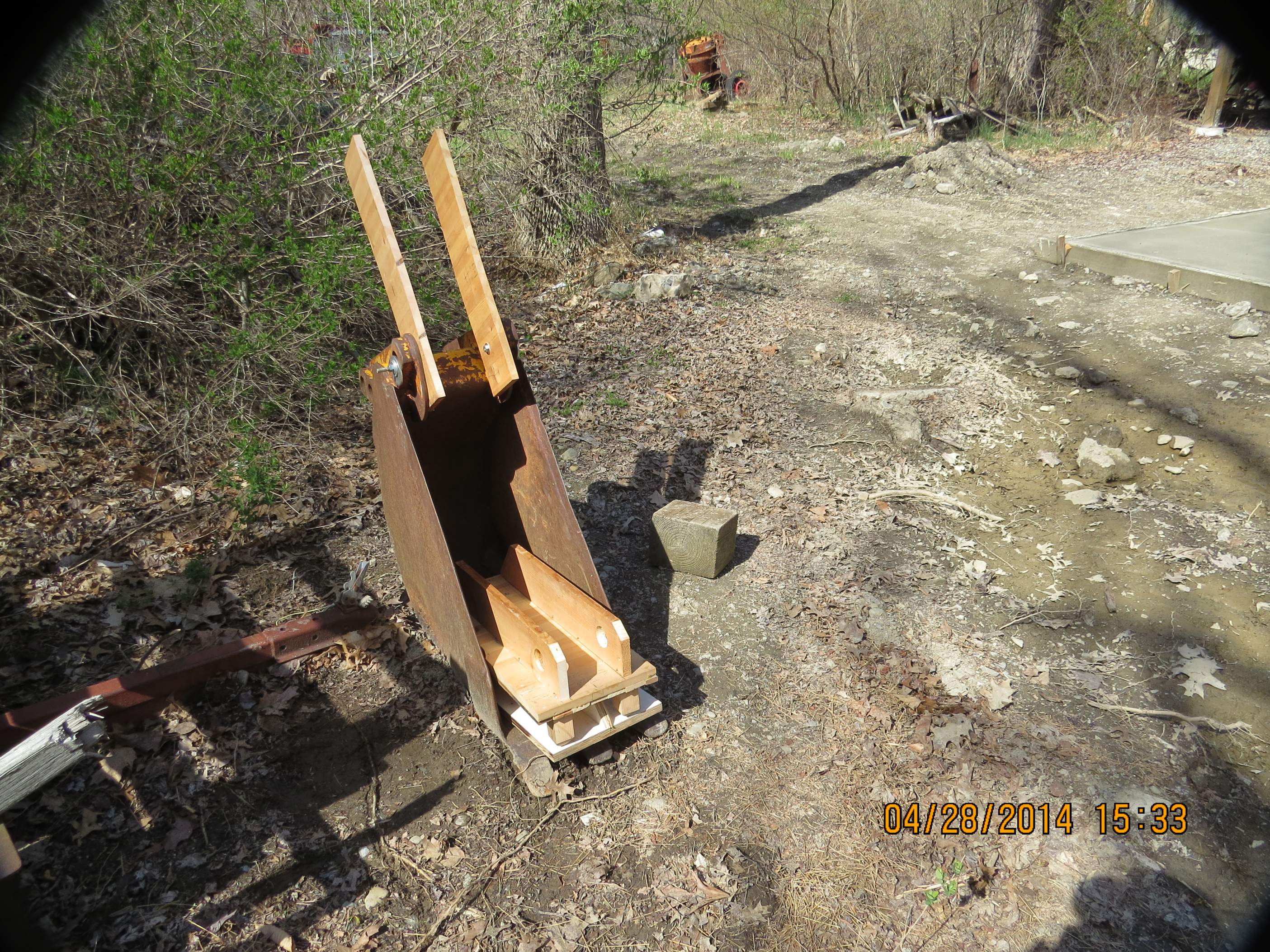

Just ordered the steel . not too bad about $1.00 a pound. $130 I always get a little extra for next time.
3/4 x 10 x17 for the base plate
1 x 9 x 24 for the crusher plate
3/4 x 4 for crusher plate ribs got 1 have 2 so little extra
3/4 x 3 for base rib actually is the breaker bar got 1 have 1 so little extra
Every thing else I have . The hardest part of this fab is beveling the edges of the plates for welding. If it is less than 7 inches I can get it vertically in my saw. Longer than that I mill it in a bridgeport. At least I have a power feed on the table. Looks to me like 10-12 feet of milling . This is going to be a couple of months.

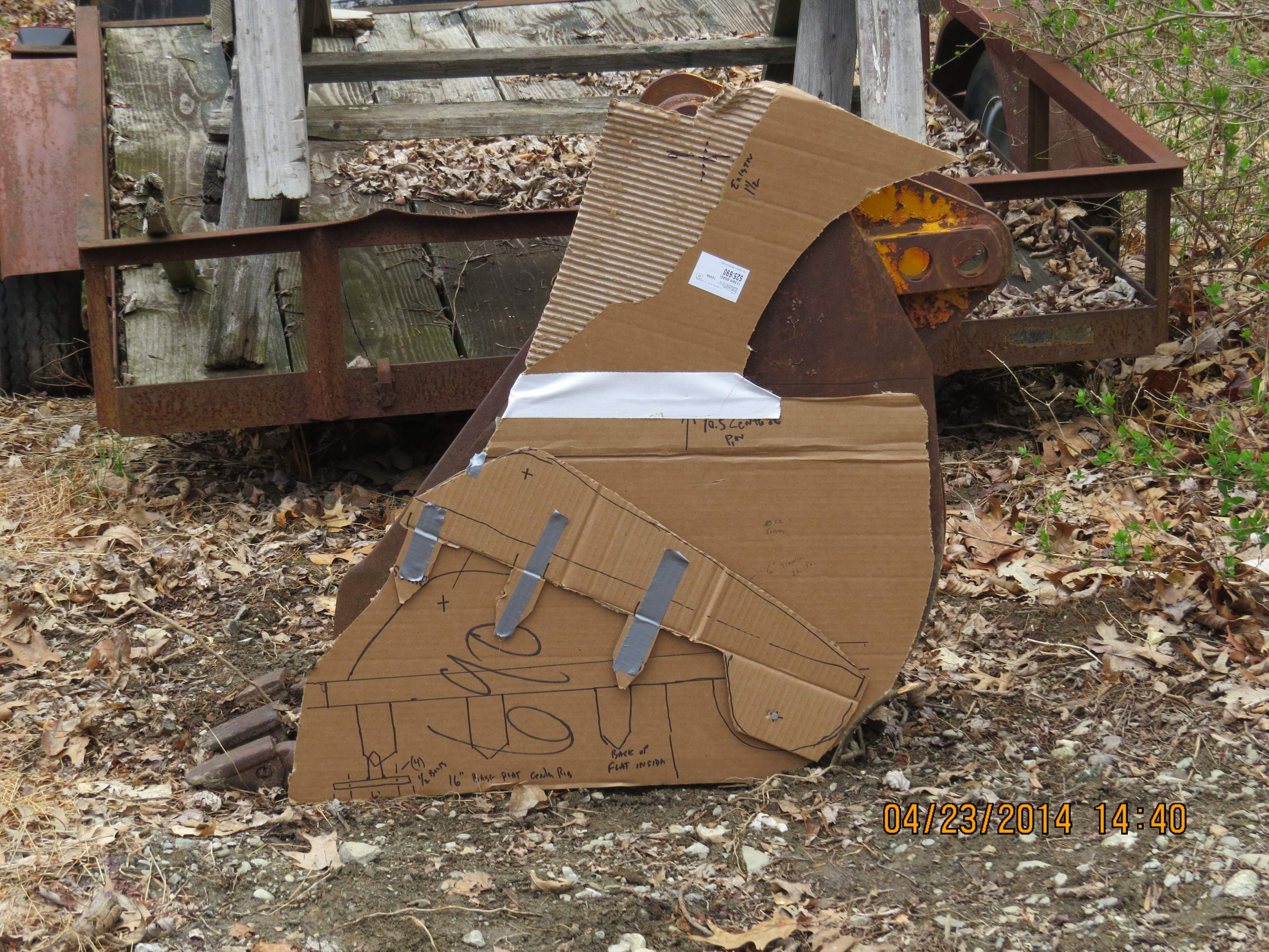

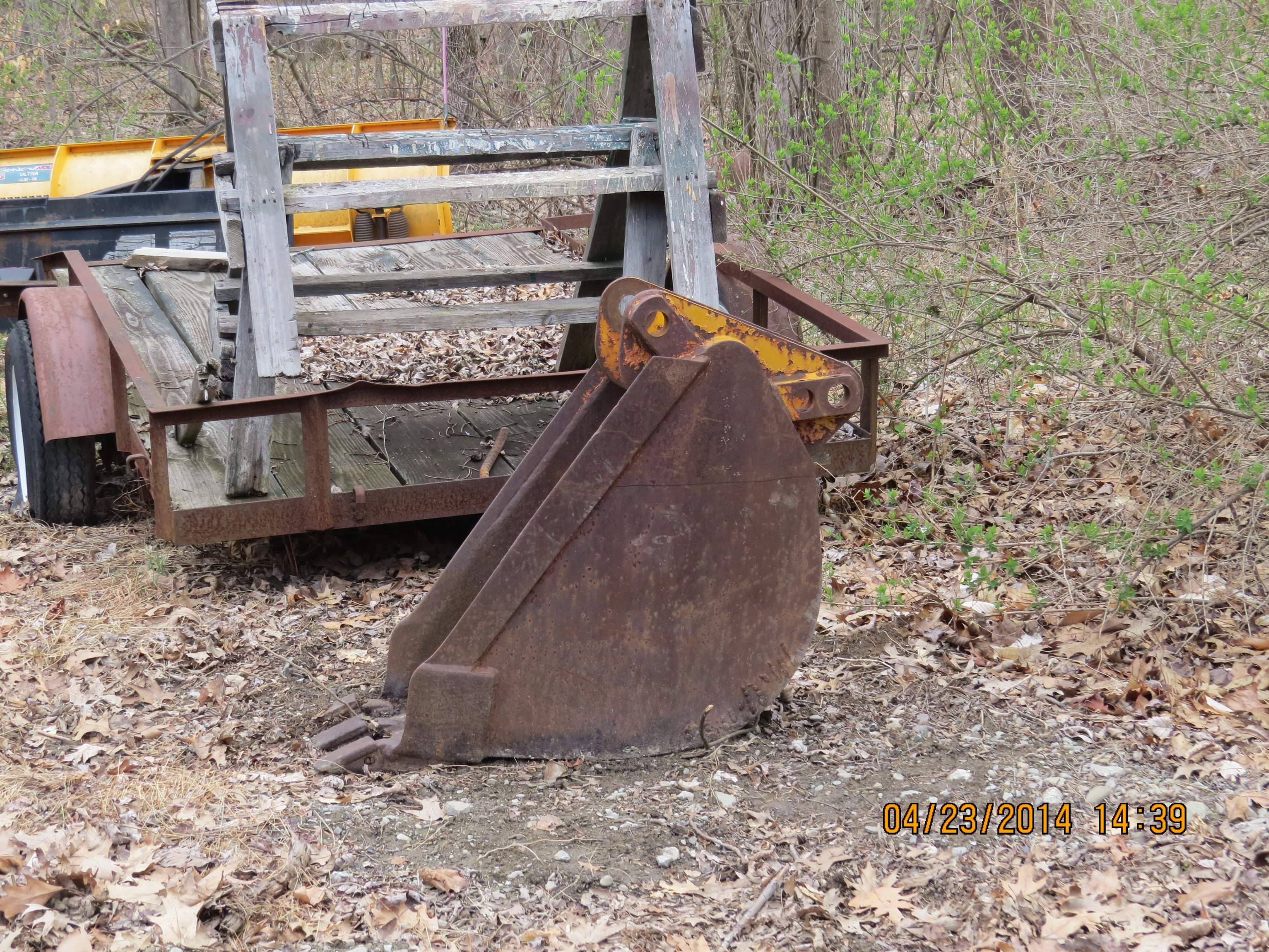

I hesitate to post because I have be told I am wasting my time. I guess it's my time and I like to build things SO In metal it looks like the wood model. Getting really heavy , I have to add a few more lifting points for the chain hoist. I think I have take it out and put it in a couple more times plus the crusher jaws are not welded in yet. Please be gentle with comments about my crappy welding. I did not want to alter the bucket too much ( 4 1/2" holes ) so the worst thing about this is the hinge pin has to be in before sliding the assembly into the bucket. Heavy.
I was a little concerned about the FEL lifting the whole thing but it is fine. I can't finish the cylinder anchor till it the whole thing is bolted into the bucket. Got to take 4 days off and go to IN. Grandchildren. Next week should see it in the bucket. IMG_0911.JPGIMG_0912.JPG
