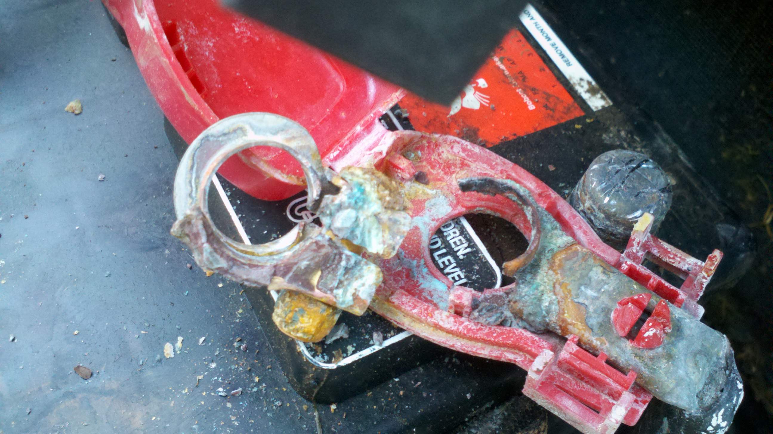

well, you guys saved me $300. Thank you!!!! I got home from work and went to hook up the battery to do some more tests, and the positive cable crumbled in my hand!!! I can't believe that such a thing could happen after such a short time, but the clamps are made out of sheetmetal or some other crappy thin material. I'm surprised I didn't notice it the other evening when I took the battery out. I'll be taking the cable back to Bobcat for warranty but I'm not sure I even want to put a new one of the same quality on. I'm thinking of getting a marine cable made up, with tinned wire and high quality ends.
Here is what I'm working with, for those who like pics:

yep, that is what I was talking about. Greenish/whitesh "mung" what ever you get to replace it with. get some of this and coat everything metal on the cable clamp, battery post, and push it into the strands of wire in the cable if possible, and cover any exposed metal part of the cable with a good coating of this stuff, and your problems will never return..

Thanks everyone for your help!!! I went to Bobcat today and they wanted $50 for a new positive cable and in order for it to be covered under warranty they needed me to haul my tractor an hour away to them. Instead, I went to the auto parts store and bought a positive cable for $9 and some loom to protect it. I'm happy to say that the tractor started right up!!!
I'm going to order some of that corrosion protectant that k0ua recommended but I think that the lead end will be much sturdier than the cheapo potmetal end that bobcat originally provided!

I've used NOCO corrosion spray and those felt pads soaked in the stuff for over 30 years when I learned of it from working in a garage. I've never had cable clamps corrode. Here's a site and amazon sells the stuff to if you buy there. Just something known to work and probably similar to what K0ua mentioned. NCP-2 Battery Corrosoion Preventative - All Battery Sales and Service

In the good ole days mechanics would dab Vaseline on the battery terminals and I see no reason as to why buy $10. modern upgrades when a time proven product suffices.
As I understand the cause it is acid fumes or vapors that cause the corrosion and the product application shields the terminals by providing a vapor shield.
Shucks in a pinch I dab grease that I find around a nearby zerk. O.K. my finger gets dirty but my terminals are not corroded.
Also when servicing a battery or the cables be sure to clean the posts back to shiny lead to assure the best of contacts as lead forms an oxide (kinda black finish).
While special terminal brushes are available, fine steel wool will do a great job as well.
