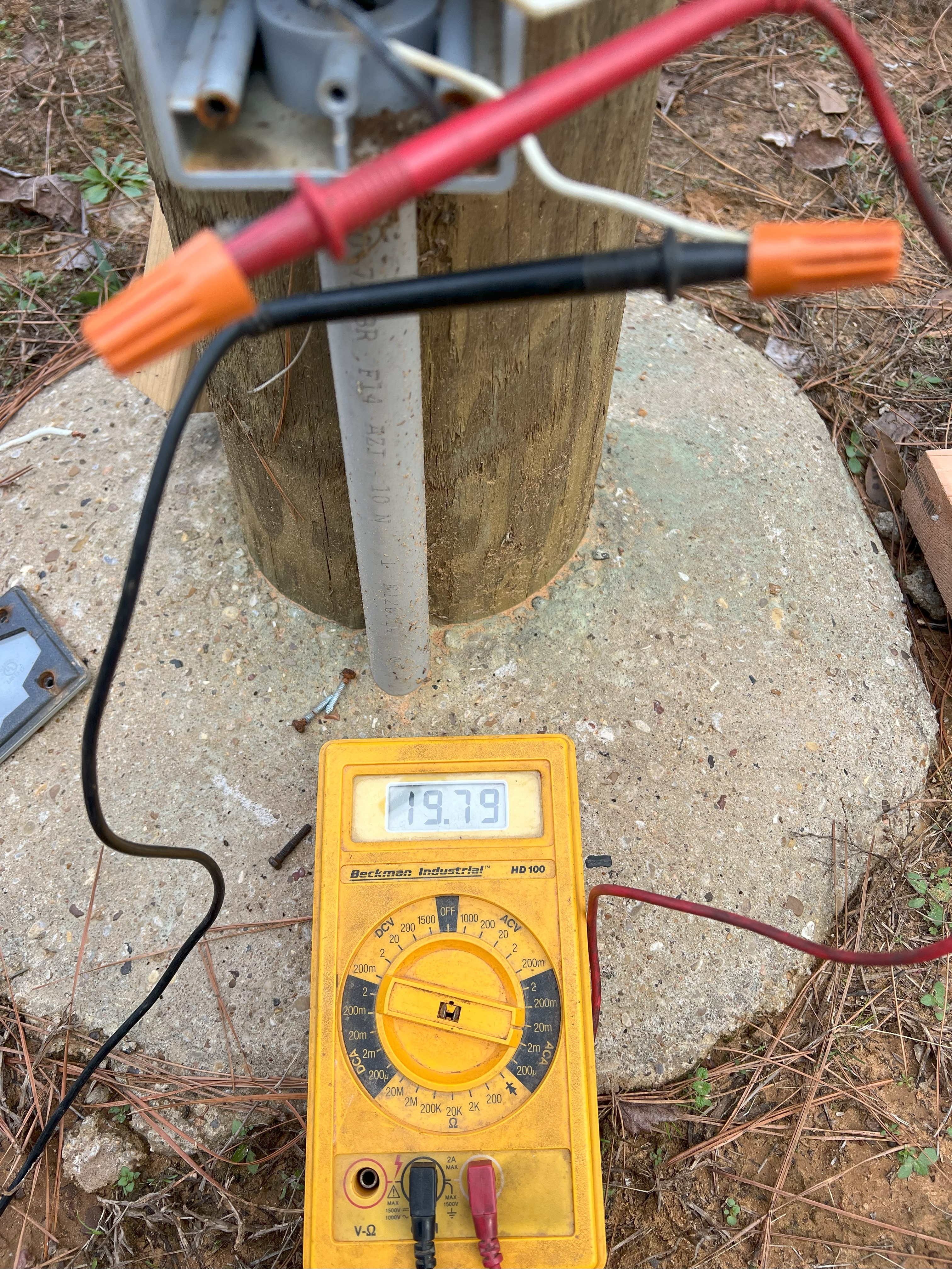

I'm thinking about the wire being damaged, I'm remembering that my wife dug up the area where the line was to save some of her plants from the dogs. After installing the line, we decided that we needed another dog run, so I fenced in an area of the yard that went through her shade garden. Once the dogs where in there, the plants started to die, and she is borde line psychotic about her plants, so she dug them up to save them. We're pretty sure that she damaged the wire. That narrows down where I need to look for the damage, and where I'll start digging when things warm up again.
What I didn't know, and I still don't understand, is how a damaged wire can reduce the voltage in half? I thought that if it's broke, it's not working. If it's exposed to the soil, it's shorting out and tripping the breaker.
follow the steps i mentioned above. although likely, you haven't yet proven the wire is bad. the other testing will take less then 10 minutes. i strongly recommend you follow it

I dug the trench for the wire from my house to the first fence post with my trencher. Depth is around a foot. That' run is about 100 feet. I have a junction box at that fence post. From there I ran the line to the light post that I'm dealing with. There is another line in there that will go to another light post, but I'm procrastinating as long as possible on getting that done. And there is another line that will go to the vegetable garden so I can install an outlet to control sprinklers one of these days. It's all grey direct buried 12/2 on a 20-amp breaker.
From that post to the tall light post, the wire is probably six inches deep. It's around 150 feet in distance. I dug that with a shovel, by hand, over a period of several weeks, a few years after the first line was installed.
My plans evolved over time, and that run to the light post is because I made a huge error and said what I was thinking out loud. And my wife heard me!!! Once I give her an idea that she likes, she becomes obsessed with me getting it done. If I had never said anything, I wouldn't be dealing with this stupid light!!!
Funny thing, the shallow run is fine, the deeper line is where I believe the problem exists.

All the best,
Peter
Not anymore there are numerous different wire locators for $35 to $200 as well as the $1500 to $4500 ones.
/ Electrical Mystery #49
as expected.
plan of action
go to the box on the fence post and do the exact same thing.
check voltage.
check wiring
attach bulb
bright or dim
same voltage with bulb lit?
if bulb is bright and voltage is stable at 118 etc. you have a problem with the connection or wire, from the fence to the lower section of the pole. strip the wiring back on both sides about an inch, make sure its shiny copper and use new wire terminals
if voltage/bulb is doing same thing.
then go to the breaker panel, check the breaker is fully seated, and the wiring is tight.
flip breaker on and off fully 3 times, retest.
if still dim
check voltage at the screw terminal on the breaker, with bulb lit, if still low, replace breaker,
if good, you have a issue with the wire between breaker and fence post.
This. If the problem is a bad connection somewhere, each time you open up a box and check it, if it works go to the end and check again. You may have fixed the bad connection by opening the box and taking the wire nuts off and putting them on again.
If you have multiple junction boxes between the panel and the light, start testing at the middle. If it works, test toward the end, if it doesn't test toward the panel. That cuts down on the number of tests you have to make.
I would think a bad connection somewhere is more likely than a damaged wire. A bad connection would mean higher resistance, which would lead to voltage drop. It's hard to imagine a damaged wire leading to higher resistance. I guess if the neutral is severed and touching the ground to complete the circuit that way you may see lower voltage.

If I had to guess, I would think its a bad connection somewhere or a bad circuit breaker.
My experience with direct burial wire is the outer jacket material is pretty tough. If all your wife was using to dig was a shovel, I'd find it less likely that the wire was damaged under ground. Maybe if the wire was against a rock while the shovel was being scraped across it many times, but that jacket is tough. I always have difficulty stripping that jacket off to get to the wires for my connections.
Do you have a lot of sharp rocks in your ground?
I'm leaning towards the wire not being the issue.

The only connection that I haven't checked is the breaker. Today it started out at 22 degrees outside and the high should be 36 degrees. Then it's going to get worse this week, and maybe even worse next week, so I'm not messing with anything out there for a while. I've bypassed what I think is the bad section of wire, where my wife dug up her plants, with a couple extension cords. The light is working perfectly!!!!

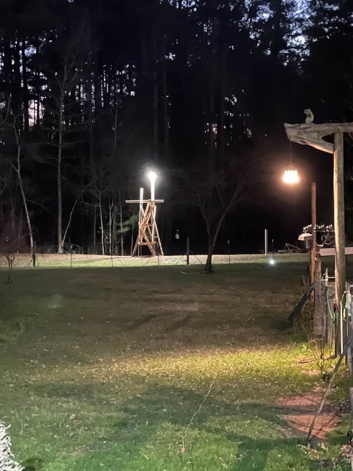

We have several solar powered LED lights. If you look at the picture of the lights on, there are some solar powered lights along the bottom of the fence. They are OK, but nothing great. In my experience, they last a year or two, and then you throw them away. I've replaced batteries in them after a year, but two years is really about as long as they last for me.
I guess a bigger, higher quality solar panel would work. What do they cost? I'd have to mount it somewhere and run it to the light. It would need a bigger battery to last all night. What does that cost? But somehow, it just seems easier and cheaper to run 12/2 wire to the post and install a $70 light that puts out 6,000 LUMS.

Glad it's getting fixed. Underground service can fail in strange ways. When I bought my place I couldn't get a 120v air compressor to come up to pressure in the pole barn but the 240 volt swimming pool pump in the building ran fine. I checked it and only had about 80 volts on the 120 lines but 240 on the circuit. Turns out the direct burial line had a partially failed common wire. I replaced it with a new line in conduit and all is well.
