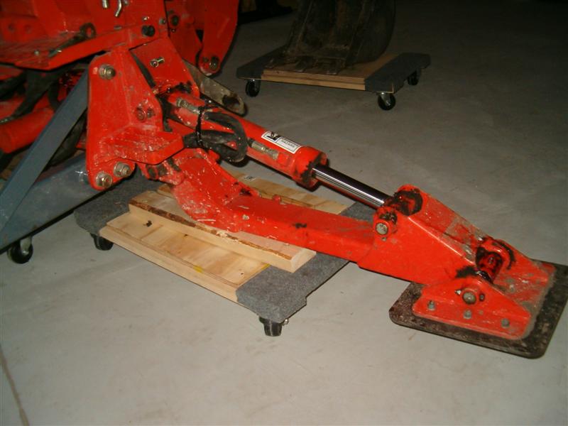

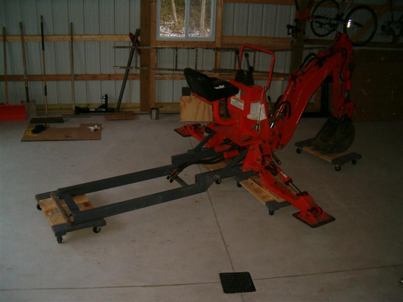

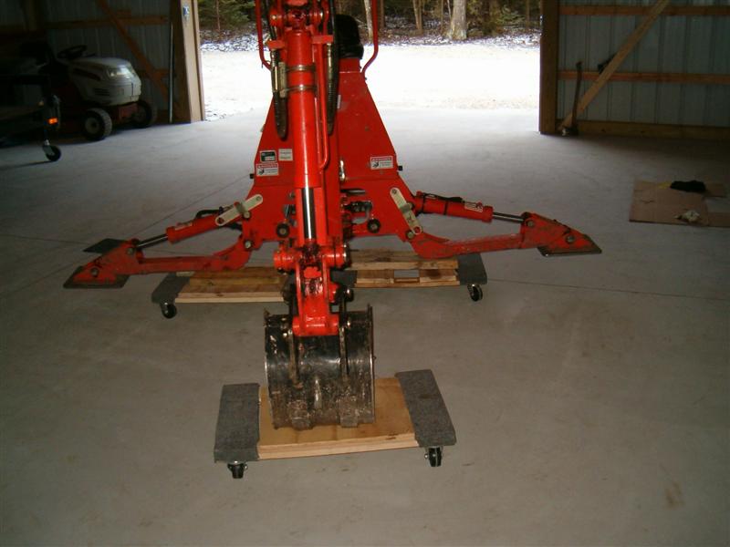

as far as lining up my Kioti Backhoe for removal or reinstall, I have a little secret so it does not take but 10 minutes. The first year I dropped it off in 10 minutes but took probably 30 trying to line the tractor up of reinstall in the Spring. Next year I got three furniture dollies (HD) at Home Depot and ran the outriggers on top of a furniture dolley and dropped the bucket on top of a third dolly. Now I can be off by a mile when I back up to reload the hoe in the Spring because I can roll that 1500-2000 lbs anywhere I want. Of course this application needs a concrete floor to work out.

You need a concrete floor and you need the bucket hydraulics to not leak down so the under mount is not sticking up in the air. If the mount lifts up you cannot get the tractor close enough to hook up the hydraulic hoses. I fixed that by getting 4 ft extension hoses- long enough to hook up the tractor hydraulics before you have to back over the under mount. Then you can hook it up single handed in 10 minutes or less.

That happened to me last year. I just took a 2 x4 or bar and got some leverage to teeter the bucket and slip some wood blocks beneath adjust the frame to level. I also ran a chain from the base of the boom to the hinge plate on the bucket and that keeps the boom and dipper from spreading. It was no big deal. It works well for me and it's nice sometimes to move that thing around in case I want to get at something behind the backhoe. The pictures were a couple of years old.
I also learned to keep the outriggers more in the up position so it does not take up as much reale state by shimming the flat part on the hinge. This operation comtinues to evolve.
