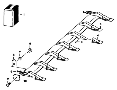

Has anyone attached a toothbar to their CT2540? I’m not sure what size to order since the FL8 standard bucket is tapered. I would appreciate any help or recommendations. I know a lot of guys like the piranha bar, but I just want the teeth since I already have the bolt-on cutting edge. Thanks!

If you haven't ordered a tooth bar yet, just call Piranha and they will instruct you in how and where to measure.
   / CT2540 Toothbar #3
Everything attachments wicked tooth bar. Made to fit based on dimensions of your bucket.
Love mine, works great.
   / CT2540 Toothbar #4
late, but FYI: Bobcat makes a tooth bar (bucket bite) for the compact tractor buckets.
Two style teeth (vertical or horizontal pin). They are sized to fit the specific bucket on your machine.
www.bobcatpartsonline.com >> By Product Type >> Attachments >> Bucket bites
It's what heavy hitch modeled their's after. It has the replaceable teeth.
It does not look like the Piranah or EA Wicked style.
It's in the same price range as the Heavy Hitch (TTWT video), but difficult to find online in the parts catalog. You can always call the dealer parts counter for assistance.
