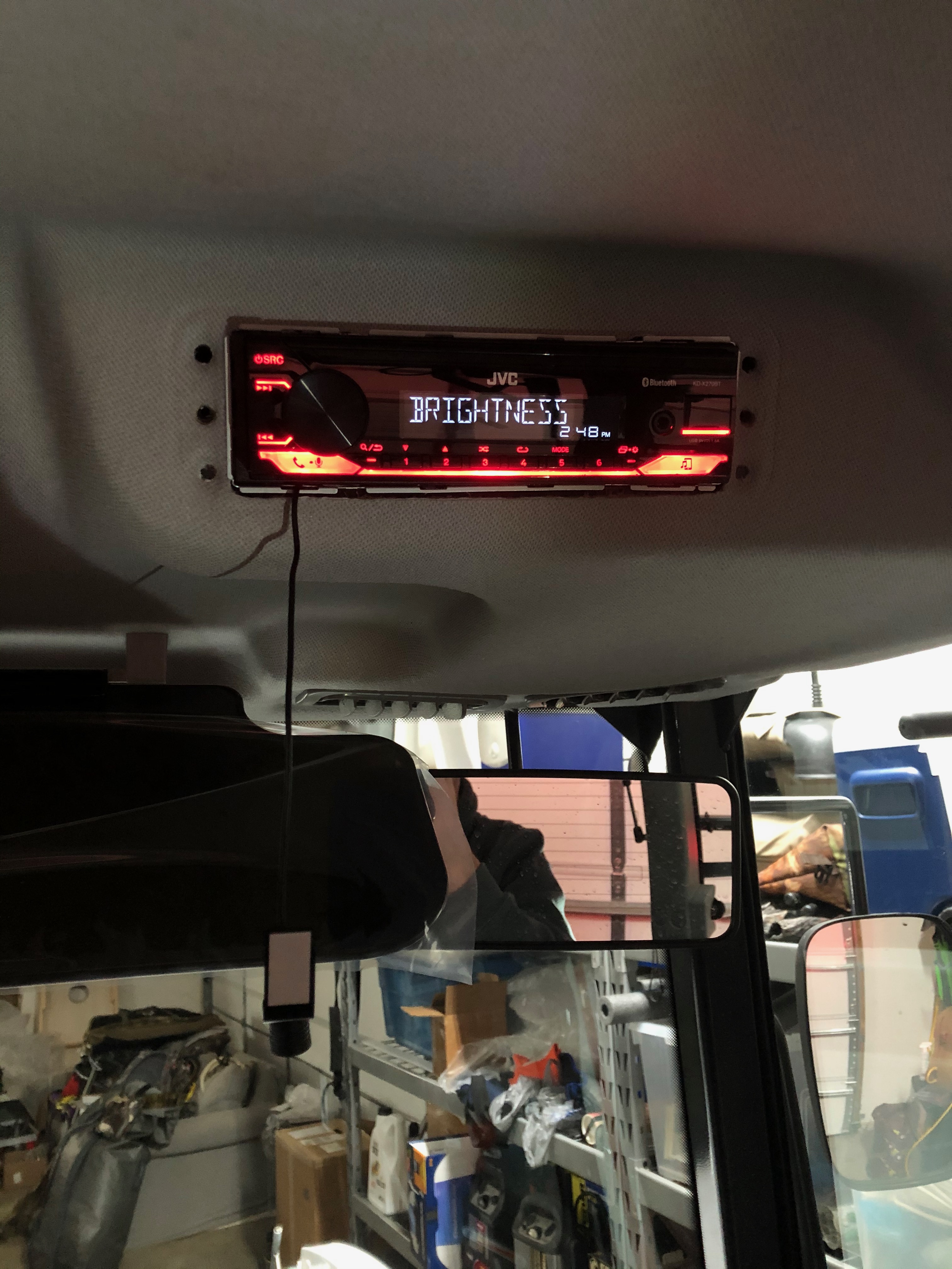

A few photos. One of the radio temporarily kind of test fit. Still need to determine if I want some type of face plate to cover the holes and how I want to run the mic and wire. Pairs nicely with my phone and the sound is decent through the factory speakers but I will likely replace those with some higher quality speakers.

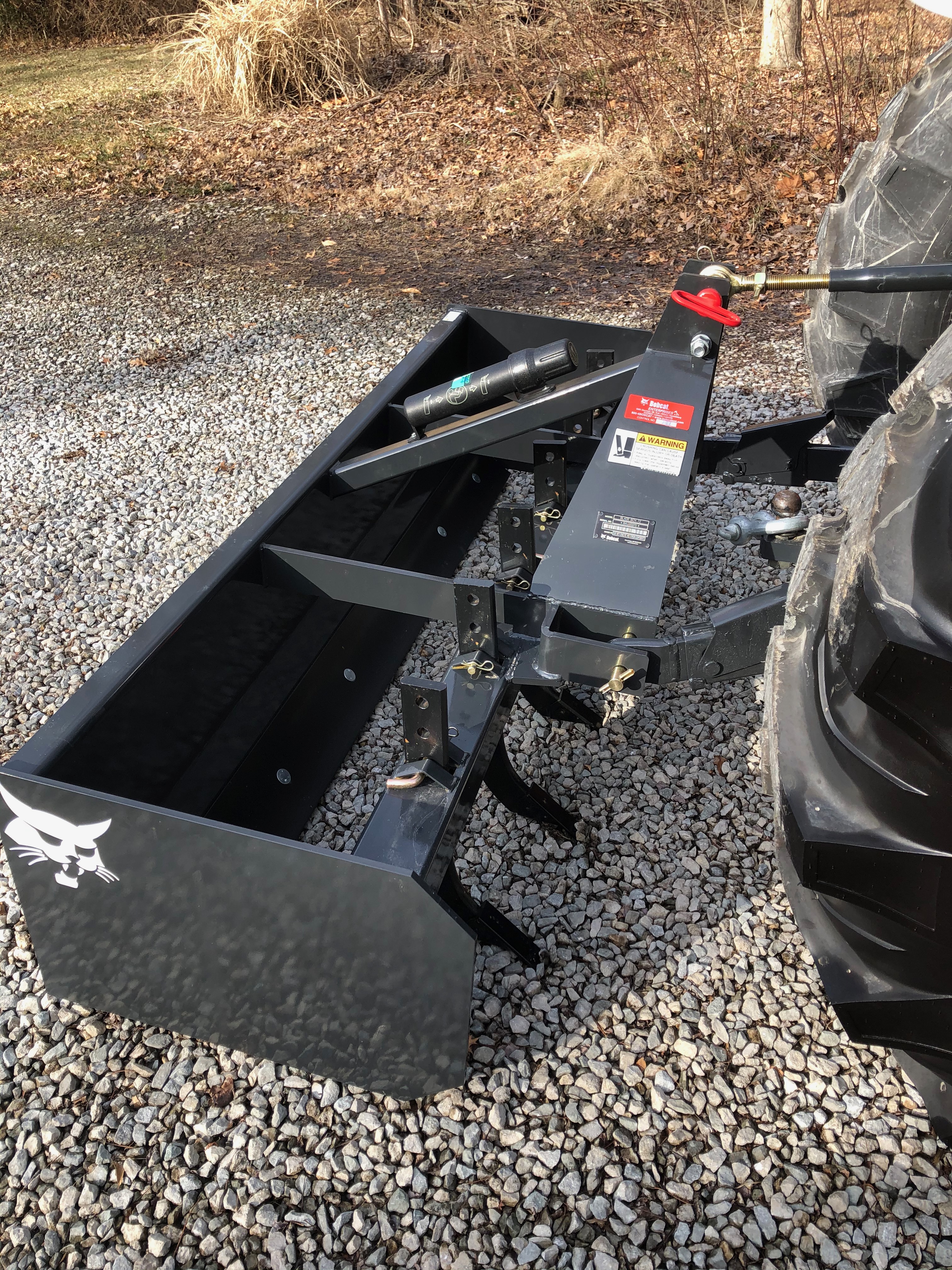

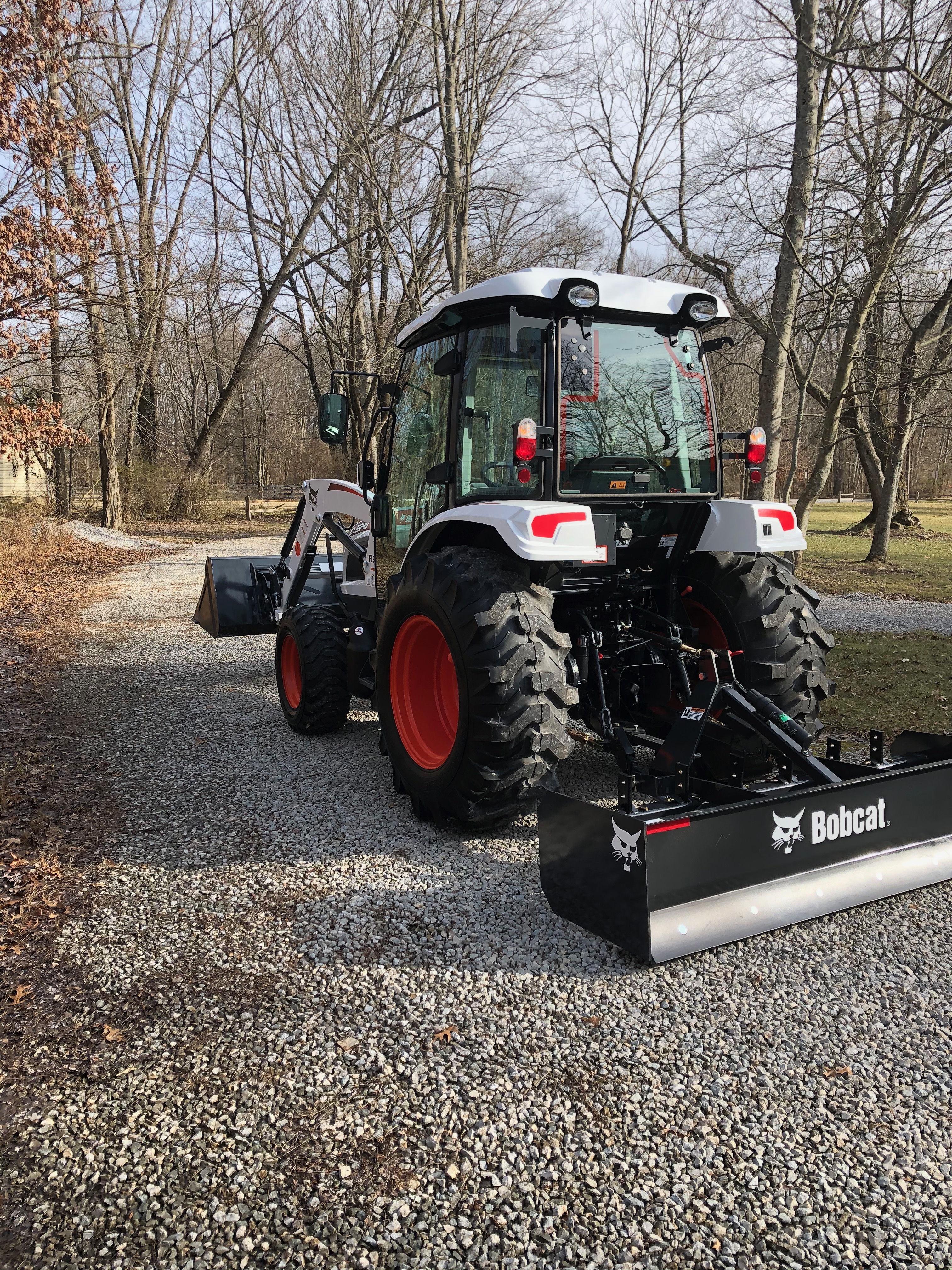

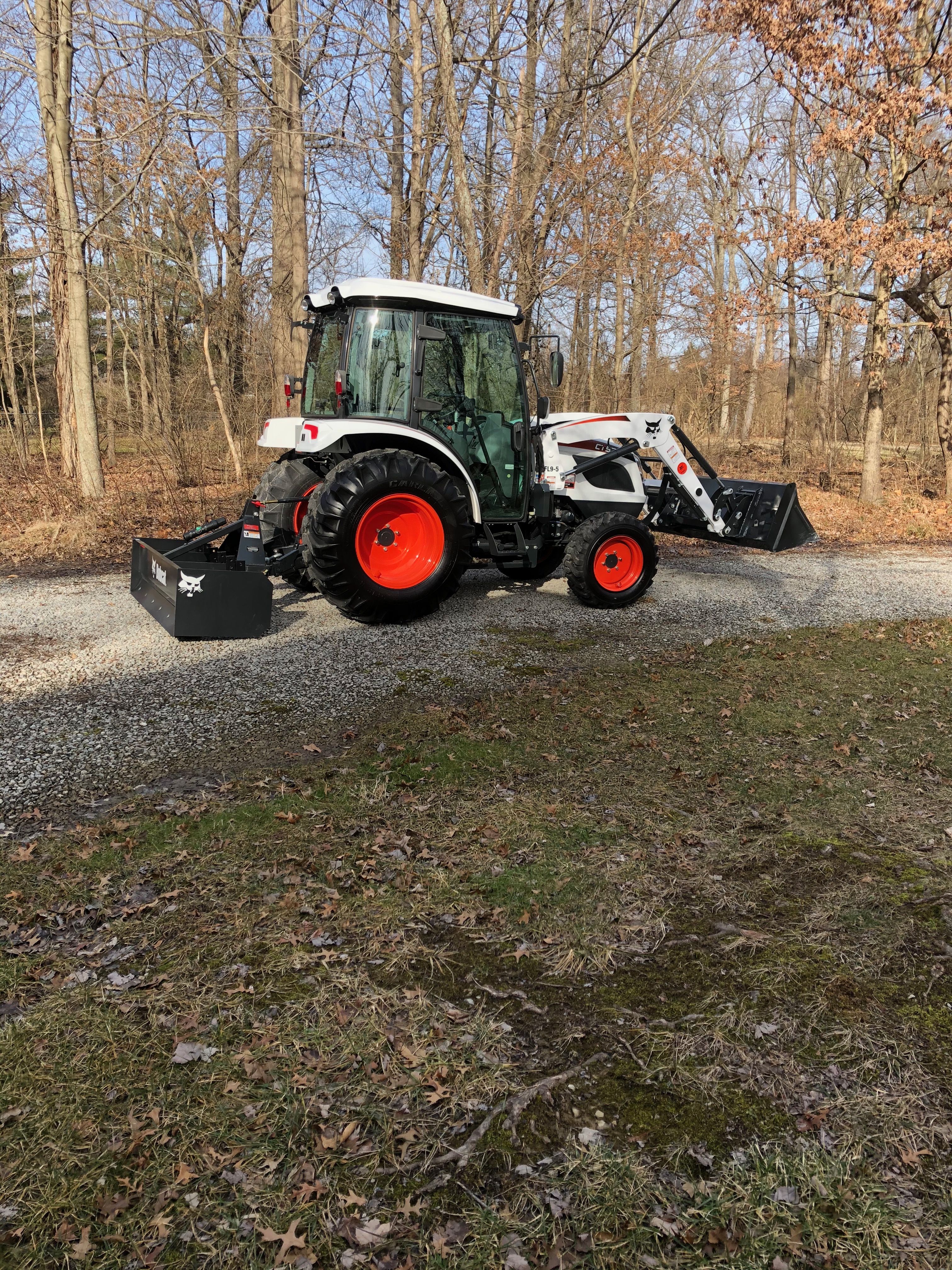

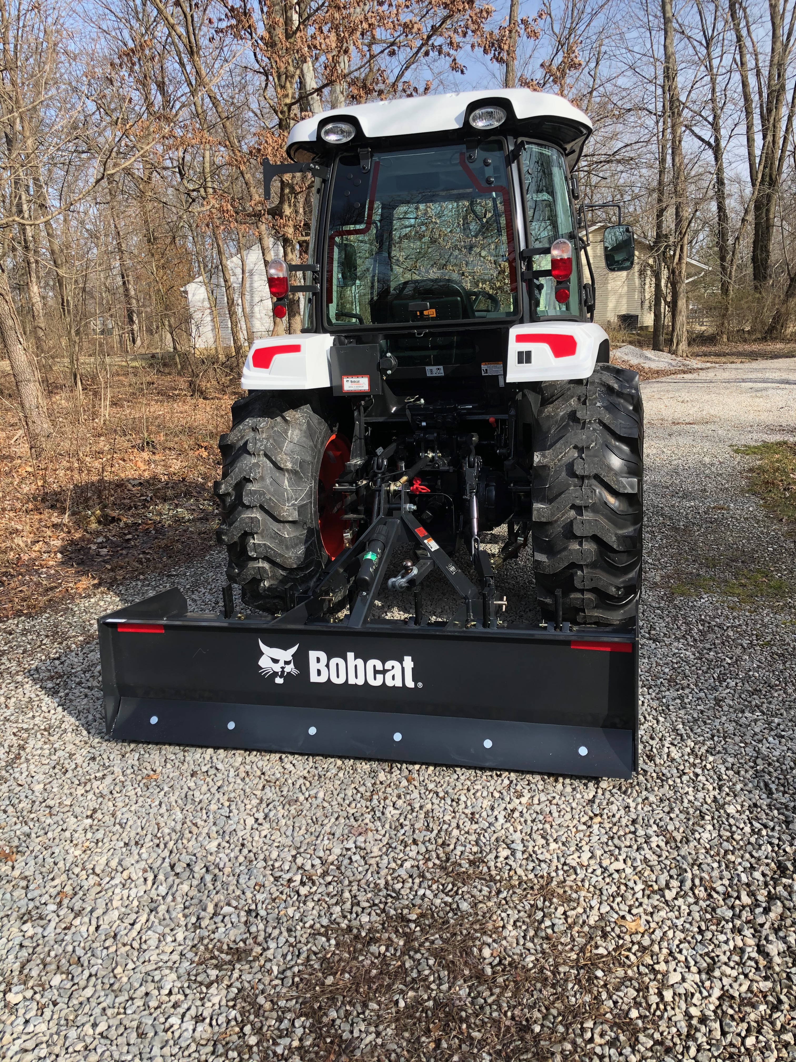

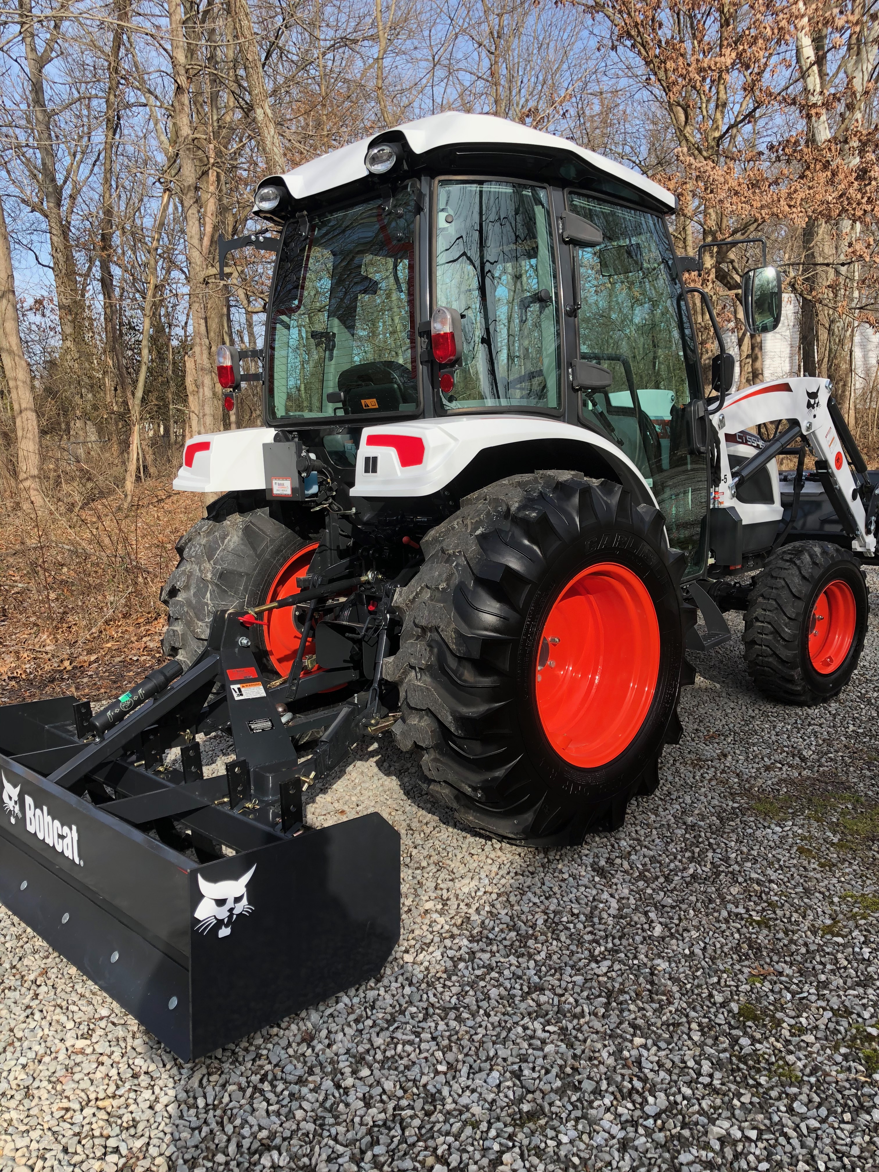

A few other pics of the Box Blade.

That’s a good looking tractor! I ordered the Jensen radio in the link so I can use it with my iPhone and hook up a rear camera and loader camera to it. I just hope there is enough room for the screen. I made sure it was returnable just in case.

I like that idea. I was thinking about a rear camera, maybe I should have considered something like you are doing. For now, I just wanted a bluetooth head unit that could connect to my phone. This inexpensive JVC does the job nicely.
A few points you may need to consider. I went with a "shallow" depth receiver, just to minimize weight above. But there is some steel up in the mounting area and an actual anchor bracket that you can bolt the rear of your receiver to. To do this, you will need to remove the roof, and I didn't want to get into that....yet. You may want to check your receiver depth. I think you will be fine as there is more room up there (in my tractor) than I thought. As for your screen, I like the way it ratchets up and down. I can see it working in the down position. Keep me posted on how it works. I may have to move in that direction.
