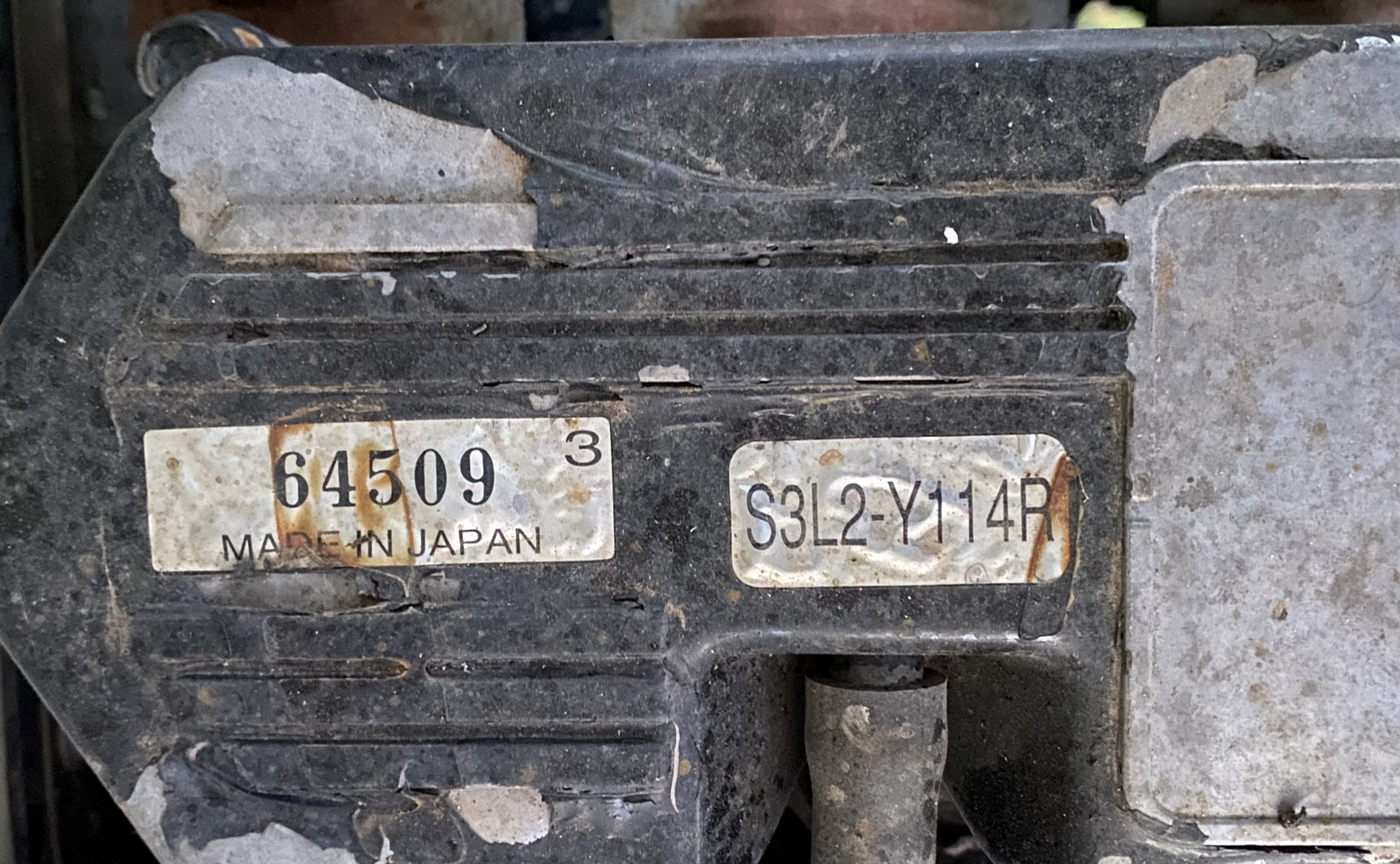

I have the Cub Cadet 7260 with the Mitzu 1.3L diesel block I have cross posted this in the Mahindra forum......( byte tongue) I hope this is allowed.....
I have read all over the place over the previous 5-6 years that the engine is the same exact block. And as such with all those parts interchangable.....
these all have the 1.3L mitzu block as far as i can tell.
231025 hp2002 - 2006
251625 hp2008 - 2018
252525 hp2008 - 2010
Max 2525 hp2012 - 2014
eMax 25S25 hp2017 -
152626 hp2016 - 2018
Max 26XL26 hp2014 -
162626 hp2018 -
Max 26XLT26 hp2018 -
261526 hp2003 - 2008
C2727 hp2002 - 2006
281028 hp2002 - 2006
281528 hp2006 - 2008
281628 hp2008 - 2010
301628 hp2011 - 2021
Max 28 XL28 hp2012 - 2014
Anyone care to share any data or help out?

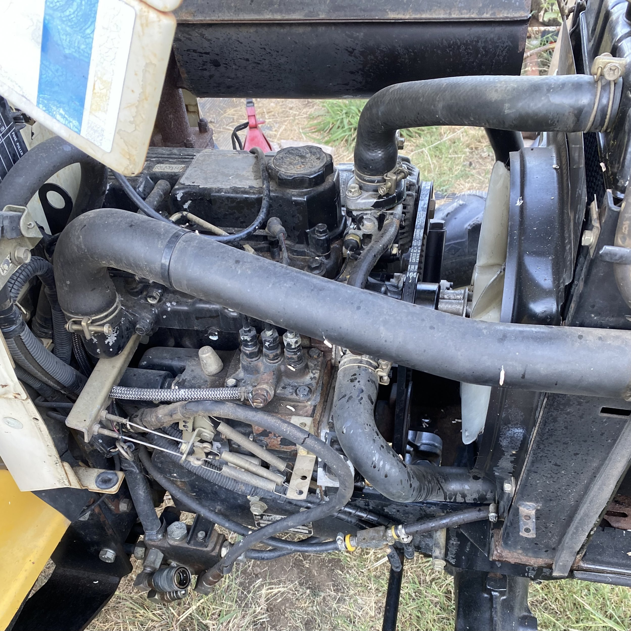

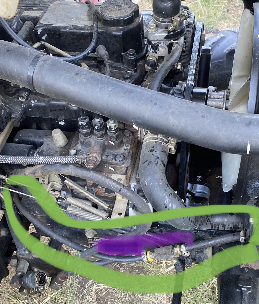

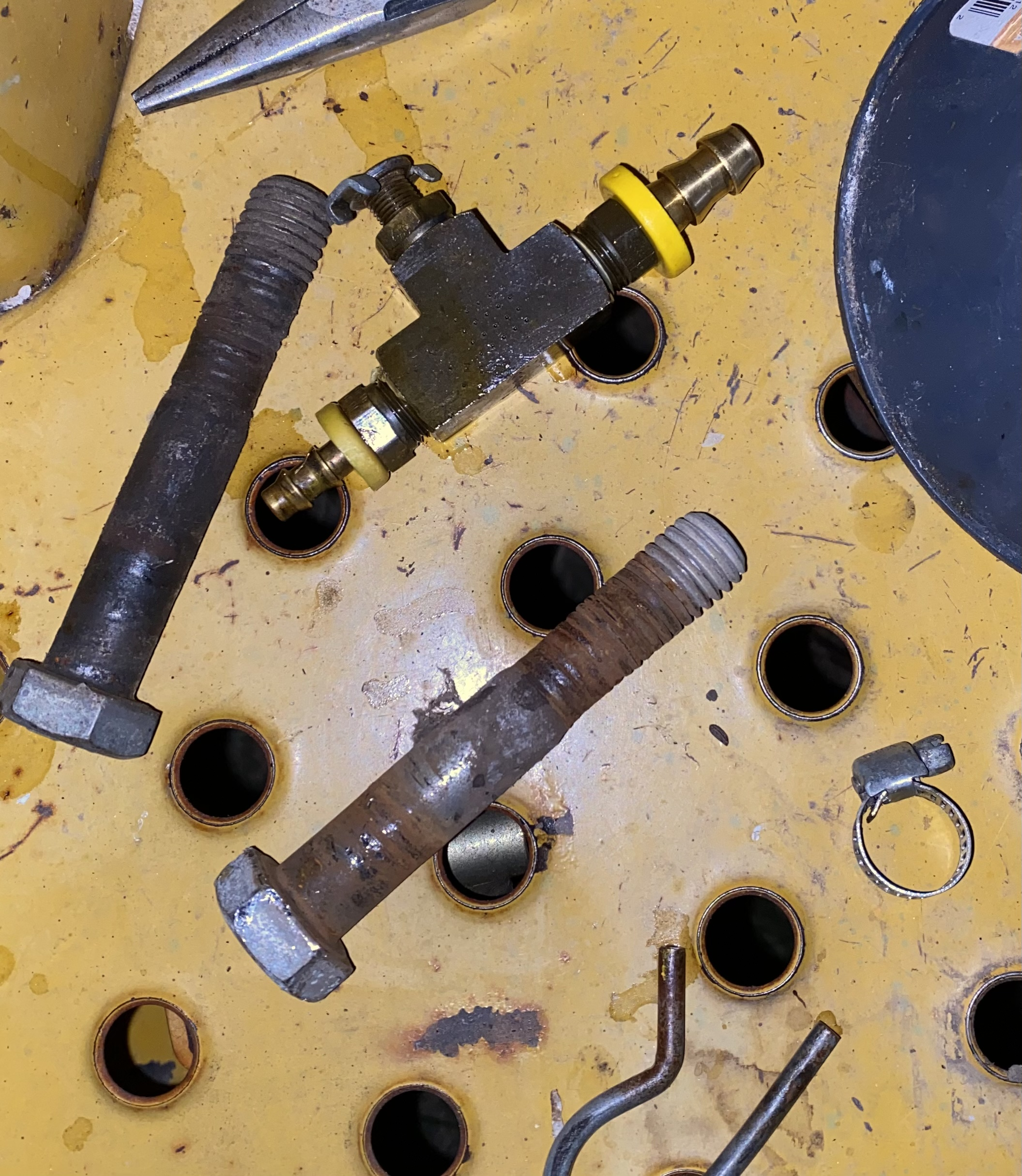

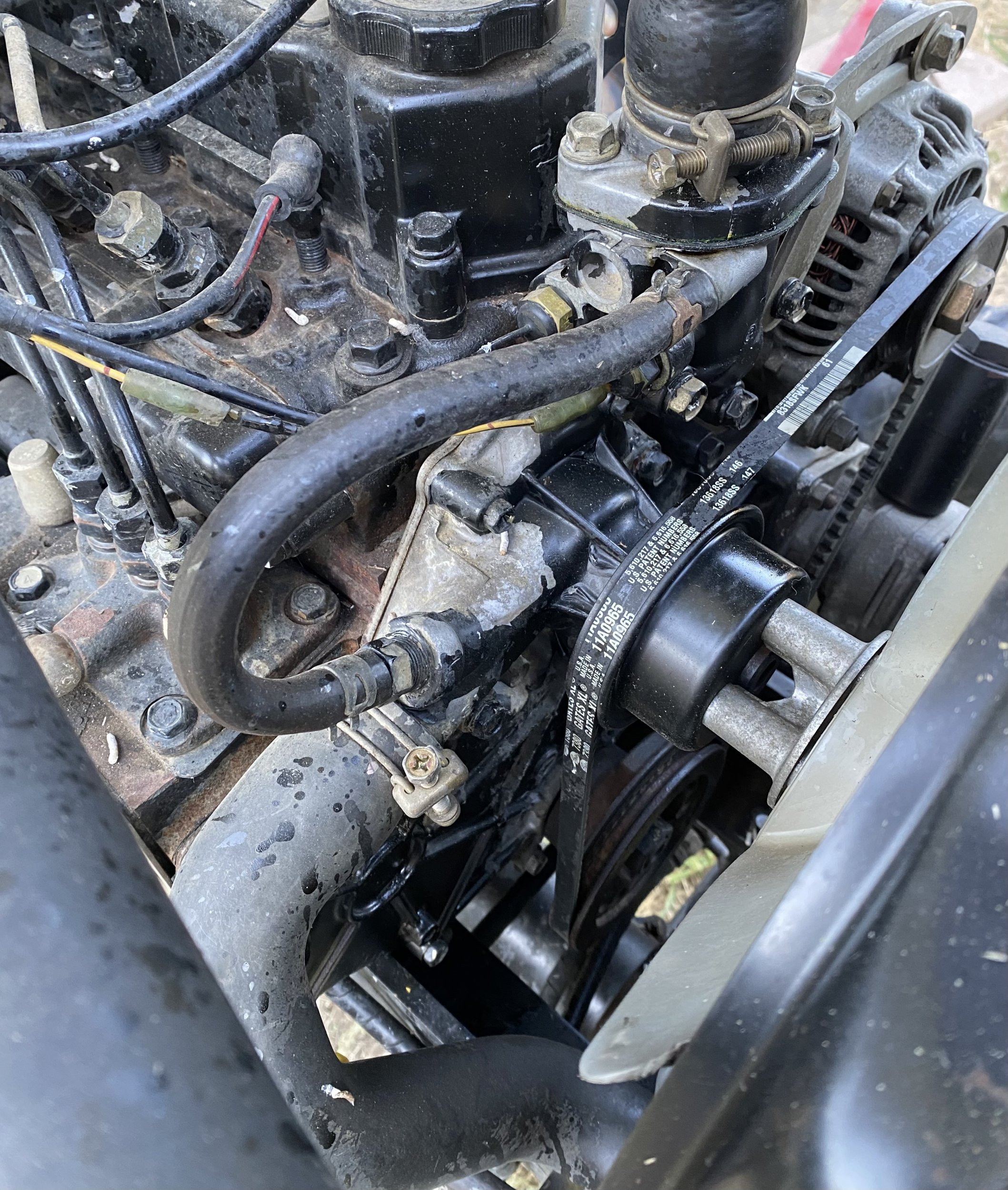

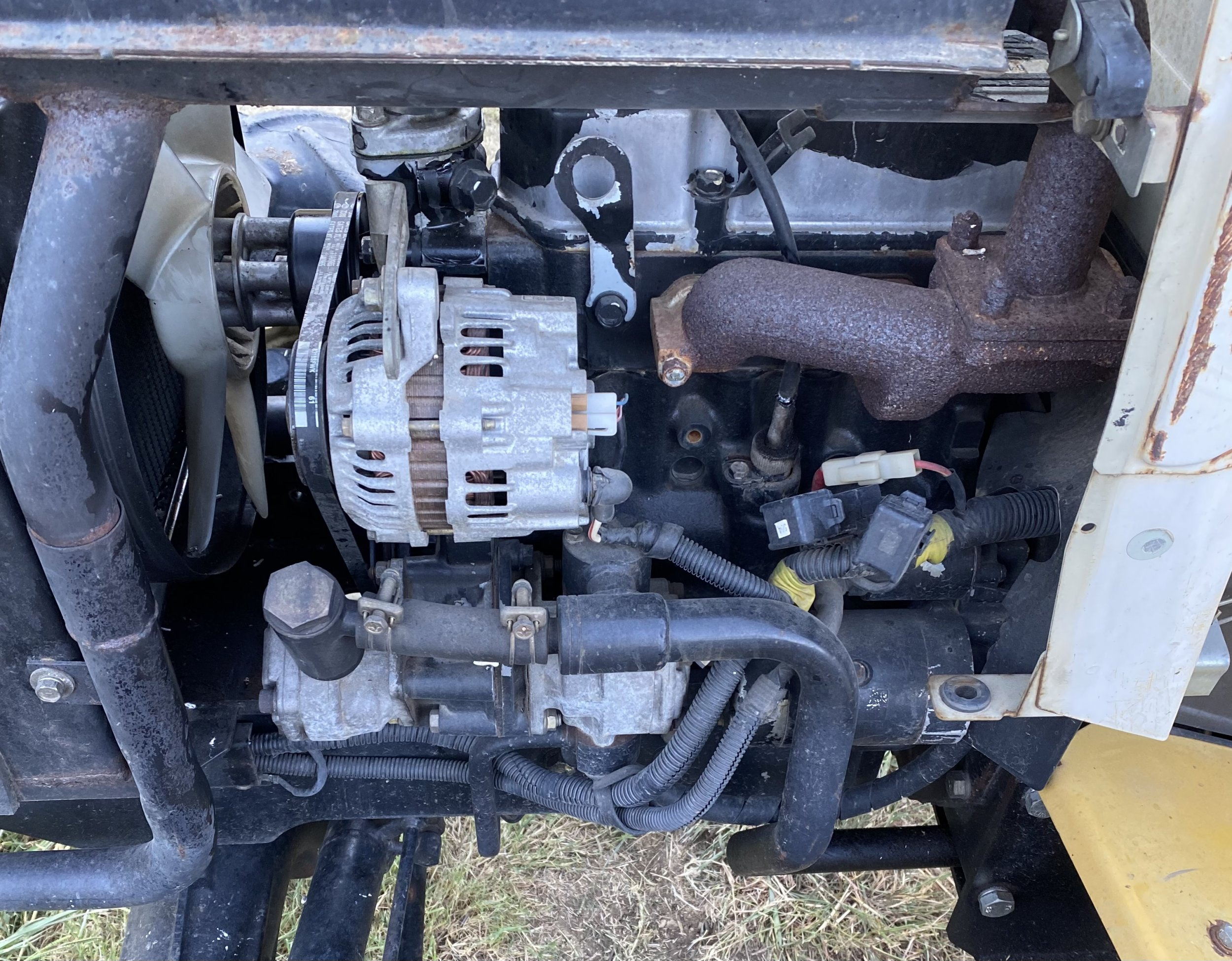

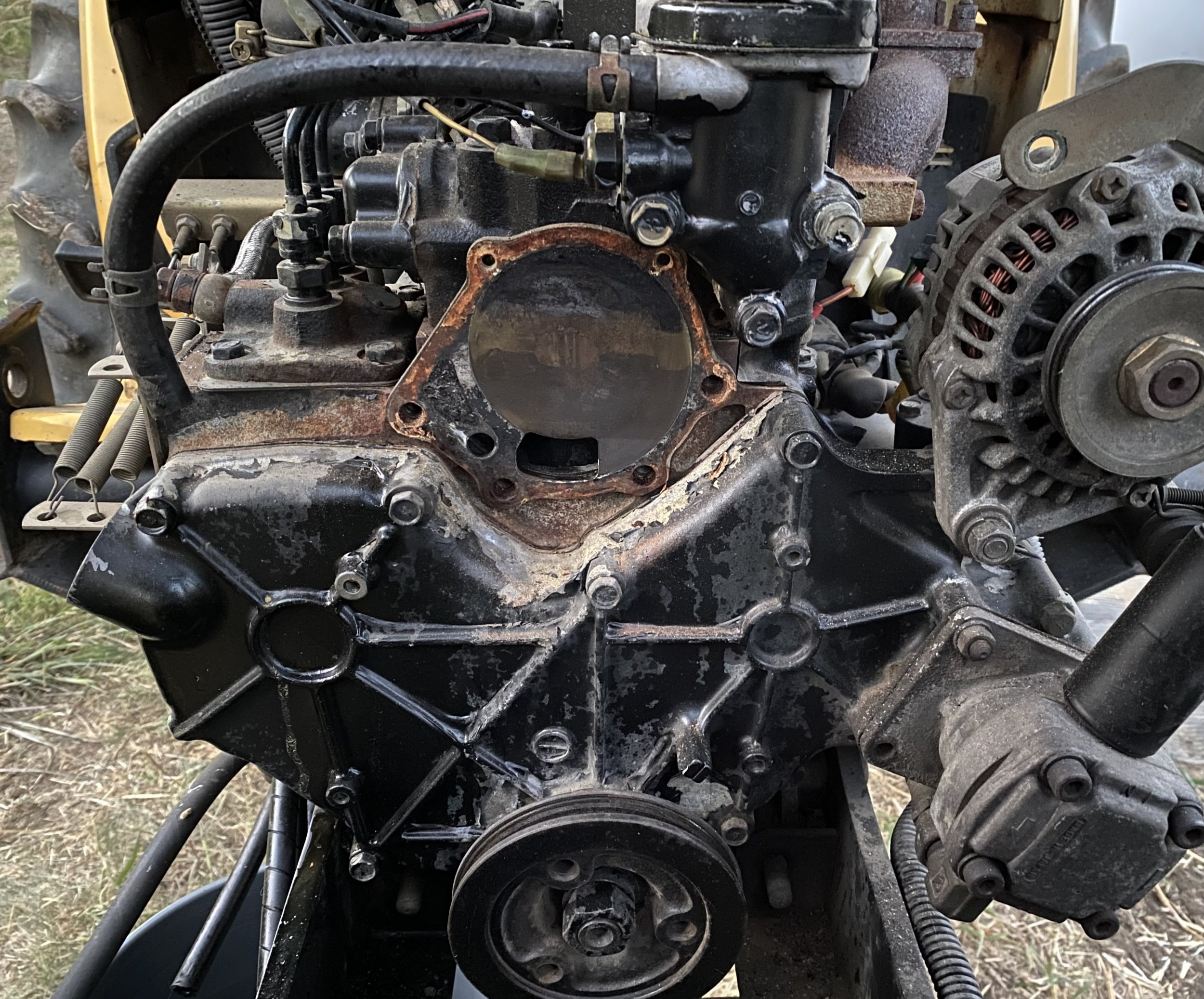

Update with pictures.
In 1st & 2nd pictures (same picture) the Green outline is the hose in question.
The purple line is the approximate quantity of material that had clogged this 1/4” coolant hose & the brass drain valve .

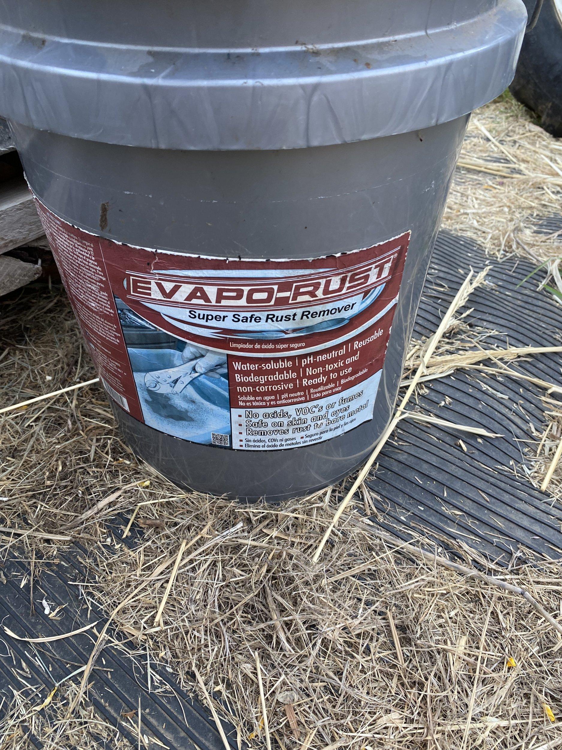

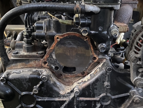

The water pump came off very easily and it was spinning correctly AND had no slippage or play in the bearings either. So I sat it in the bucket of evapo-rust to soak for a day or two. Sorry no picture of the water pump itself when removed.
I plan to take the radiator to a friends shop and we will pressure test it with his test kit later this week.
