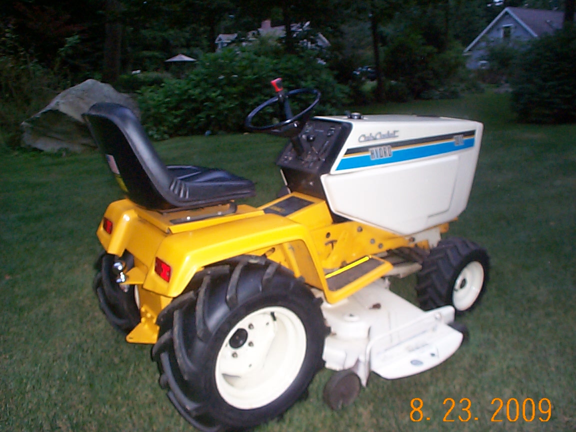

Yes defintley loony to put all that into a such a machine. Ha - When my magnum 18 goes south in a few years I will likely do the same.
You wont regret it and have fun! heres a pic of my 1811 which is the off color cousin to your 782.
