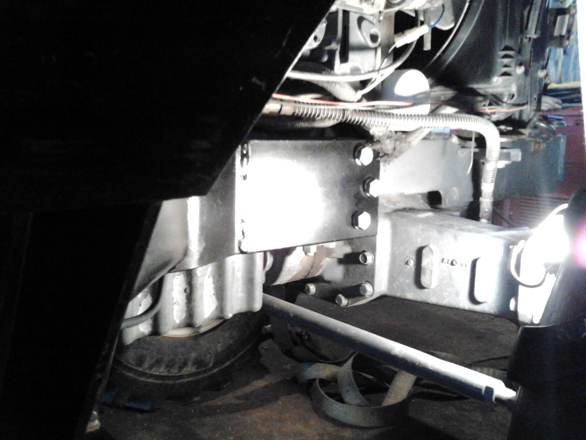

I am welding up the loader mounts and a new crossbrace that mounts under the tractor for the loader.I just copied the one I have for the CC640 loader,had to change where it bolts to the transmission housing.I will have to get the new work primed and painted,but should have them back on soon.Then I will be on easy street with this project I hope.
   / Cub Cadet 8454 Buy It? #54
Looks good, that will be a pretty kick butt tractor once you get it together...

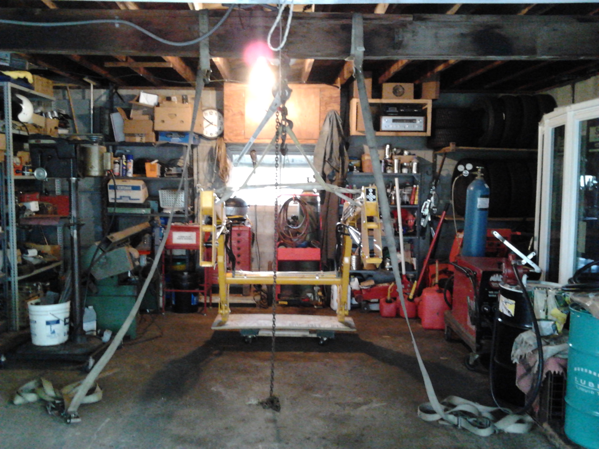

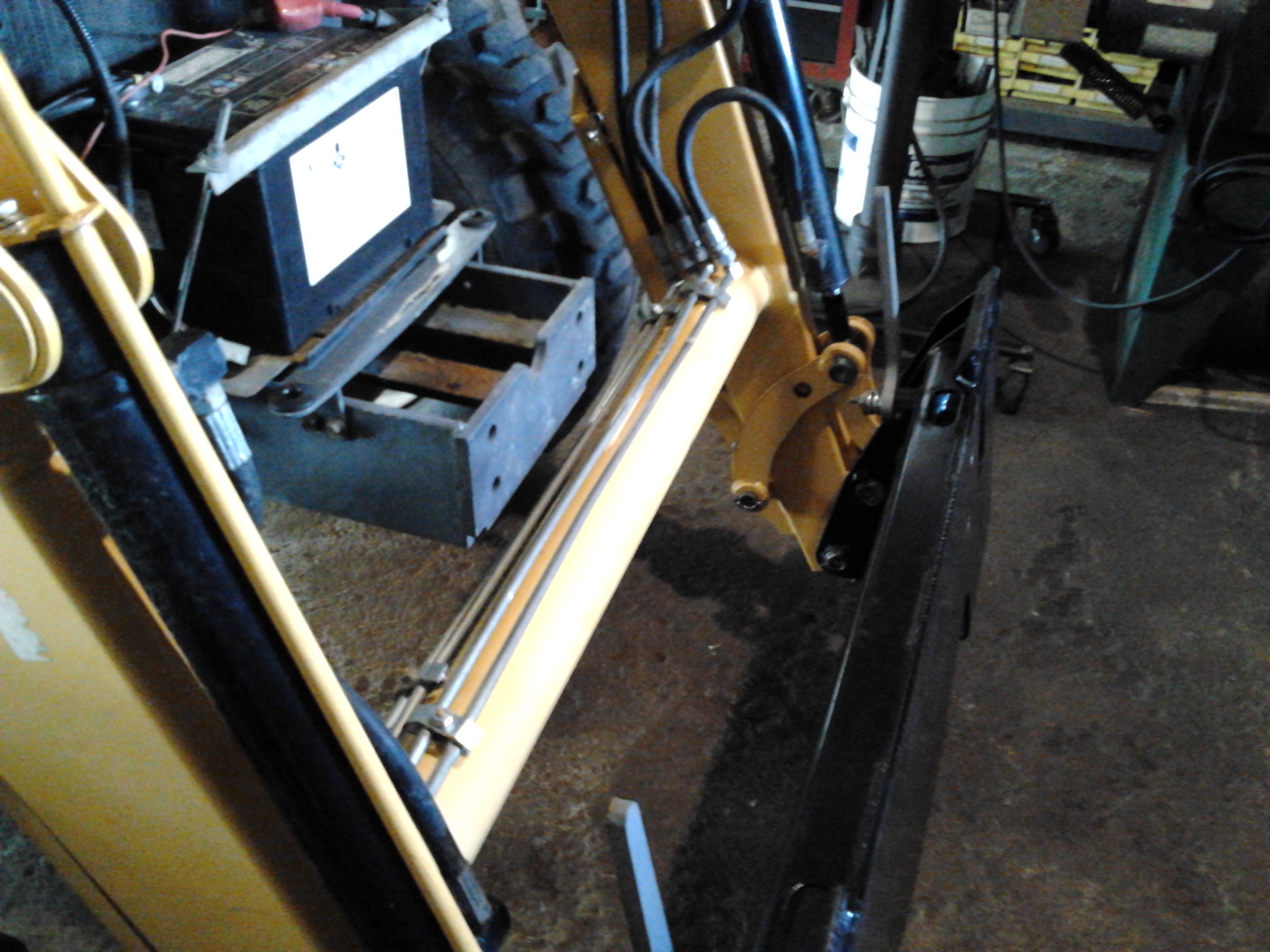

I am ready to mount the loader on the tractor tomorrow.It sure makes hooking up the hydraulics easy when everything comes with the loader,and you do not have to hunt for parts and piece together,like I have done before.I installed new radiator hoses and the hose that joins the hydraulic return pipes for the pump,I wanted to replace it before I bolted the loader mounts on.
The clearance for the front of the tractor looks really close.I think the loader will only clear the front of the tractor by about an inch when it is lowered past the frame.8454Mount R.jpg8454MountL.jpgLoaderGarage.jpg

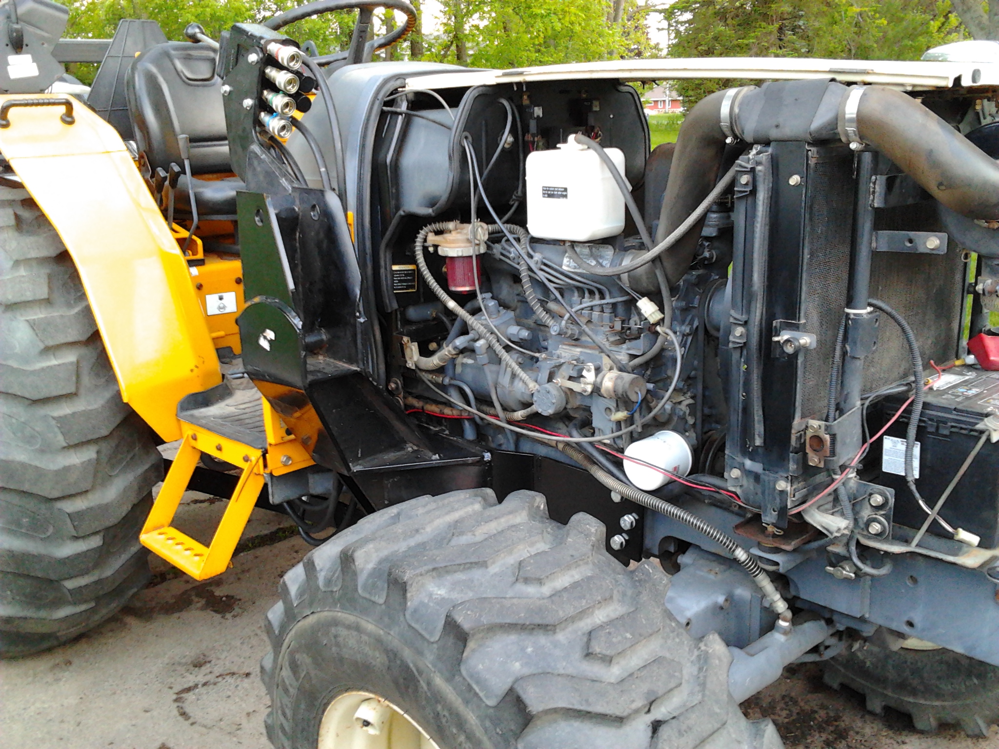

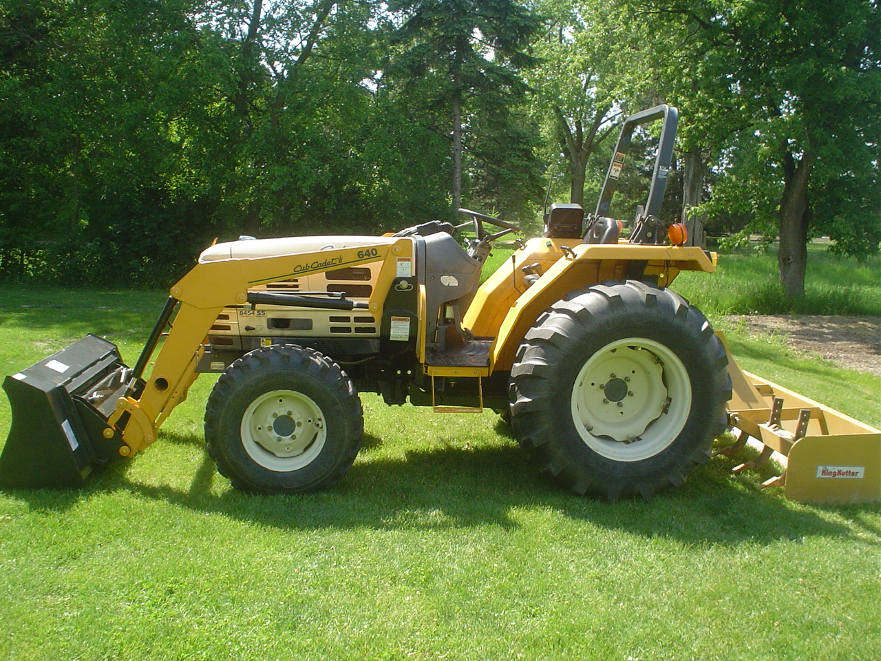

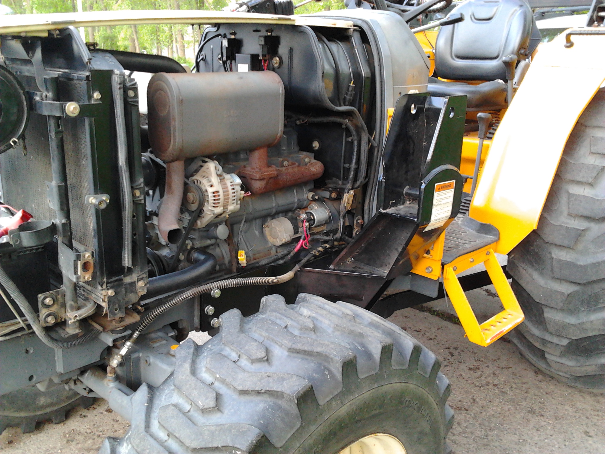

As far as comparing this tractor to a skid steer it seemed to lose a few more advantages to a skid steer.The loader controls are very fast like a skidsteer,I won't be able to load dirt or gravel into anything more than a few feet above the ground.The loader has little reach for dumping after raising more than a few feet,I will just use it for spreading gravel and fill after it is delivered.I do like the loader not sticking out far in front of the tractor most of the time,easier to move around.It takes up more room than a skid steer,and not near as easy or fast to turn.
Here is a pic of the loader and the front frame of the tractor,some clearance is better than no clearance.CC640Clearance.jpg
