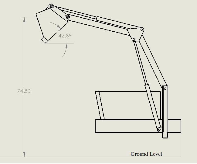

   / Cub Cadet Homemade Front Loader Finished #12
It looks great. I'm a little curious how far the bucket will dump when the loader is raised all the way up. In one of the pictures it is raised all the way and looks like it is dumped all the way. Maybe just me.

#16
That picture is deceiving because the cylinders I used are so long. It has a 43 degree dump angle and max height which seems to work quite well. I have attached some of my drawings showing the dump and curl angles and Max and Min height.

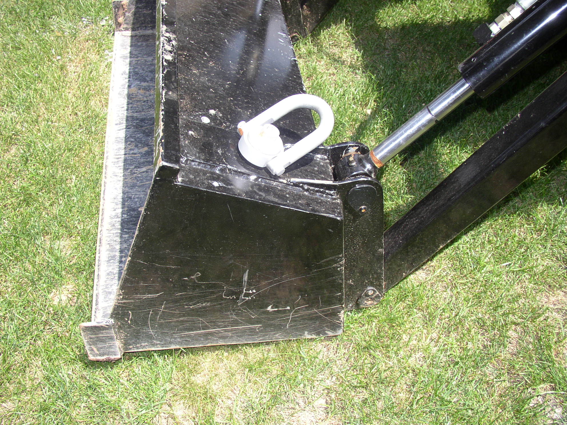

Question: In the pictures showing the finished FEL sitting near the stairs, what are the silver-looking things mounted on the backside of the bucket? In one picture they seem to be elongated from a mounting bolt toward the upper lip of the bucket. In another picture they appear to be reversed and pointing the long portion toward the bottom of the bucket. I am sure they are useful to the project but I can't figure out what they are:confused: Nice fabrication BTW.
