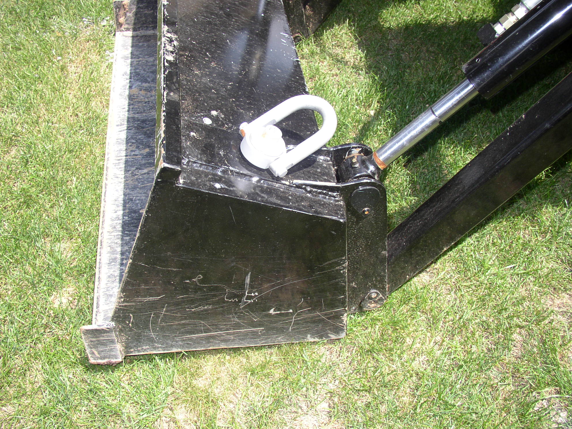

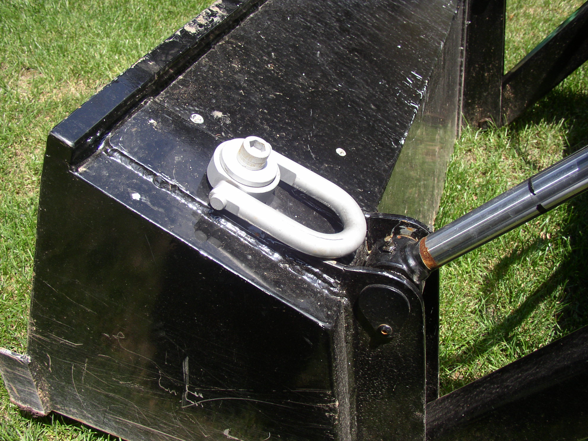

Question: In the pictures showing the finished FEL sitting near the stairs, what are the silver-looking things mounted on the backside of the bucket? In one picture they seem to be elongated from a mounting bolt toward the upper lip of the bucket. In another picture they appear to be reversed and pointing the long portion toward the bottom of the bucket. I am sure they are useful to the project but I can't figure out what they are:confused: Nice fabrication BTW.
Arkaybee
Good eye. The silver things that you are looking at are some swivel shackles that are bolted to the top of the bucket on each side. I got them for free and they are rated for 6000lbs each. They have come in handy for strapping objects that don't fit into the bucket. Attached are some pictures.
Someone was certainly generous to give you those lifting shackles as good quality ones are not cheap.
