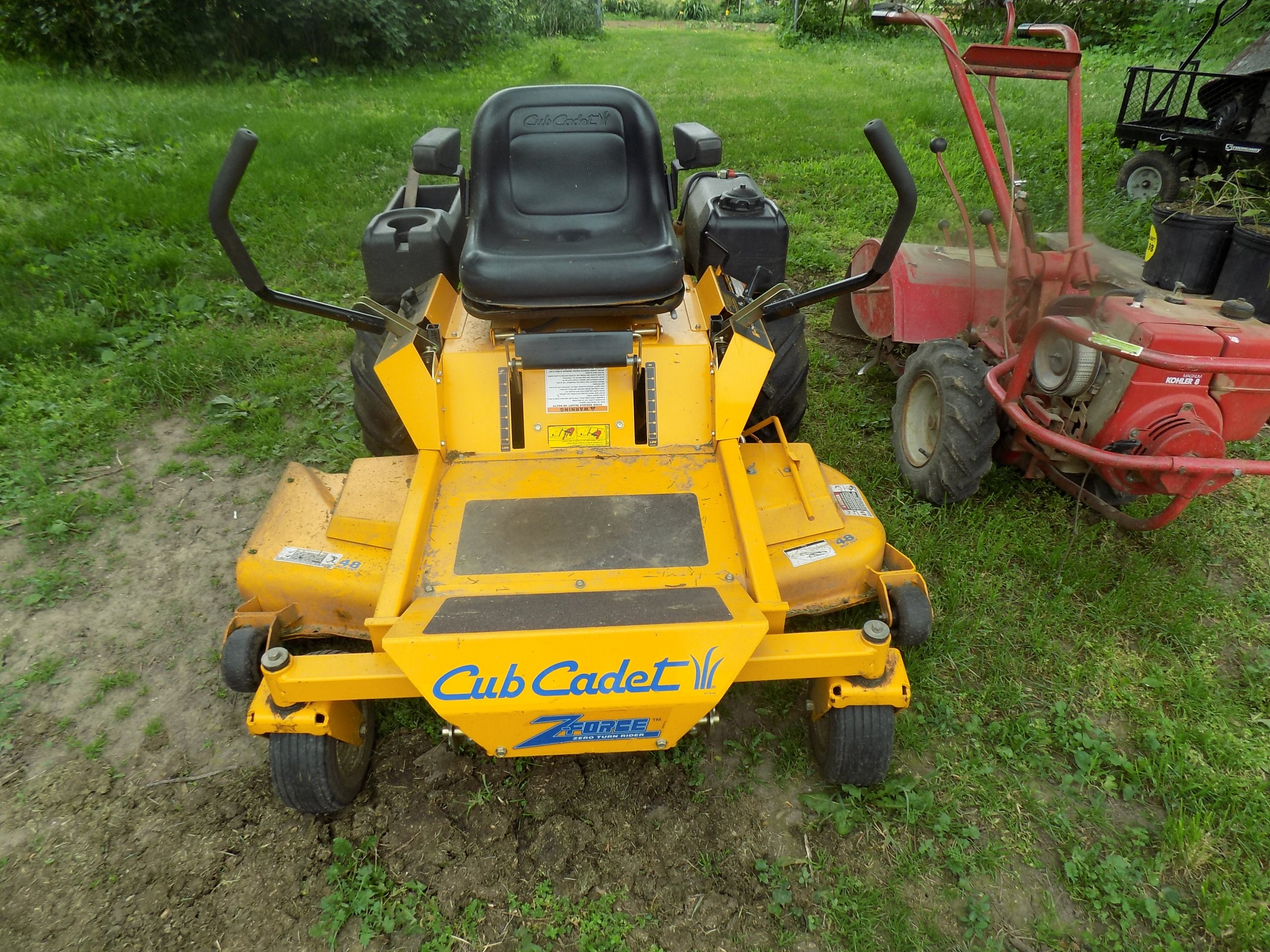

Bought this thing at an auction and found no drive belt from motor to deck,--deck belt there and good! O.k.,---whats up with this?--new idler pulleys also on it! HMMMM! so I go buy the 79.5 belt that dealer said it S'POSED to use and finally got it on,--way too tight but hey never argue with the dealer! 28 hours later the belt explodes and we done! Tried a longer belt and it started to rub after a couple hours so got an 80 incher. All is good for about an hour when belt starts getting hot si I quit for the day and let it cool off,--next day same ole crap 1 hour and hot belt!
Everything is in line as much as possible! Factory had a VERY poor idea of routing the main belt from motor to deck! All spindles turn super easy, belt is tight,( too tight in my book but no more adjustment).
What is the problem here on this mower??? anybody else have or been around this model??
grass is getting out of hand and I cant mow til get this thing fixed!

I would be a less busy man if it weren't for CUB deck belt problems. Let's start with the actual model number off the product tag, what belt # it called for and was put on. By the length you must be talking about the primary belt. You certainly want to take the tension off the secondary and inspect each component individually.
   / Cub Cadet Z-Force 48 main drive belt trouble #3
If the belt is over heating it is possible something is out of alignment causing extra drag or pull on one side of the belt.

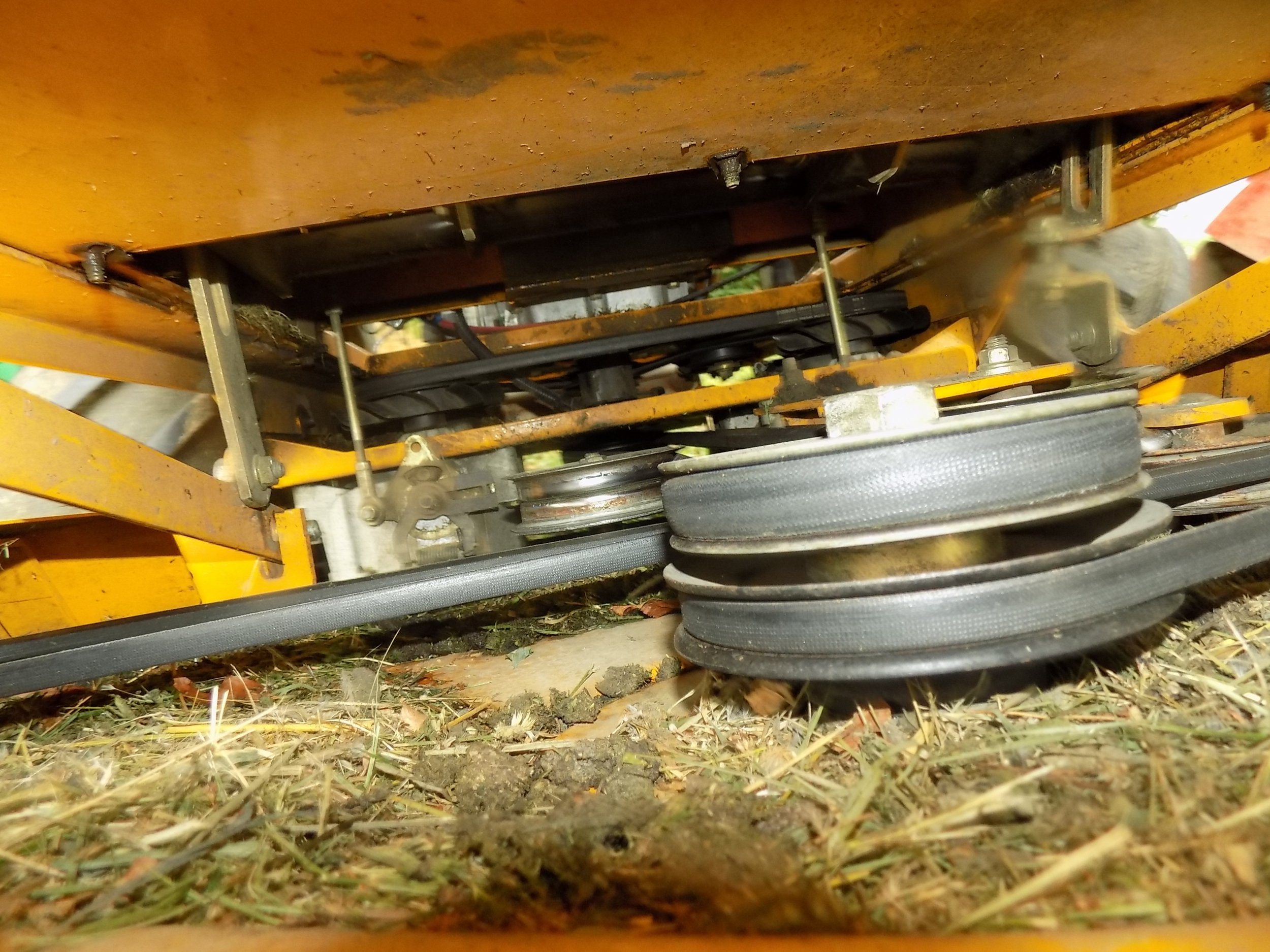

I also looked at the parts pic. in the link above and #46 idler pulley shows a 1.0 od? both of mine are same and both are flat and run on the OUTSIDE of the belt. ---all line up except for the step down. I cant lower the front anymore ---out of rod and I would like to lower it a lot more but cant without longer rods OR a belt longer than 80". From the sounds of it that wont help either! Sounds like these are junk mowers from the factory! Were they made by MTD? if so that x'plains the poor quality and the redickulus design of the whole mower!!!!

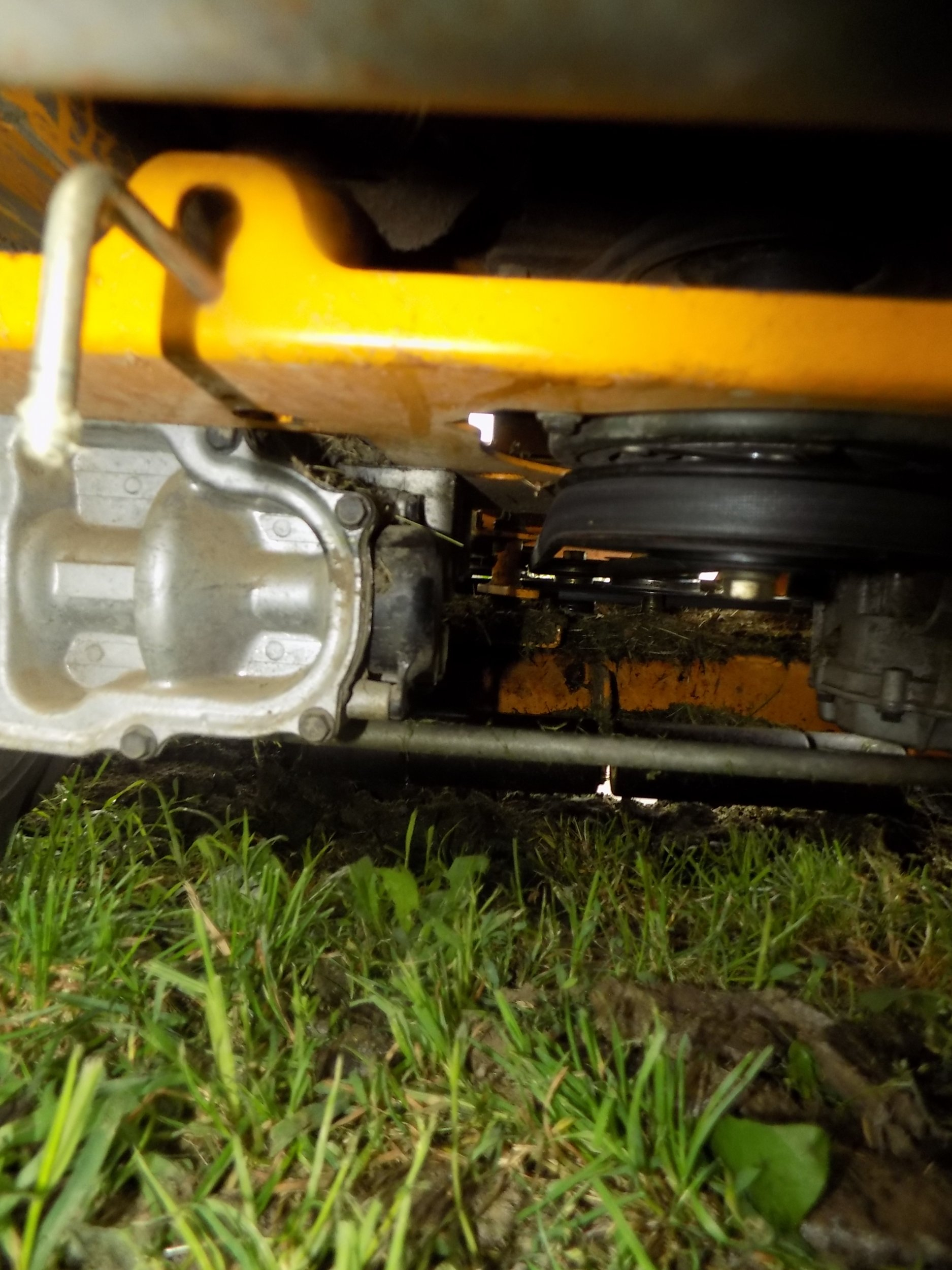

a couple pix. 1 shows the step that they made the belt run from motor to deck. you can see how radical it is.
Its hard to get good pix under there.

Since it was purchased from an auction I am wondering if it has the wrong pto clutch on it. Looks like the clutch is sitting too high.
That is another possible thing. Wrong clutch could throw things out big time! Will try to look into it and how its mounted. It sits way up in there and hard to get at. May have to remove it to actually see or find #'s, then see if they match up or not!
