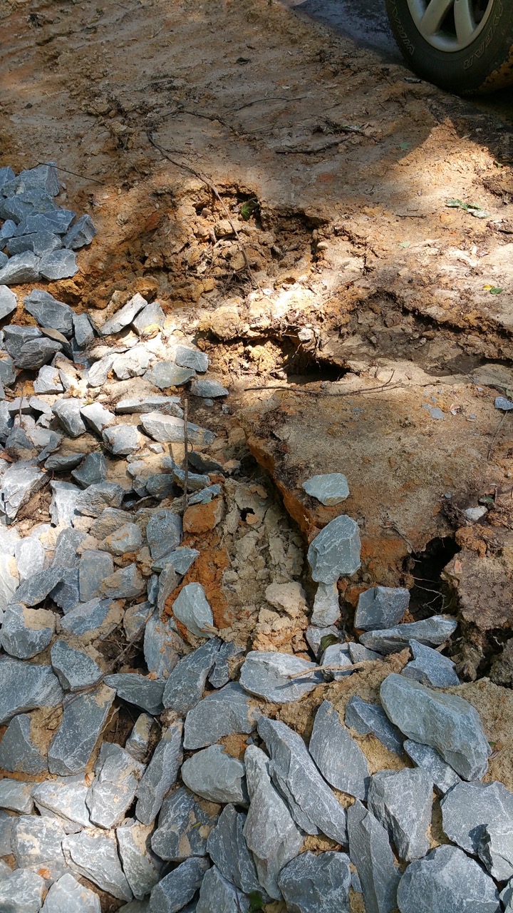

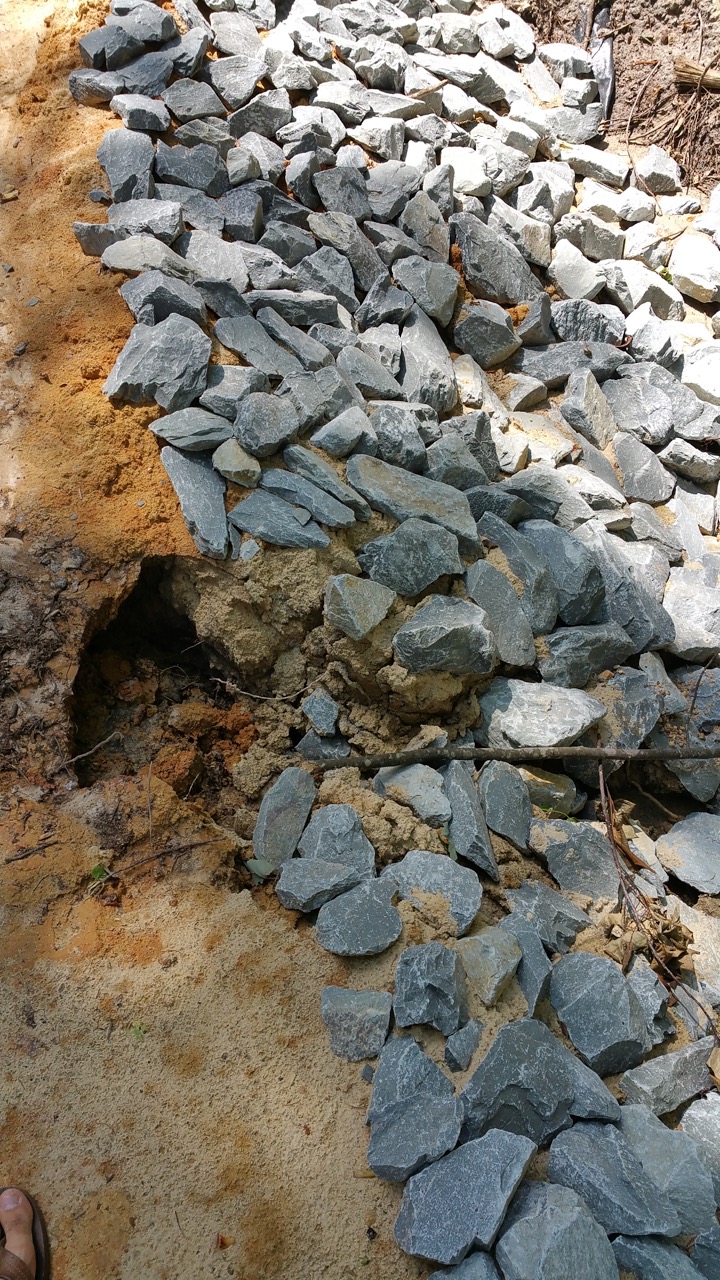

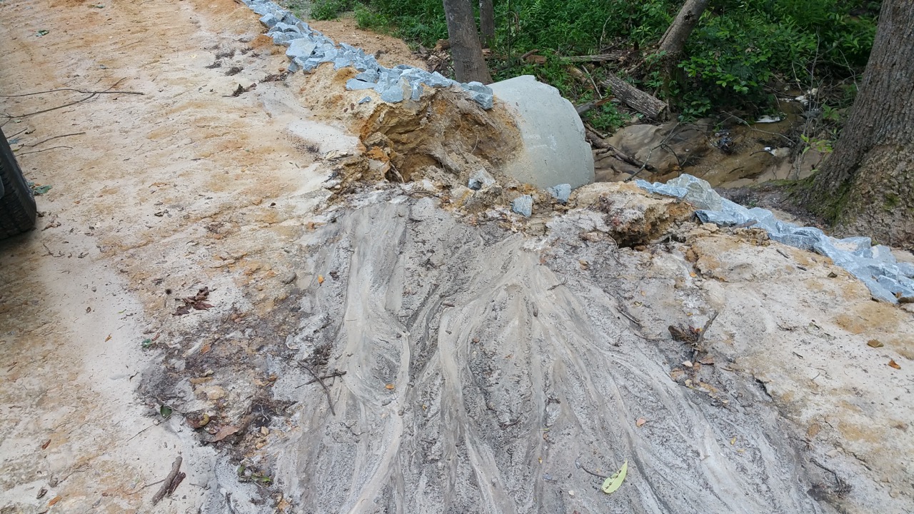

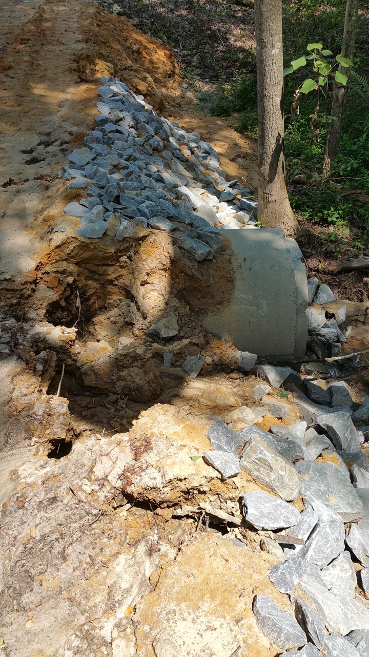

The wife and I were out of town for a few days. It must have rained while we were gone because we came back to a road that has partially washed out :smiley_aafz:
While I expected that we would have some settling - this looks more like a problem that is going to happen again and again whenever it rains. We really are not in a position to have the road improved right now. We would like to keep it passable and ensure that the culvert remains in place and functioning properly.
You can clearly see where water was traveling down the road - thereby causing the washout. What can we do to stop this from happening? Will more riprap help? Maybe building a small wall out of concrete bags?
The good news is that the inlet and outlet of the culvert are flowing well. The flow of water looks to be more "natural" than it was about a week ago.
I welcome all feedback!

Set the highest elevation across the road above the pipe with no crown. Keep the road flat (side to side) but sloping downward away from the pipe in both directions. Then start the crown with the sides slowly dropping away from the crown. Ideally, the roadway should empty off the sides starting no sooner than 20' from the pipe.
