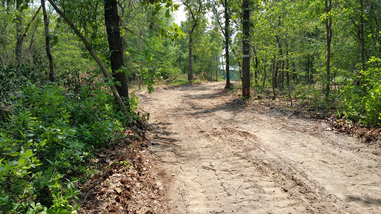

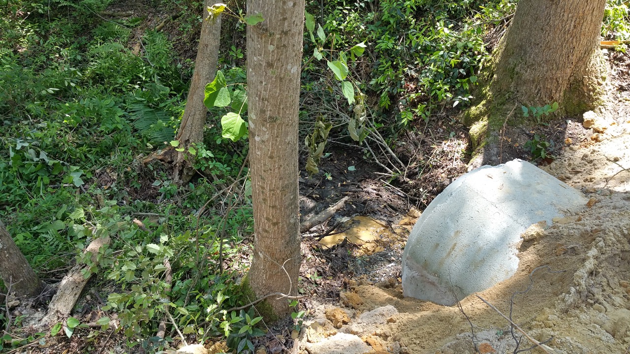

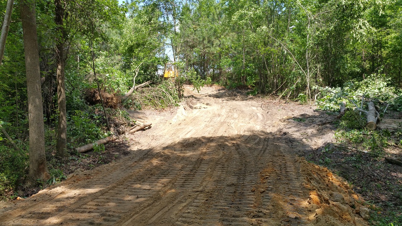

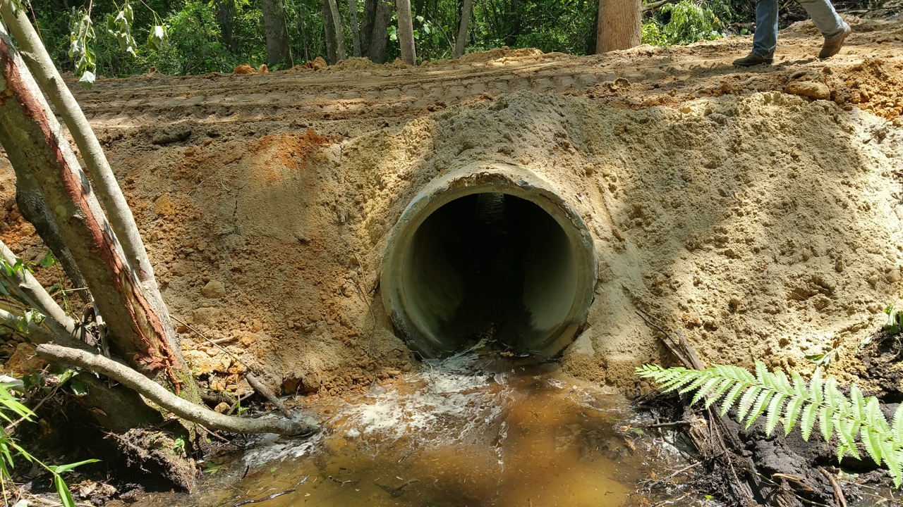

Hello everyone-
This thread has really come a long way. Just wanted to post some updated pictures. We went ahead with the three pieces of concrete culvert. Its a total of 24' wide x 36". Total cost for all three was $325 with transportation.
Im so glad to those who strongly recommended that I go with the 24' vs the original plan of 16'. There is no way that 16' would have been wide enough.
We still have work to do yet, but I can get the truck across pretty easily, which is a good start....
   / Culvert Question #69
Looks real good. You got a killer deal on them.
