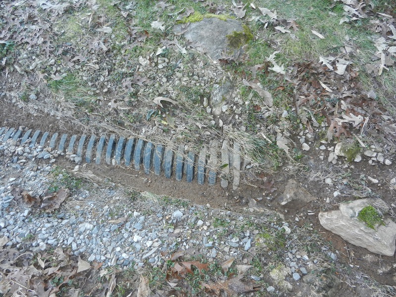

I guess it''s called a culvert.

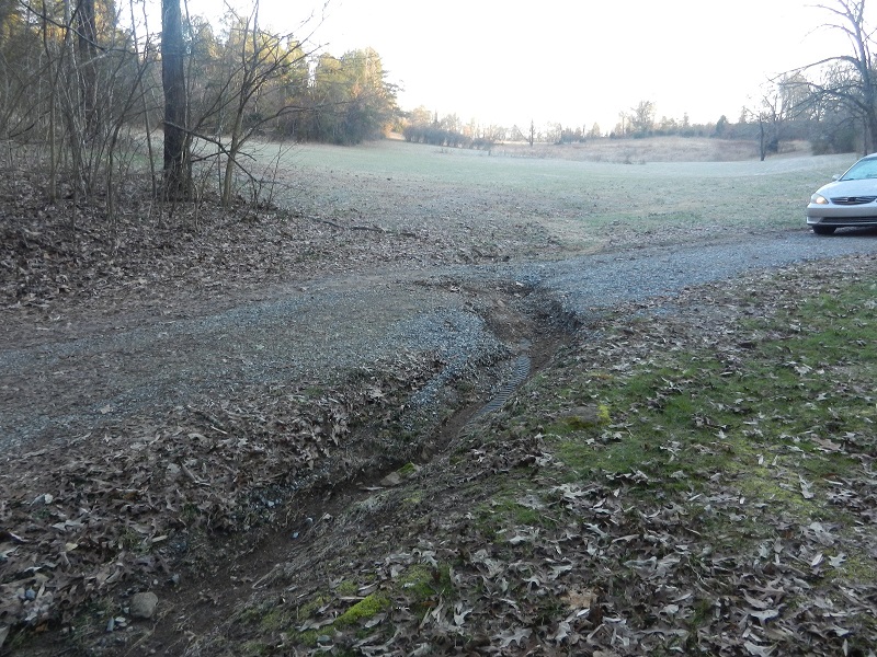

We have a drain running under our gravel driveway so the collection of rain water on the upside can drain down to the lake.
Years ago, we had the farm timbered by someone that wasn't thinking to clearly.
The agreement was in part that they would install a new culvert....and they did. THEN they started this part of the farm with their timbering and huge trucks.
The huge trucks crushed the culvert and when they were finished they were done. My father in law never held their feet to the fire to fix it.

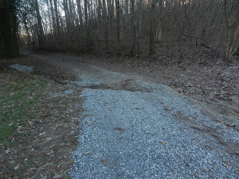

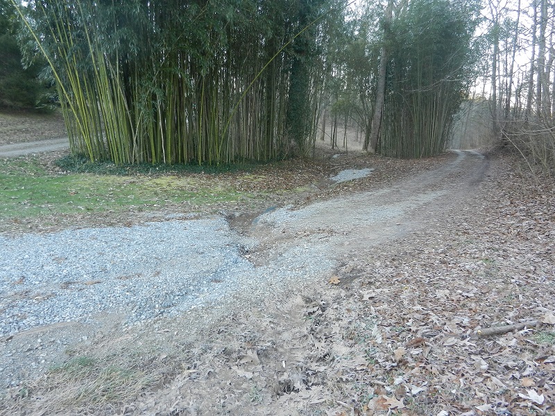

So, today it's now washed out.
It looks like the drain itself is (I'm guessing since I've yet to dig up the end of it) Anyways, looks like it's 10" correguated plastic.
What I'm wondering is what should I replace it with if in fact, it's crushed as it appears to be?
Would schedule 40 work? Just put more corregated in?
I'm planning on ripping it out with the backhoe which will give me a two foot swath. I can lay anything in there. Question is what would work best and be strongest.
Also, I understand that you want 50% or was it 75% of the diameter as coverage on top. So if the pipe is say, 12" diameter, you'd want maybe 8" of fill on TOP of it to spread the weight. (something like that)
This isn't TOO deep so that might be the problem. I'd like strong material.
