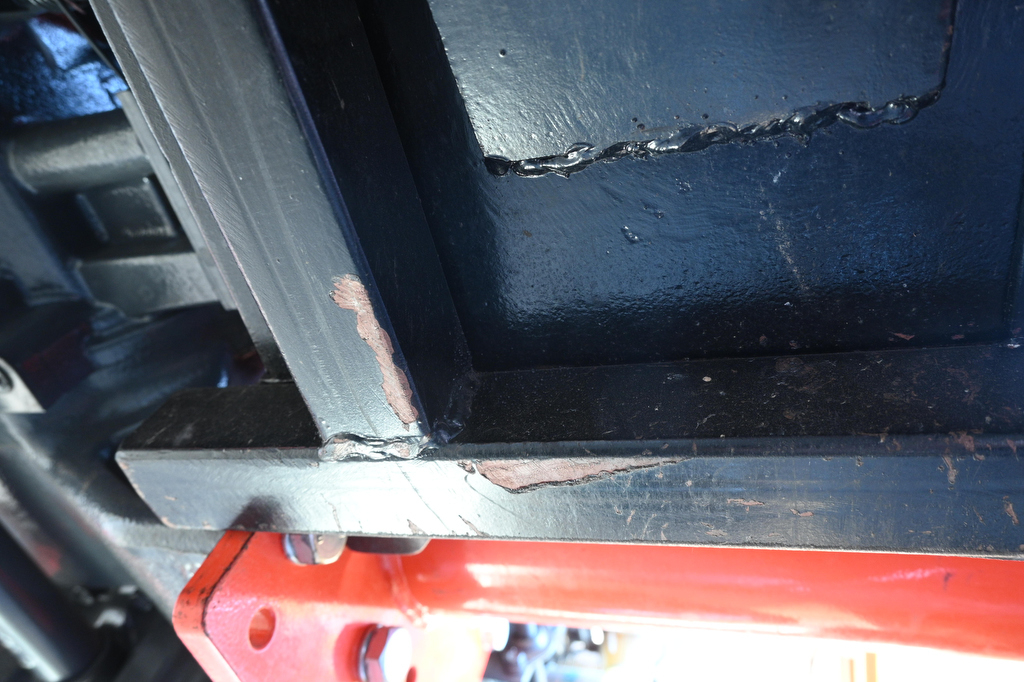

Although I've been careful, I noticed some paint has already been knocked off the protective guard I built for the hydraulic filter indicating to me that it was worthwhile to fabricate the guard.

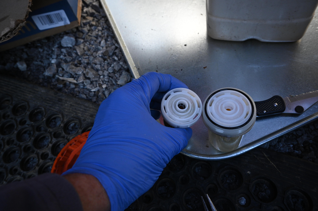

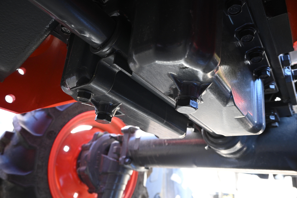

Some things I don't like: 1) the engine oil fill is located behind a plastic trim panel that has to be removed to refill the engine oil. Kubota could have at least included an opening in the plastic panel to remove the oil fill cap without having to remove the trim panel. 2). the oil fill diameter was too small for my regular funnels and a bit awkward to fill with anything but 1 quart containers; 3) having to deal with two engine oil drain plugs because of the twin sump although I can see how the twin sump is needed for the 4wd drive shaft; 4) needing to transfer two o rings from the old fuel filter to the new one. Why don't they include new o rings with the new fuel filter? 5). none of the filter canisters fit the multi fit filter cap tool I've used for years on my other cars and tractors so I ended up using a serpentine belt as a strap to loosen them.
