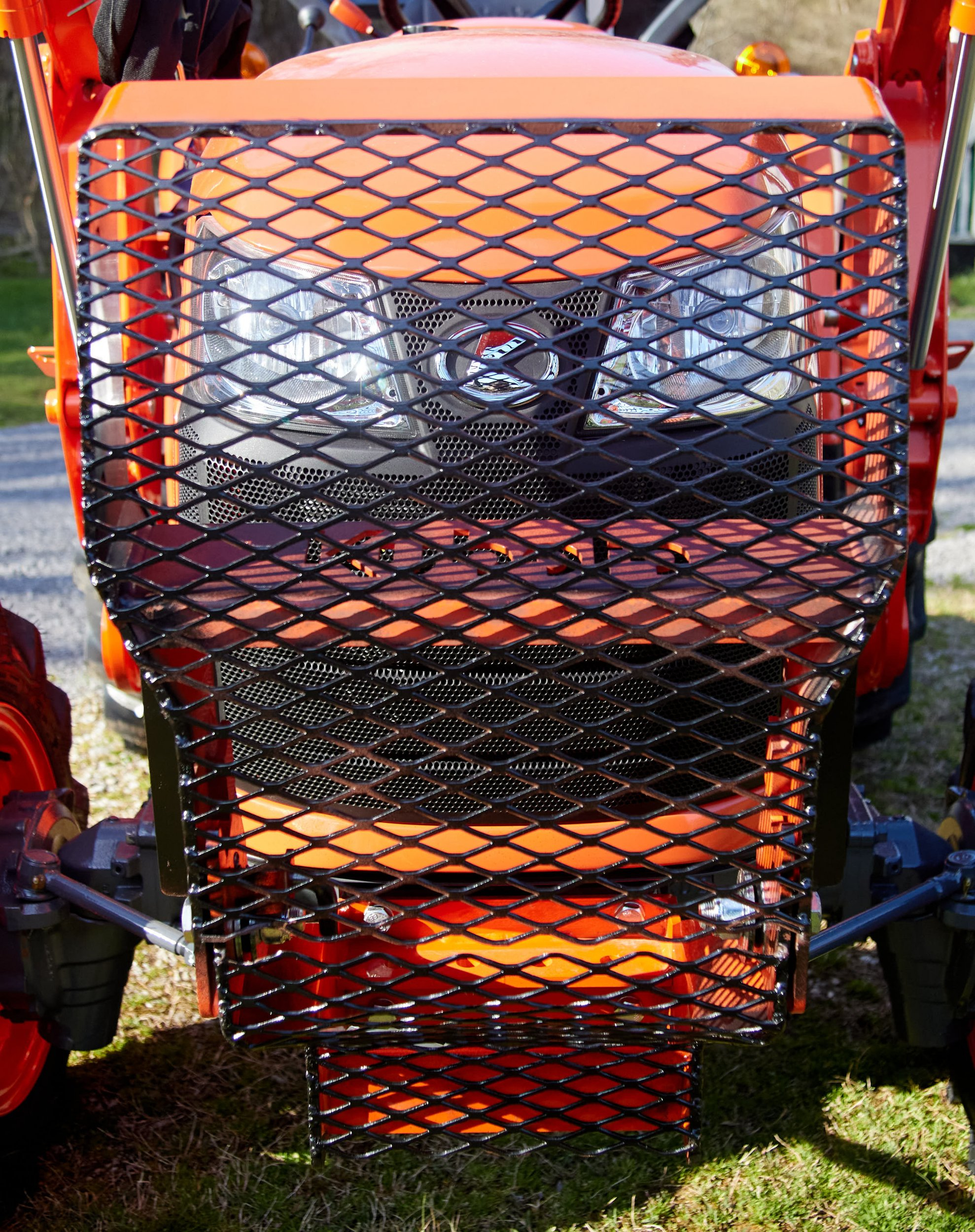

I got the front grill guard done over the weekend.
The expanded metal is actually a two piece design. One covers the top guard assembly. There's another that covers the second lower mounting bracket so the guard still tilts out. It may be difficult to see that it's a two piece design.
The other thing is I added metal wings to the lower part of the top guard assembly to try to make the front guard actually cover the width of the plastic grill behind it.
I couldn't find any Kubota orange paint near me except in 1 gallon cans. So that's why I used black paint.
Onto the filter guards after it stops raining.

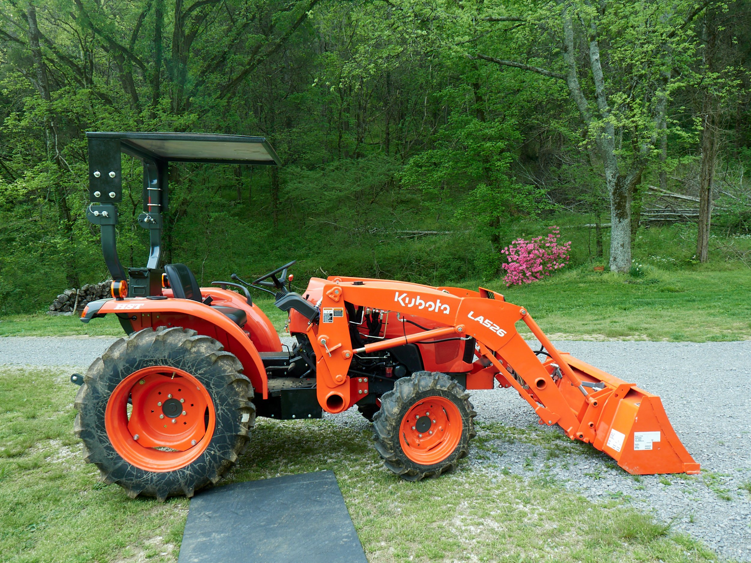

Finally completed the guard for the other filter as well as the canopy. Oddly today, I had a briar stem poke its way through one of the holes in the floorboard despite having the filter guard in place below it.
$20 for the steel from the scrap yard, plus some odds and ends I already had. $34 for four U bolts to hold the canopy to the ROPS.
