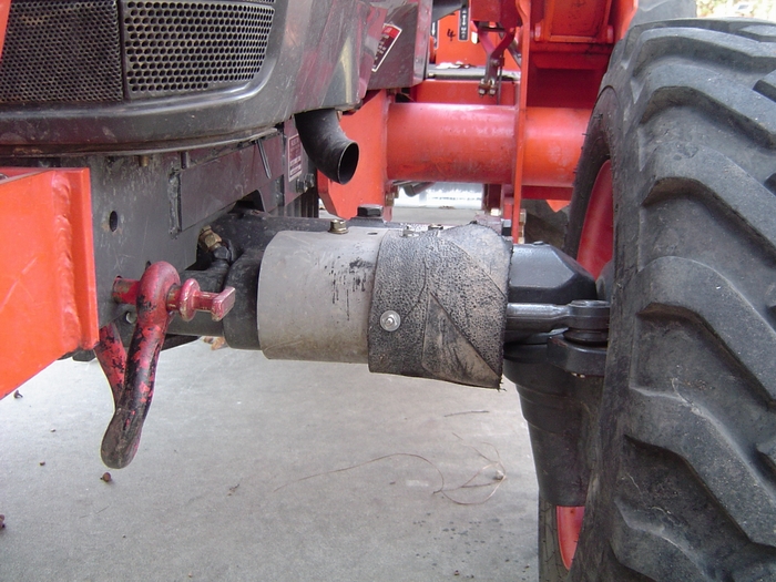

129933d1242489375-curses-foiled-again-tractor-boot-flap-11-23
wow never occured to me that some tractor maker would put the stearing in the front to beat up on.
(mines behind nice and safe(ish)

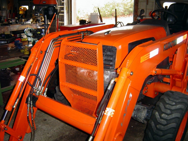

Today I got my make-over grille installed on my tractor. It has the stair grid material welded in... which should prevent further mishaps.r I think the stair tread will protect the grille, hood and headlights pretty well.....and the stuff behind them. This grille guard should be near "bullet proof"....and still lets the air through. Should be ok with my headlights too.....but I dont operate at night too much.
I only wish I wudda done this in the first place....as this grille got pretty expensive with the weight bracket, 1st assembly, 2nd revision. Oh well....if it does the job....it will be worth it. Hoods, headlights and grills aint cheap either.
I straightened my damaged grille (see first post) and blew some paint on it.....now with the new grille guard you can hardly see the damage. (grin)

How did you get the step material to fit inside so well? Did you lay the grill on top of the material and mark it? How did you cut it? Torch?
Sometimes I use a regular circular saw with an abrasive disk. Cuts pretty good, especially in tight places. I have been thinking of getting a dedicated metal cutting circular saw for odd jobs. I noticed Northern sells a cheapie...
FREE SHIPPING — Northern Industrial 7 1/4in. Metal Cutting Saw | Circular Saws | Northern Tool + Equipment
Will most likely get one of these...with the guide and fence...
http://www.mytoolstore.com/milwauke/6370-21.html
/ Curses....Foiled Again.
#32
I wish I could take credit for the workmanship here.....but I had a freind do this for me whom owns a welding shop. I set out to do the job myself....but lack the right tools. I think he cut it with a torch....but I did not ask him. I do know he did some grinding to fit the three different sections inside the frame. The whole setup is a bit of a "piece-meal" affair....and nothing is real true....so that makes it doubly hard to do. Also, my guard fits real snug onto the weight bracket....and has a little twist in it.....so that makes it a challenge to mount. It's all ok now that it's installed again....but it was a pistol to attach.

Actually, when you put it in front you can use a cyl that has a rod that extends all the way thru the cyl & out each end. These can operate both wheels w/o cross linkage. When behind, the setup requires linkage, and the hyd steering is not equally powerful in each direction. The single rod cyl is more powerful on extend than on retract.
Engineers W/O real world experience know this from textbooks.
