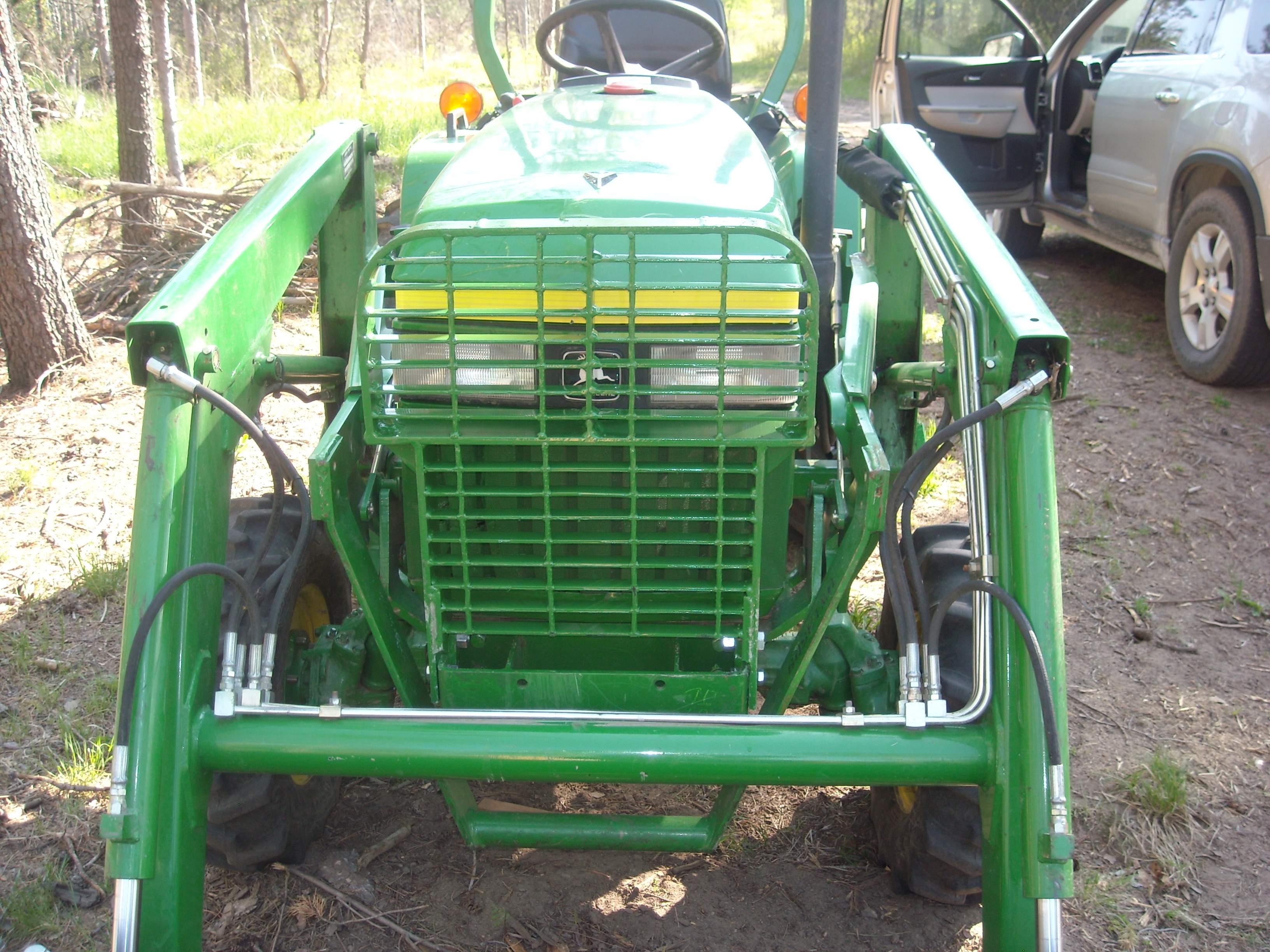

In viewing you photos foggy, it looked to me you grill was tough enough? Looks like that branch just tore the welds off and pushed the steel back. With that in mind, I'm not sure expandable metal would have helped much? I've had a few holes punched in the tractor grill and even a small branch go right through the windshield of my old Blazer. Sometimes stuff just happens.

Unless you can find it in a heavy gauge, expanded metal won't do much for you. Woven wire can also be found at wharehouse equipment suppliers. It's used to make stockroom cages etc. The stair tread idea sounds good too though.

I am going with the "stair tread" idea as that seems to provide the best of all worlds and may hide my grille damage (anybody wager a guess on a replacement grille??). I cannot seem to locate any of the woven wire....but from the grille I saw with it....it also would be the ticket.
I will post a picture of the finished product.....as I know some others are operating under similar woody situations.
   / Curses....Foiled Again. #24
Those stair treads sound ideal, maybe with a chunk of crusher screen in front. I don't know how but I managed to rip the drain fitting off my JD4300 radiator one day. Stick went under the guard.....

Here's my idea to get all objectives met with minimal expense- hopefully. Make a plate of heavy enough material to withstand the brunt forces of a large branch, and make it in the shape of a shallow 'v' so the pointed end is toward the fel and the open end attaches to the tractor's brush guard with a flange on either side. Like the train 'cow pushers' used back in steam train days? You could punch holes in it of various diameters in certain spots to allow for ventilation, and the inverted 'v' would deflect even the largest branches off the side where they would only rip off a hydraulic hose or some other item that wasn't protected ;)

More than likely if you have this placed a few inches from the grille which is where I would want it, should have enough air flow from top and bottom and sides. A few years back JD had a front grille on farm tractors that looked a lot like this. Solid sheet metal.

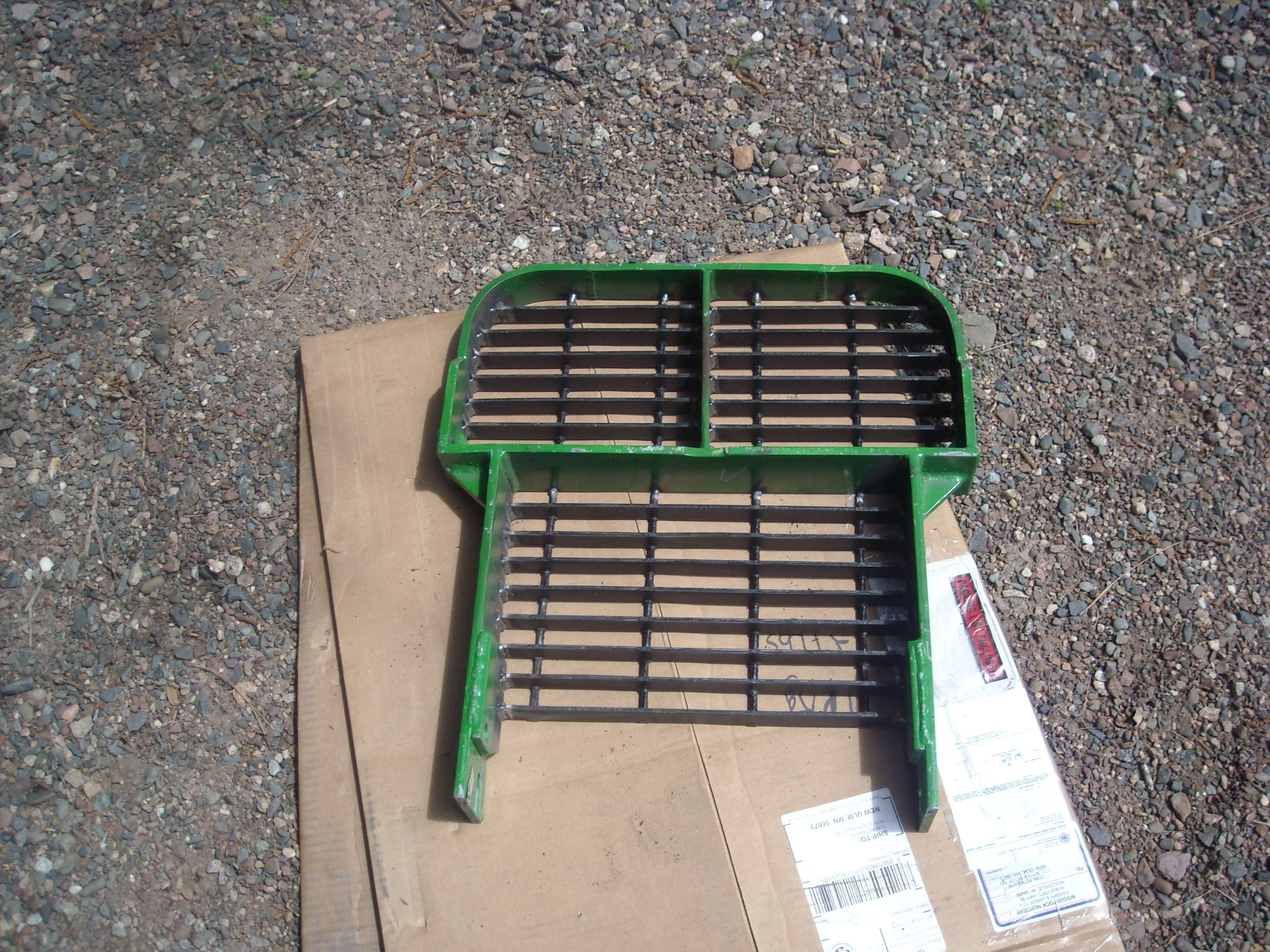

Today I got my make-over grille installed on my tractor. It has the stair grid material welded in... which should prevent further mishaps.r I think the stair tread will protect the grille, hood and headlights pretty well.....and the stuff behind them. This grille guard should be near "bullet proof"....and still lets the air through. Should be ok with my headlights too.....but I dont operate at night too much.
I only wish I wudda done this in the first place....as this grille got pretty expensive with the weight bracket, 1st assembly, 2nd revision. Oh well....if it does the job....it will be worth it. Hoods, headlights and grills aint cheap either.
I straightened my damaged grille (see first post) and blew some paint on it.....now with the new grille guard you can hardly see the damage. (grin)
