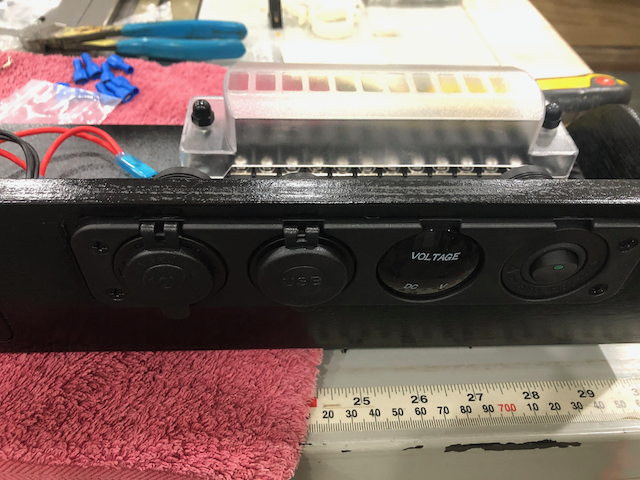

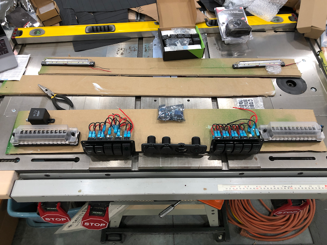

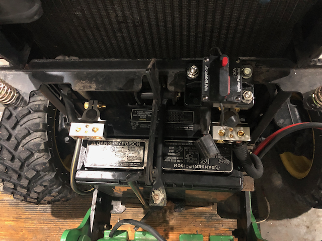

Laying out the dash components to fit in a small space and just large enough to hold the wiring.
Running #4 AWG from the battery as the source.

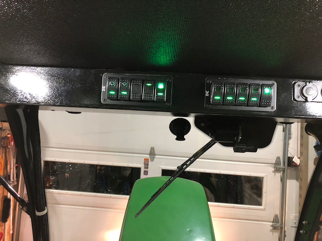

#22

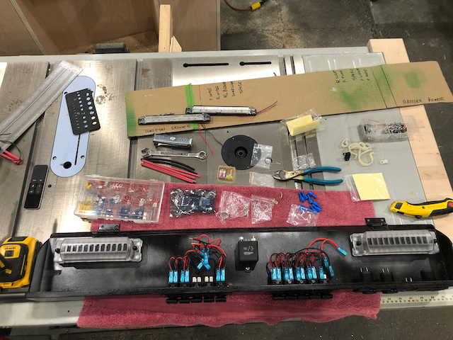

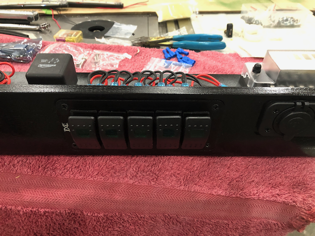

Built the dash, routed the switch holes and painted with 3 coats of Rustoleum premium Gloss Black. Now installing and laying out the components.
Getting ready to wire up.

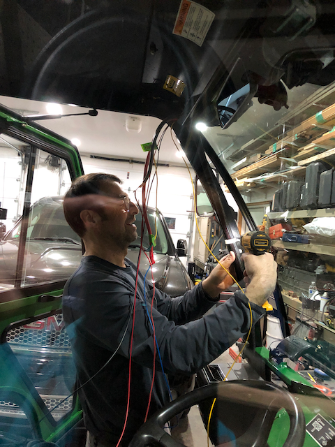

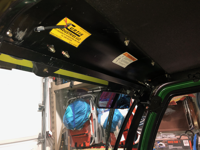

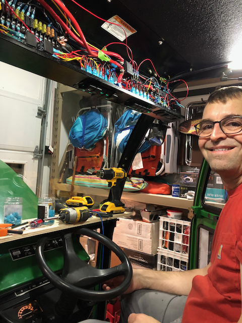

#23
Prepping the cab to run wires and install the dash. Will be hinged for easy access.

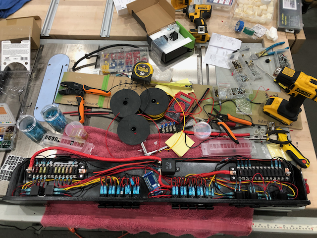

#24
Installing dome lights and running the wiper and light wires in the cab concealing with loom tube.
Finishing top the bench work on the dash wiring using heat shrink connections on switches, relays and timers. Whew!
The big question... Will it all work??? In theory and in the plans it does!

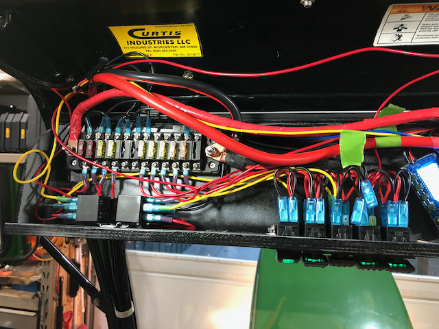

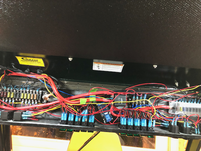

#25

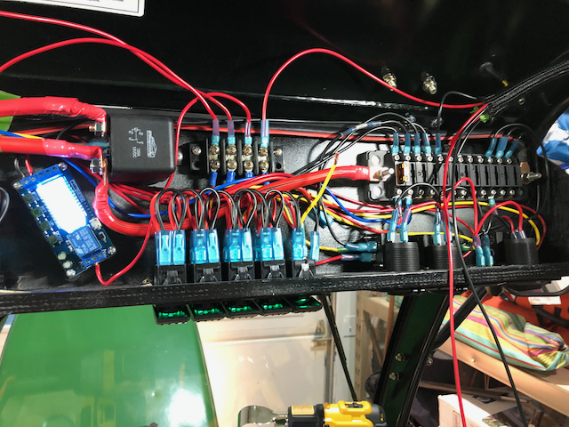

Time to install the dash in the tractor and finish up the connections.
Left side fuse panel is ignition controlled, right side fuse panel is direct to battery. Middle block is dome lights connected to timer and door switches. The timer runs the dome lights for 2 min after the doors are closed.
Powered up, no smoke, no sparks, no buzzing, no popping. Cool!

Final wiring, tucking and fitting today. Ordered a new piano hinge yesterday because the dash is too heavy for only two attach points and 4 screws. Arriving tomorrow so will install and start the big cleanup.
Really pleased with results. Was on for over two hours, all wires and components all stone cold. So glad I learned about relays.
