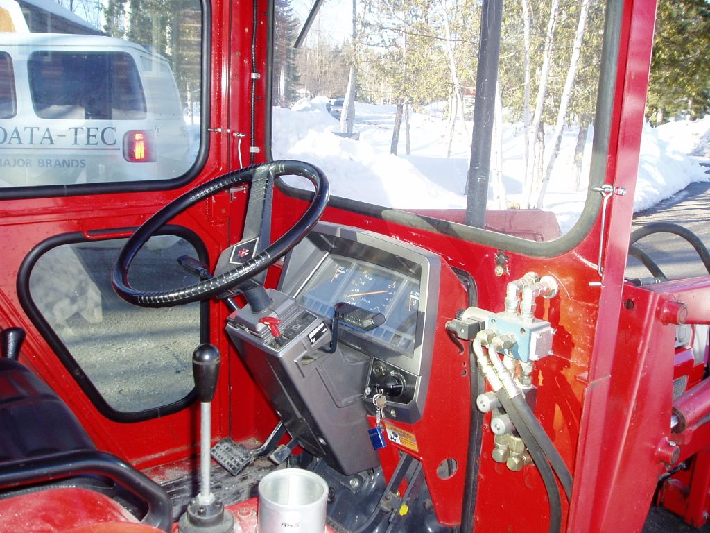

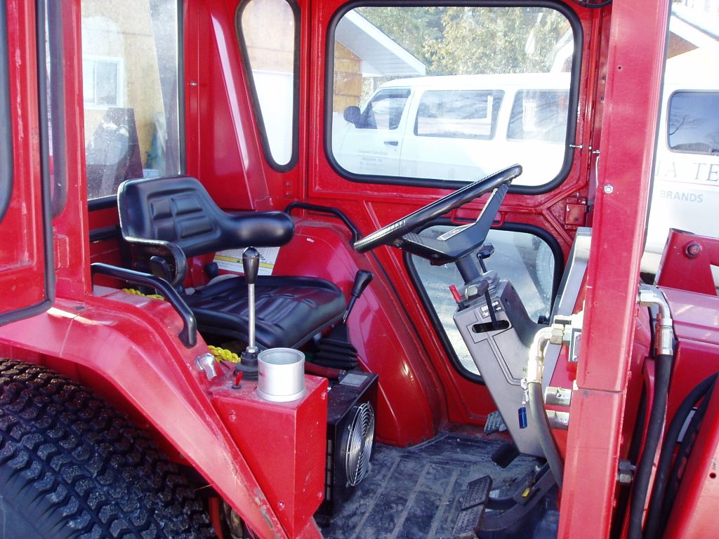

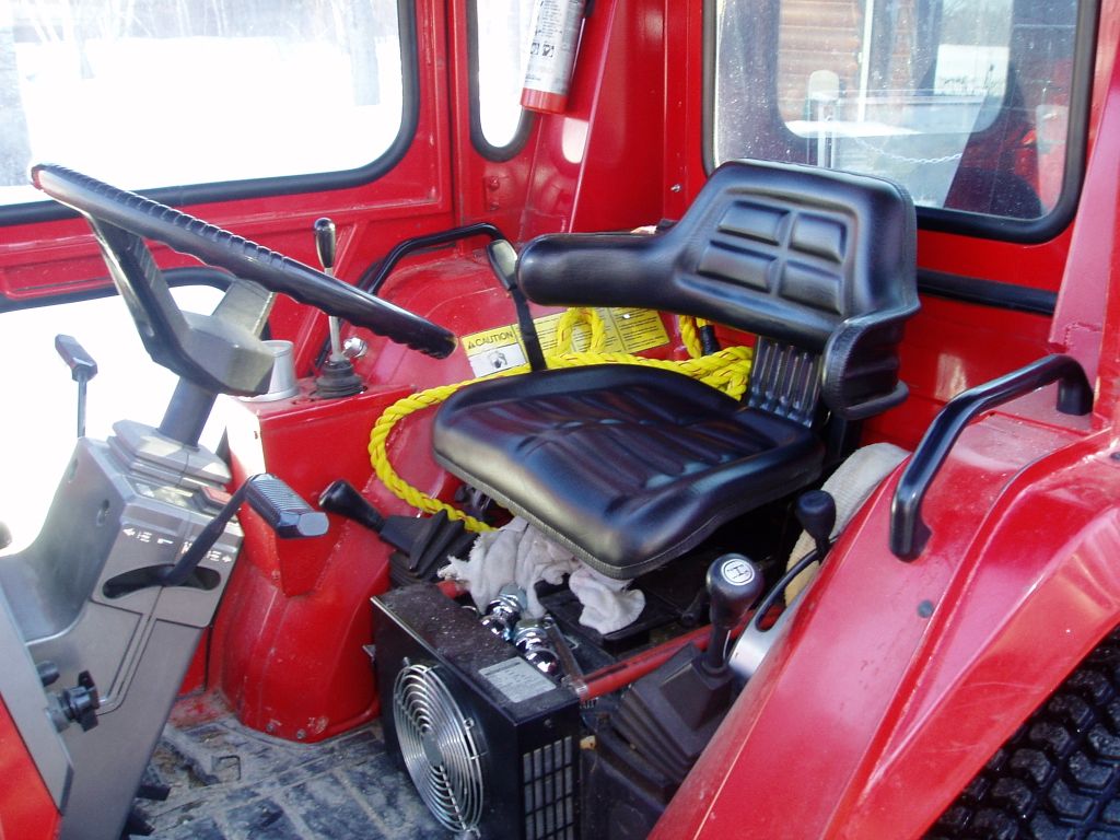

/ Curtis cab #27
This is how I set up controls in my MF 1140 with a Curtis cab.
Ron:licking::licking:

/ Curtis cab #30
Well that looks really good! Great job! My FEL controls are where your heater is and this what I have to relocate somewhere in order to build my cab.
