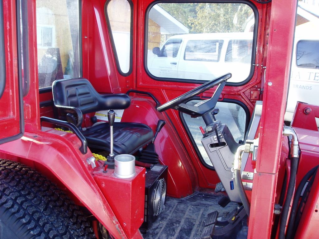

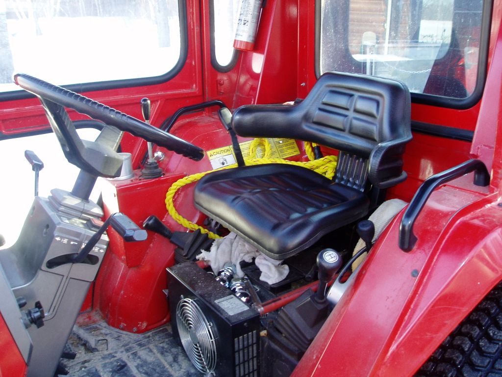

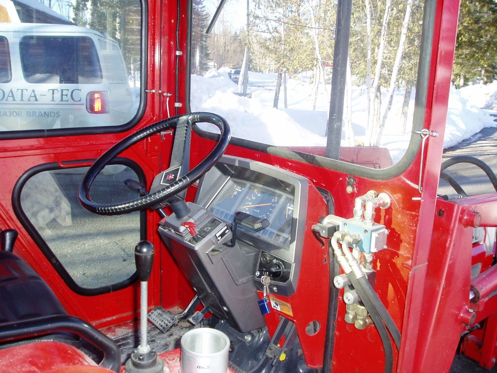

   / Curtis cab #27
This is how I set up controls in my MF 1140 with a Curtis cab.
Ron:licking::licking:

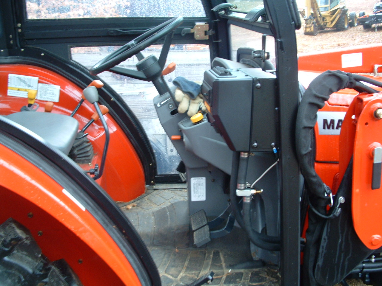

Meanmerc here's the only shot I have of the 1540 cab installation showing the Curtis heater I finally installed last summer. Tell me what you need to see and I'll post pictures.
   / Curtis cab #30
Well that looks really good! Great job! My FEL controls are where your heater is and this what I have to relocate somewhere in order to build my cab.
