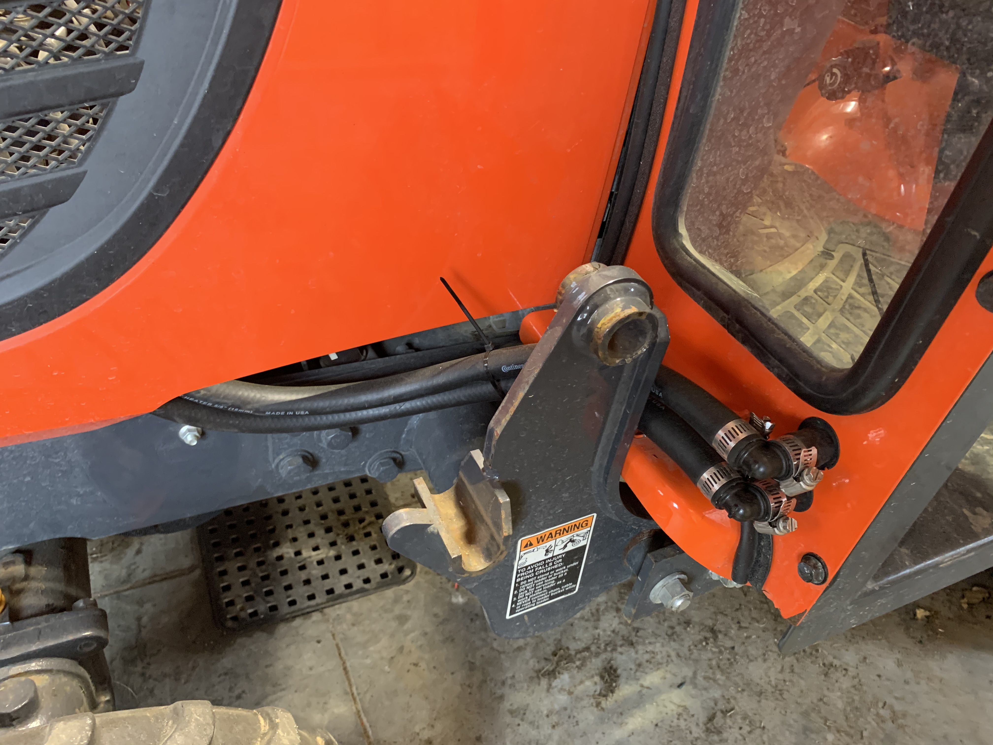

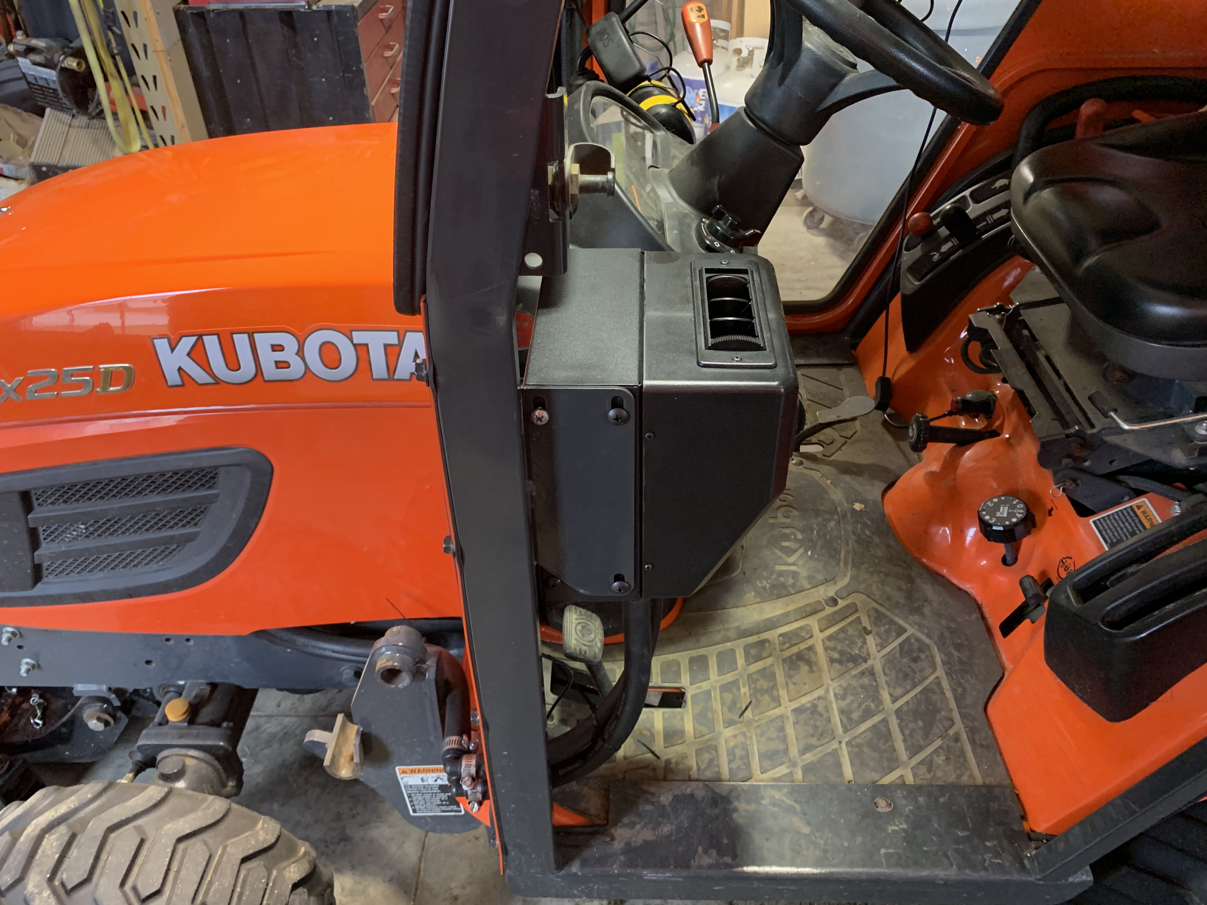

Could you post some pics on how you routed the heater hoses on the driver's side of the tractor? I'm in the middle of installing a heater in the Curtis Cab on my BX25D-1 and it should be similar. I'm good on the passenger side. Thanks!
   / Curtiss Cab BX-24 #13

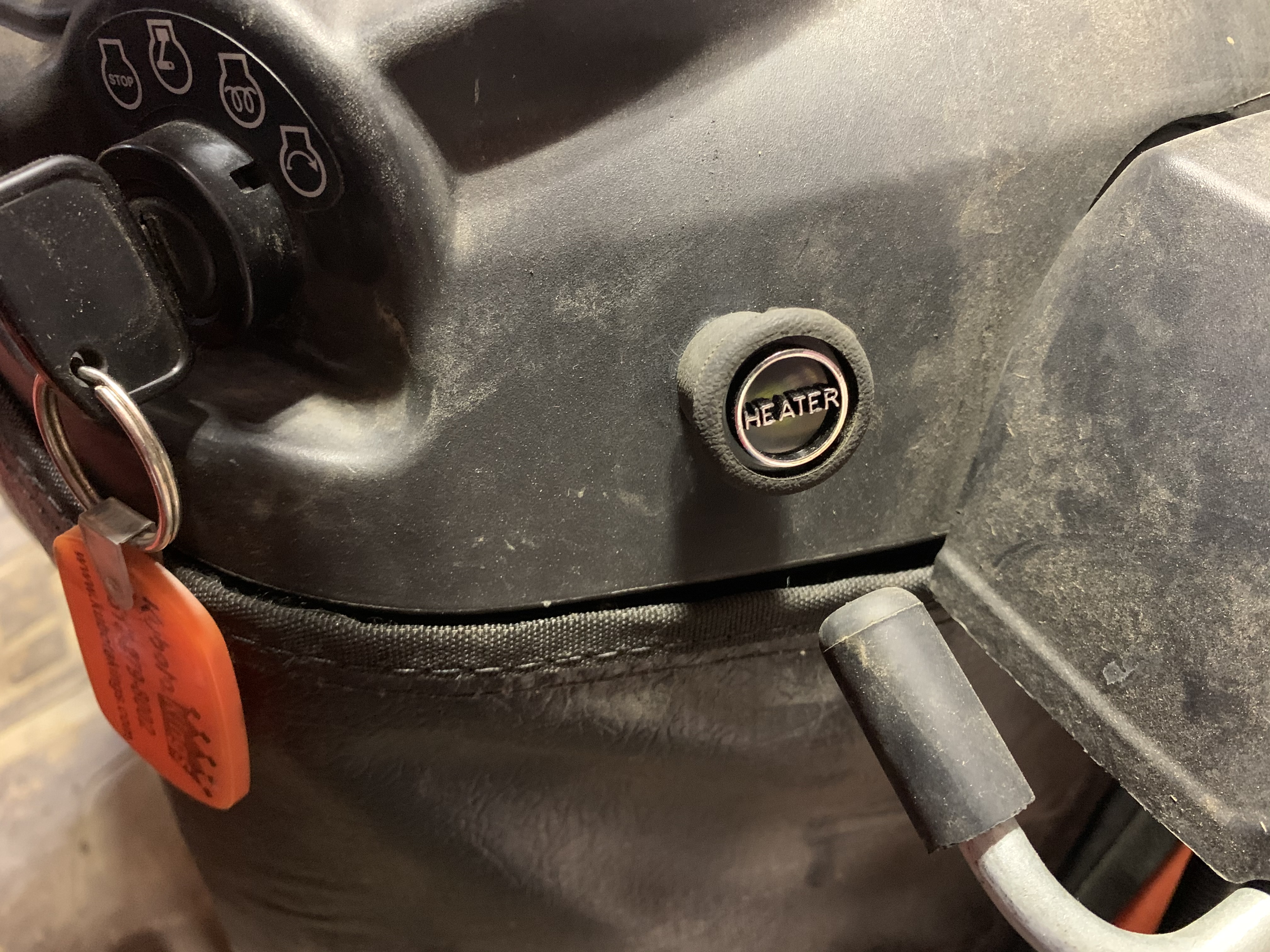

Huge Thank You! To George The Beagle for sending me pics of his Curtis Cab installation on his BX which really helped me install my heater on my BX. It's all done and works! Just need some snow now.
   / Curtiss Cab BX-24 #14
A few pics of my heater installation. Curtis Heater on Curtis Cab on BX25D-1.
