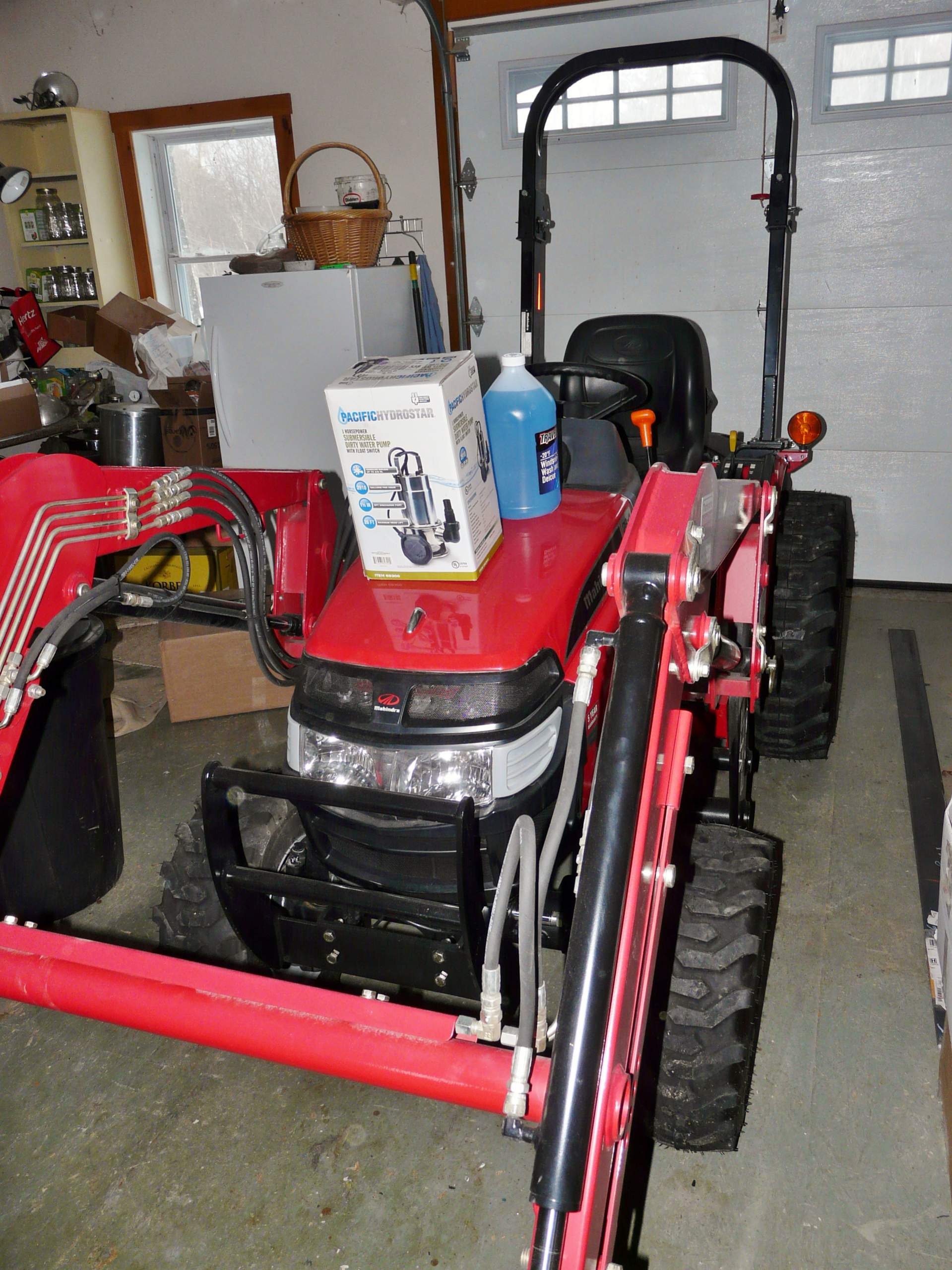

Liquid filled tires to add weight.
Nice modeling work.
Another option for adding weight is to fill the tires. Adding to tires does not put additional load on the bearings, and it does not decrease the 3pt lifting capacity. You can easily adjust the amount of weight. It does not add interference or restrict space to hook up the PTO shaft.
Your use of iMatch type hitch is great, and much safer than standard 3pt. BTW, it is helpful to be able to see the lift pins as you back up to hook up the iMatch. Make sure you can see them.
Look at all weight options before you settle on a path forward.
Yeah, Regarding Liquid filling the tires, I figured that my grandpa's old sump pump I have is going to electrocute me so I went out and got a general purpose 1HP pump.
Also I found the adapters to liquid fill
Quick Fill Tractor Tire Attachment
Amazon.com: Slime 20073 Air & Water Adapter: Automotive
Installing Liquid Ballast in Tires | GEMPLER'S
My Little Kubota B7200 has LF turf tires, Calcium filled tires are sure are heavy for a 30" tall x 12" wide tire
I have the Little Bota up to about 2400 Lbs with Iron on sub frame, a CW and filled tires.
So how do you "easily" add and remove weight from a filled tire?
On our new Max 28 I may load the tires if having 500- 600 lbs of CW is not enough.
The Max 28 tractor's bare weight is 1819 Lbs, Plus loader weight is 627 Lbs.
Add 50 lbs of steel I've had welded to the bucket and the 500 Lb Counter weight plus the operator the total weight is about 3,200 lbs.
Filling the tires would add about 350 lbs. more.
I will fill the tires of the new tractor once I determine if I have enough weight for ground engagement activities.

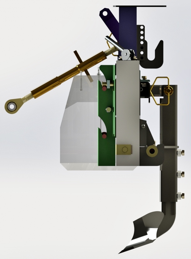

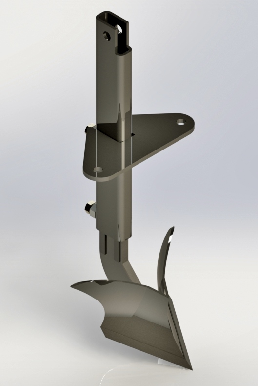

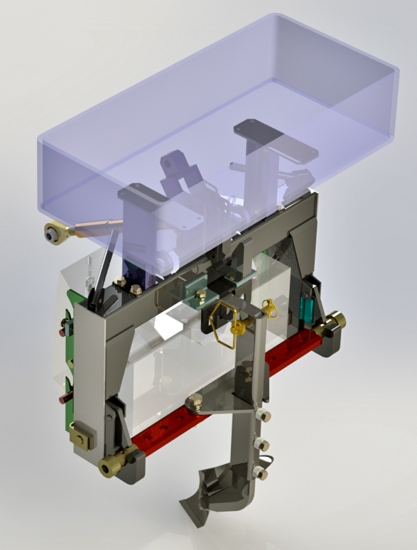

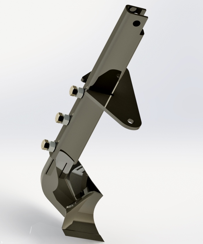

Ordered parts for next Attachement
I picked up a High Carbon Steel Plow Furrower, 11 In. x 1/4 In. along with a pair of box blade shanks to make my own Middle buster and ripper attachment.
I don't think I'll save any money building my own, but it will be more sturdy and adjustable than the inexpensive types currently sold plus it will not take up a lot of room in the barn.
Attached is the basic design.
I want to add a pair of small boxes, (maybe Ammo Boxes) for chain storage atop the concrete counter weight straddling the top link and have it designed so that the boxes are Quick Release, because I do not want to have to unbolt the boxes when I drop the Quick Release counter weight. Having to unbolt the box would defeat the purpose of the QA.
Anyone have any inexpensive way to do this, like some slick latches at a reasonable cost?
The same goes for the plastic box tool carrier shown on top of the bracket pedestals of the QA hitch. I壇 like this to be an easy on/off arrangement without bolts.
I have solutions, but they are too expensive.
