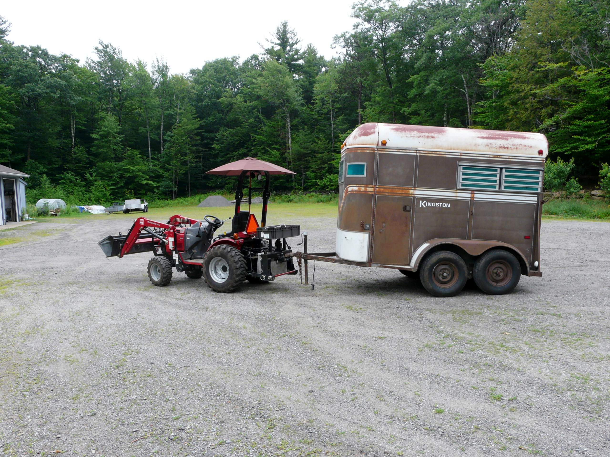

In addition to its basic function as a 3PT Quick Hitch, it is a:
Counterweight
Lift with Chain Hooks for skidding logs
2" Receiver D Ring for Tow Strap
2" Receiver Adjustable Drop and Raise Ball Hitch
Two 50 Cal Ammo Cans with quick release toggle latches
HD Plastic 32”L x 15” W x 7-1/2 Tall Carry box.
Ripper attachment
Middle Buster Attachment
Hopefully I've also addressed some of the shortcomings of the QA hitch by making it fit Implements with clevis style hitch points and by beefing up the pin bosses so the holes won't get beat out from hard usage and vibration.

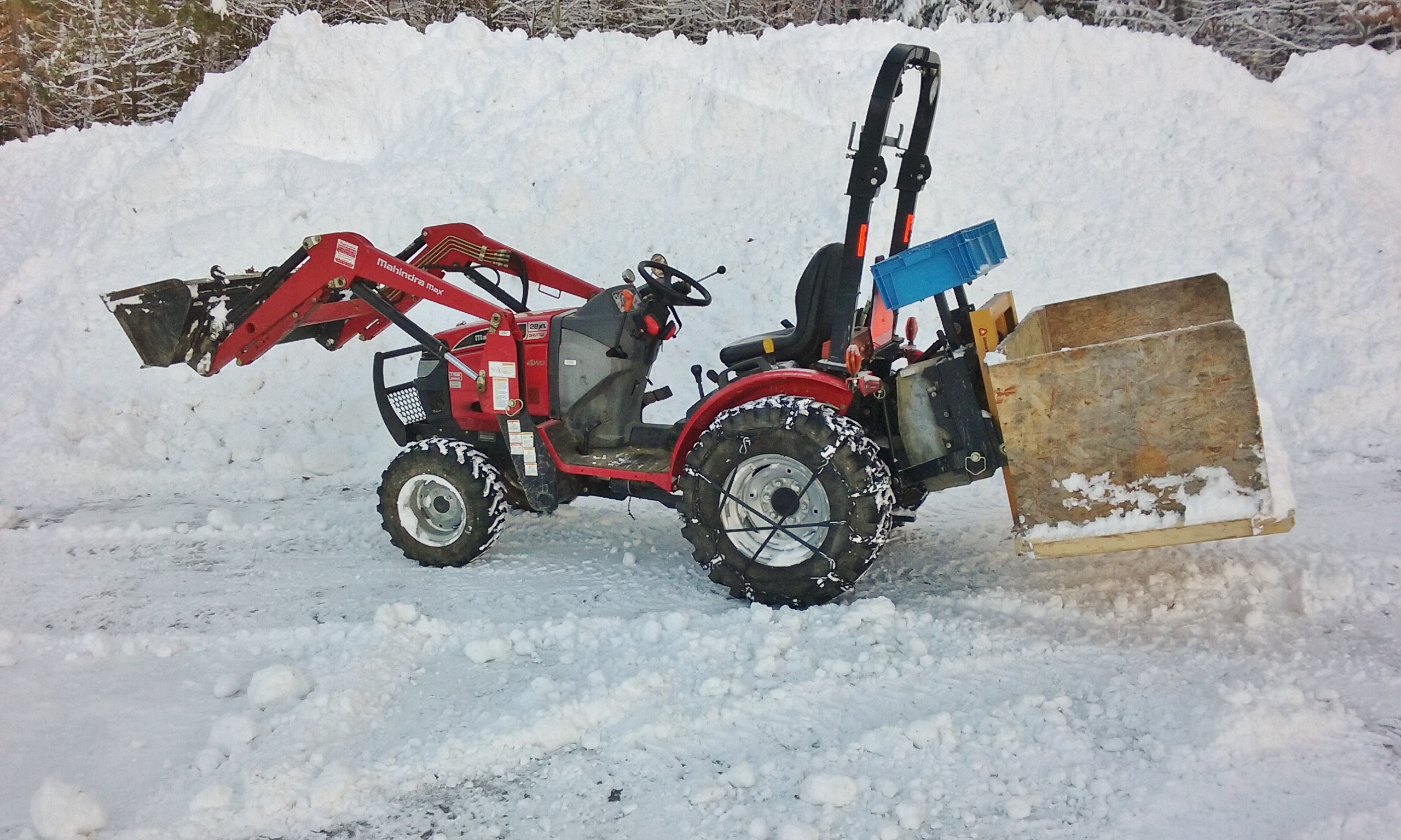

Update::Custom Qick Hitch 3pt. attachment 2" reciever, Weight Box, Tool Carrier, Plow
Well its been on the tractor a while.. Even a near 500 Lb Counter weight is not quite enough. When I take the weight off to do some field mowing, I'm goint to add another 125 Lbs by casting an additionll 3" of concrete filled with steel scrap tp the bottom of the weight.
Other than that it works great, as long as I back up level and straight on center when hooking up stuff. That tool carrier sort of blocka my line of sight in some spots.
I have not tried the ripper /middle buster attachment yet.
If I was to do this over again I'd make the plastic box handy dandy tool carrier a quick release deal so I could easily take it off when backing up to hook up my attachements. The tool carrier box blocks my view and is a makes hooking up PTO driveshaft kind of a pain. A wire basket is another thought but would still hinder hooking up the driveshaft.
I'd also add about an inch more clearance betwwen the counter weight and the Qucik hitch, and make up for the loss of weight by extending the bottom of the counter weight about 3".
You have to back up just right for it to drop in /out. If you do it right, slow and careful, it really works slick. At night, in the dark, tired, & hungry, not so much. Getting the near 500 LB Iron filled concrete counter weight stuck in the quick hitch is no fun.
With my modifications to the quick hitch pick up points all my implements fit nice.
I can attach an International Ag. HD 4' rotary cutter, a 5' wide power tiller, a Land pride BB2472 BB, A land Pride 1572 rake, a 4' wide harrow, a material handler platform 62" W x 35" D with removeable sides, a potato plow/middle busster, and a spiked rotary drum plug airator.
The 3 Pt hitch on the Max28 is very strong for a tiny tractor.

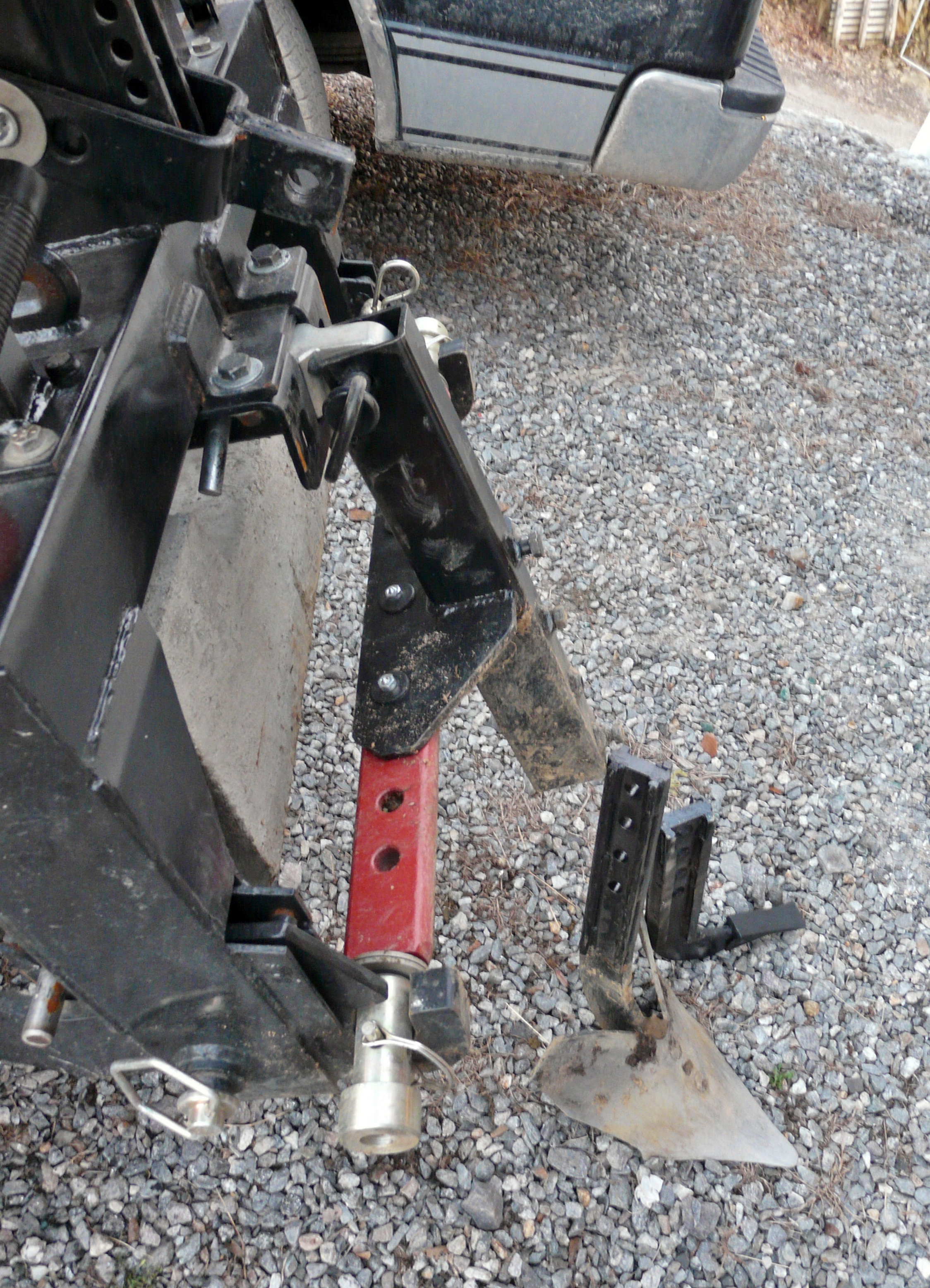

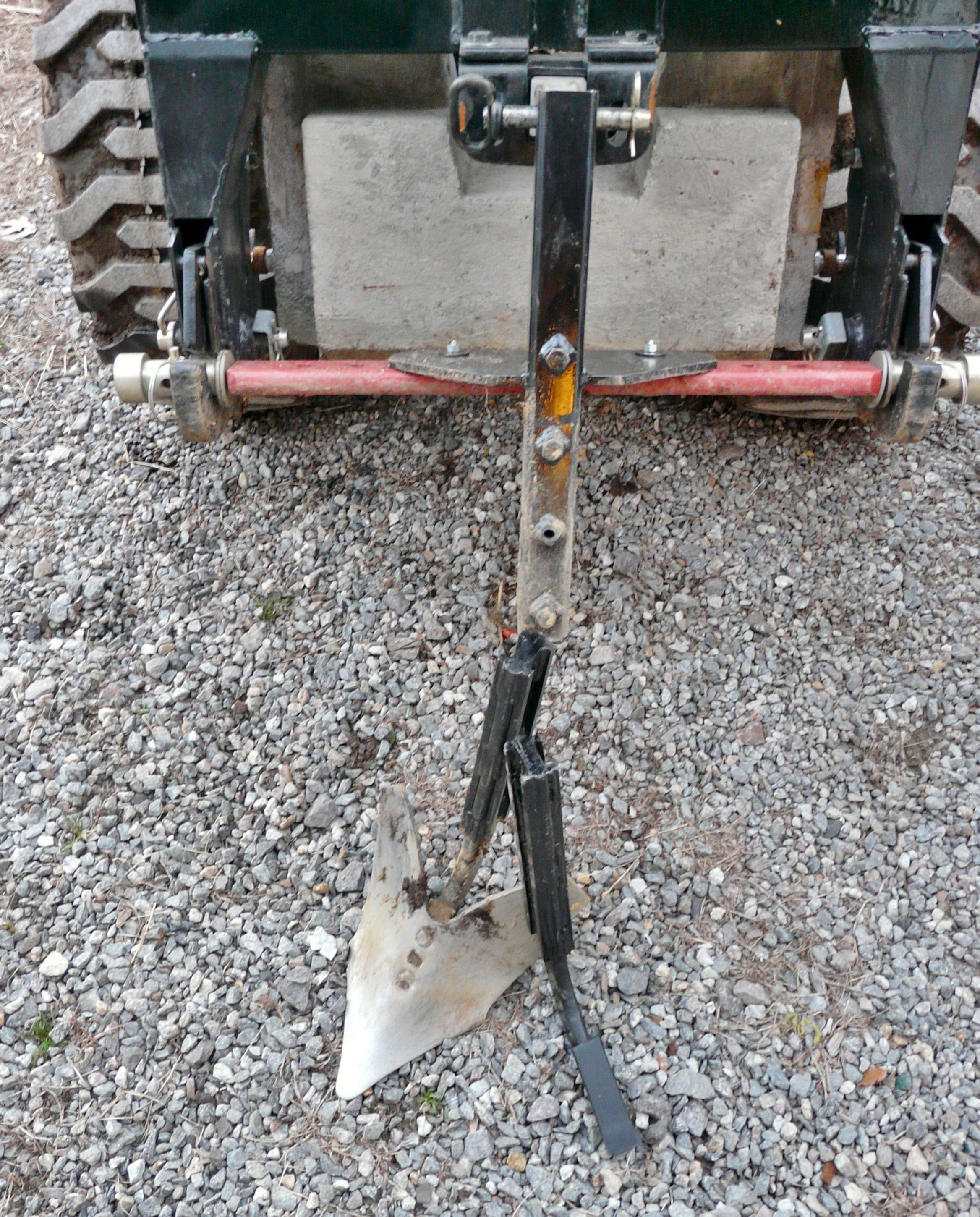

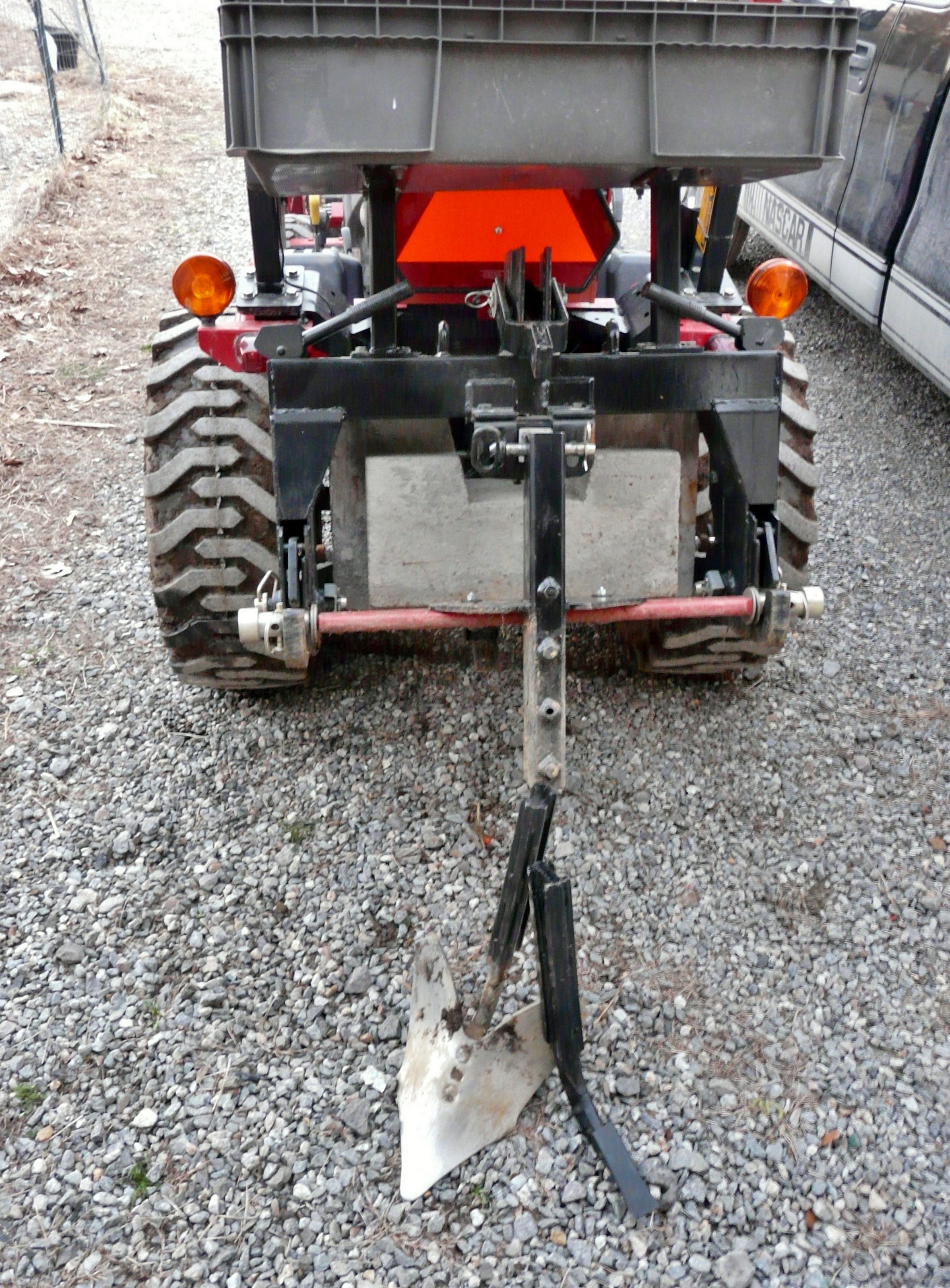

Custom 3 point a 2" reciever, Plow, Weight Box, Tool Carrier/work table, Etc, Etc.
This is the first time I used my self made Plow/ Ripper. The plow worked so well breaking virgin ground that I did not need to use the ripper.
Life is good not having to hitch up the Oxen.
Note: I used snow blower shear bolts, with internal bushings just in case I found an immoveable object.
The plow lifted out a 200 lb Rock.
The Max28 shuttle at 3,000 Lbs was just the right weight. Heavy enough to get some traction, light enough it would not disappear in the soft ground. It is also maneuverable.
All my other attachments fit my modified quick hitch well.
