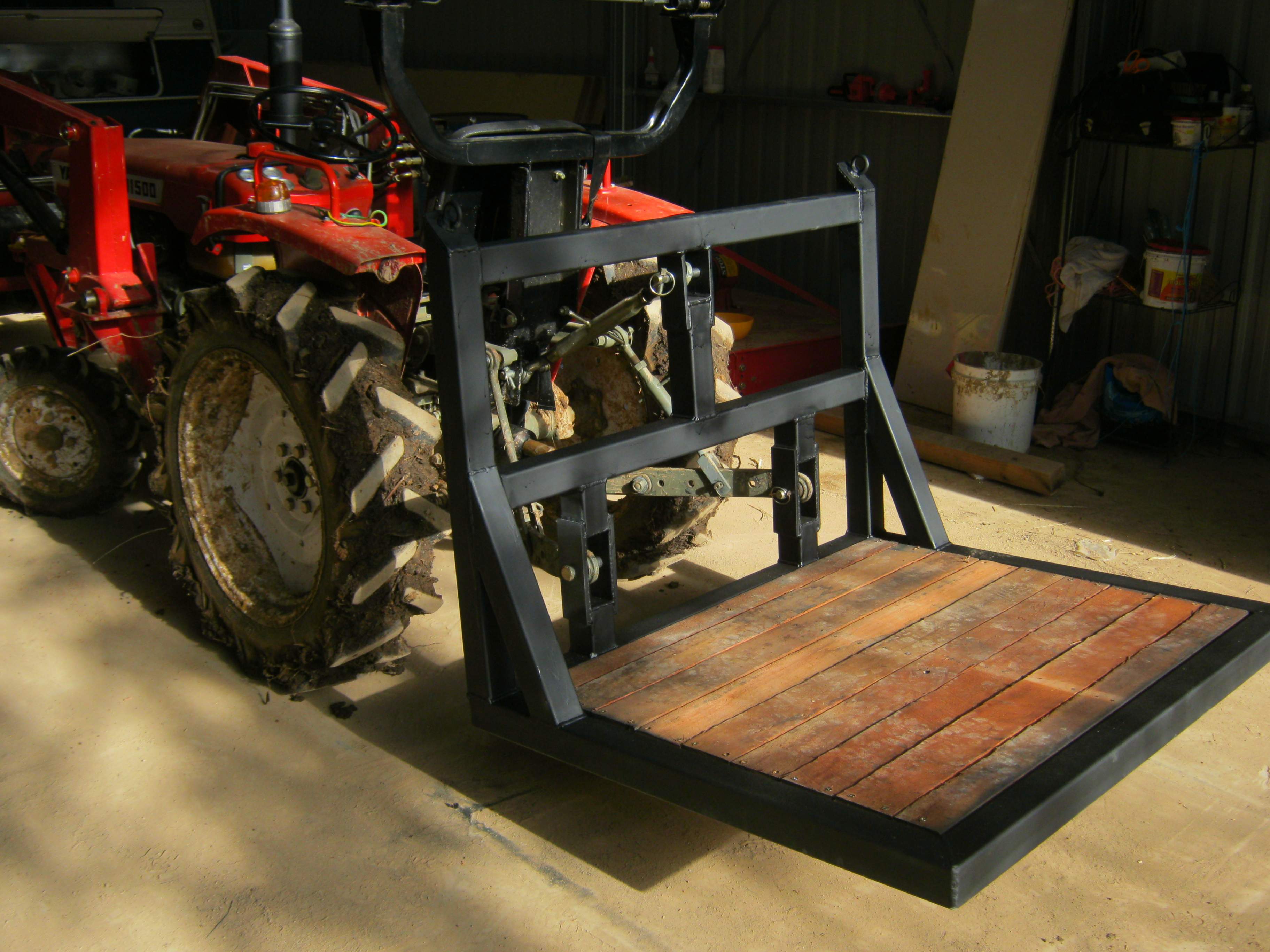

"BTW---As you can see in my last post that my ROP is down to get tractor under shop roof-----well me head got to the ROP real well while workin on the carry all "
I have the same problem. Wind up with lumps on my head every time I have to remove/replace the three-point gear for the backhoe....

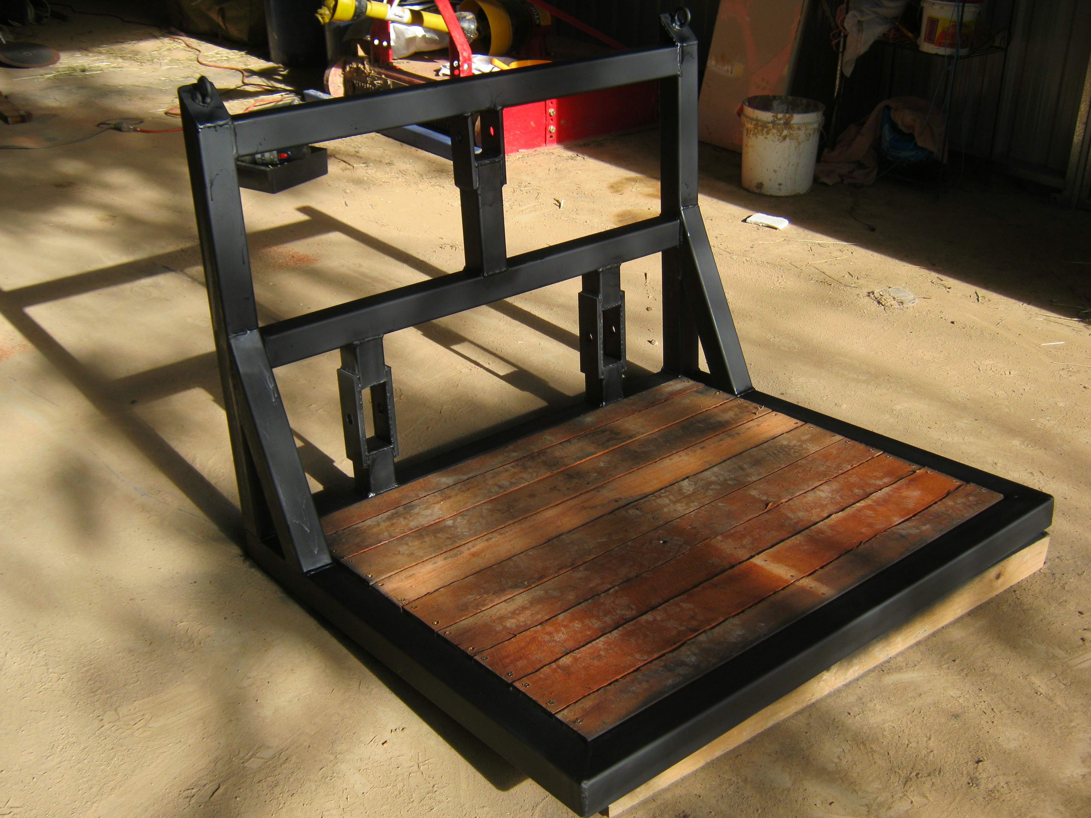

By the way, the metal side stakes are just fabbed up from two sizes of square steel tube nested together.

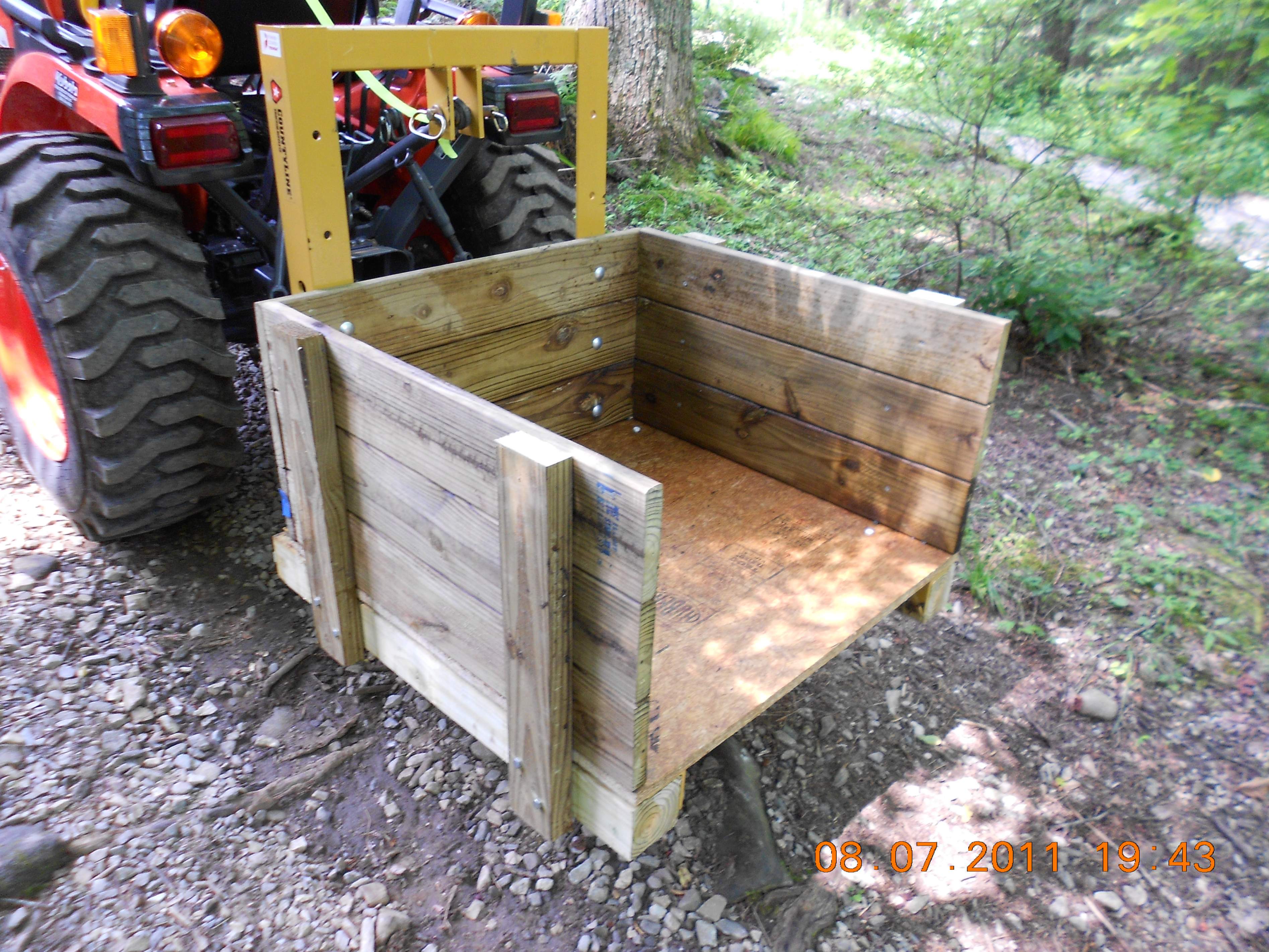

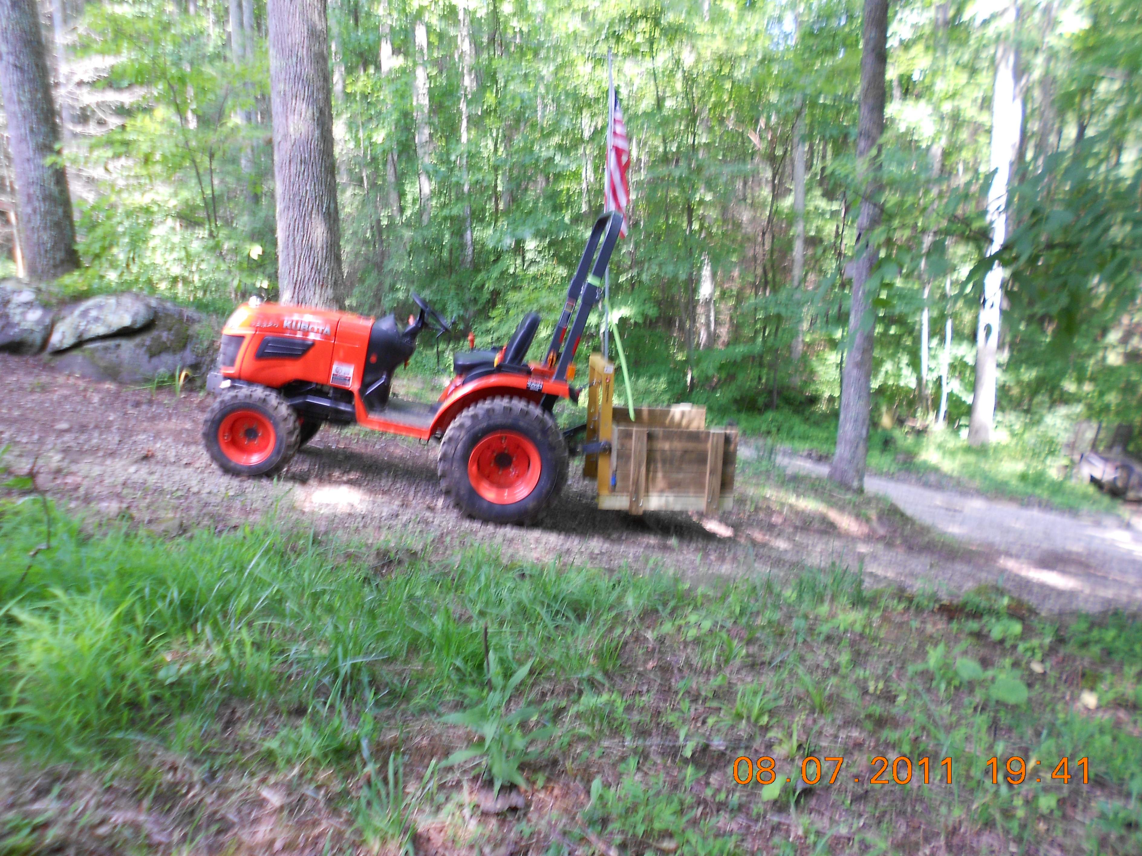

Well here it is---not really finished yet as I need to test it out first
This will give ya a idea how steep my roads are
So I went down the road----loaded some gravel----little less than 1/2 full---& kept the load close to the 3 point hitch---the front end was very loose and I decieded to take some of before I went up the last hill.
So I need some weights on the front now-----don't know how much 150# is gonna help----guess I will find that out soon as I add some weights.:D

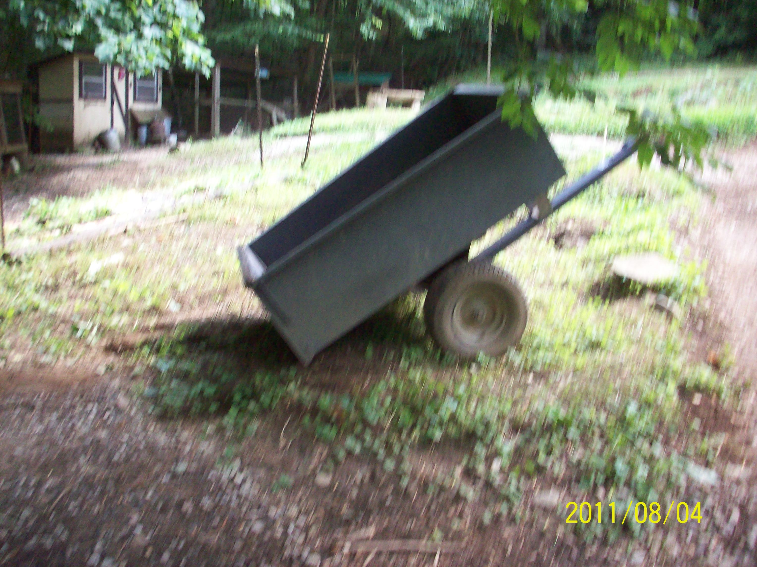

Has anyone made some sort of low sided box for this carry all?????( preferly with wood)
I am thinkin bout mounting this old trailer on to it----but really don't like the idea :(
I've been thinking of the carryall and mounting a trailer like you have on it- without the wheels. I figured two 45 degree 2x4's on the carry all with brackets for the trailer axle. Take the tongue off the trailer and mount some stops for the trailer to sit on on the verticals of the carryall. Use a pin for the release. Tip the carryall and you have a gravity dump body.
I've got a FEL on the tractor. I'm putting a snow blade on the bucket. But I need something to carry and dump the horse manure when I clean the barn during the winter time.
