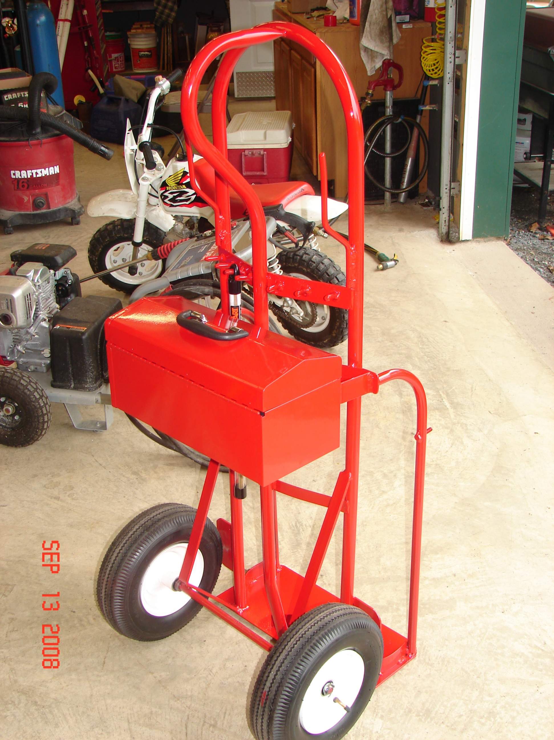

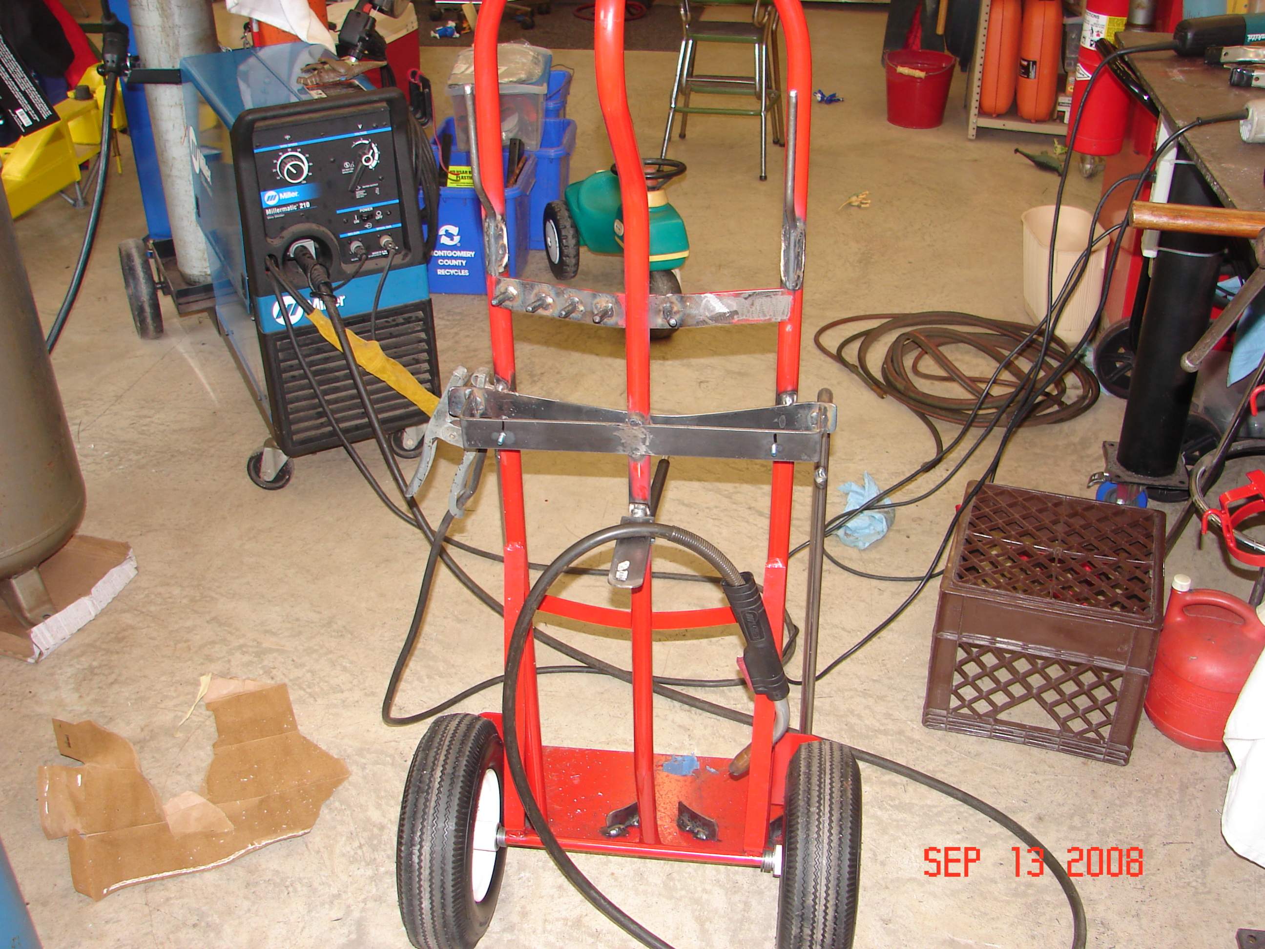

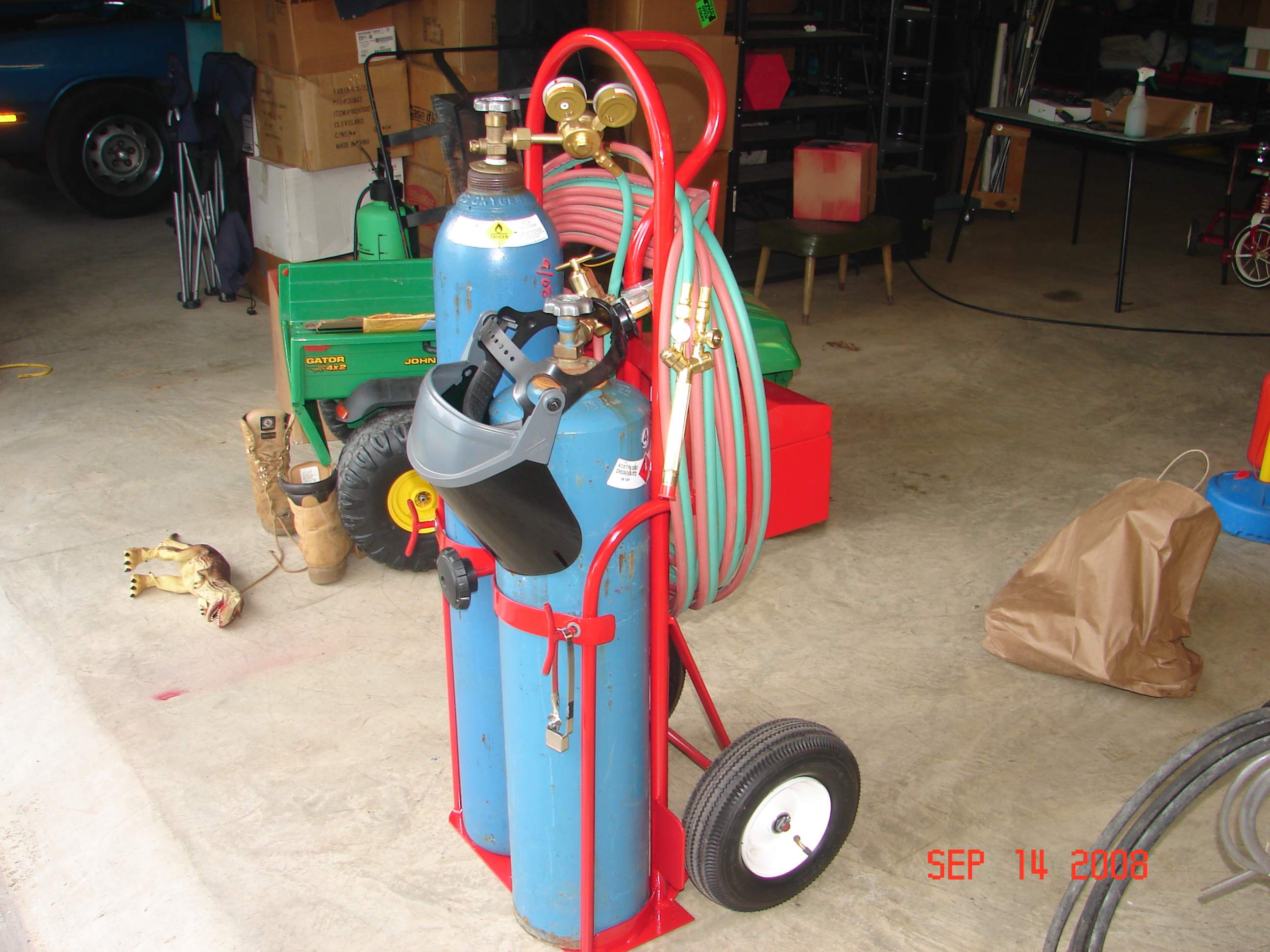

Here is a cart I made out of a hand truck I had.
Bill

   / Custom cart for oxygen & acetylene tanks. #13
That is perfect in my book Bill. Nice job. j

Bill,
Nice job on the cart. Hope you don't mind, but I'd like to borrow a couple of your ideas.
Nice looking tractor in the background of the first pic. Make sure you do a thread when you build a loader for that thing!! :D
Mike

Hey Bill That's very nice! :D
You really did a great job..... I also like how you added the tool box.
Since the metal on the hand-trucks is kind of thin & hollow... Did you burn any holes in it when you was welding ?
Thanks for the pictures!

Thanks for the compliments I appreciate it. In answer to the question of burning throught the hand truck metal; I had no issues at all.
Again thanks,
Bill
