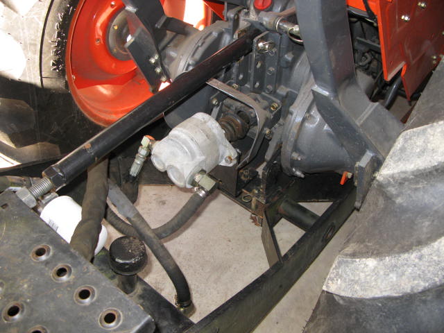

Hi dfkrug;
I have a kubota 3710 with a woods 9000 that runs off a woods pto pump which is rated @ 3.8 cubic inches. The manual says it requires 8-10 gpm @ 2400 psi. I guess about the same as yours.
Your tractor will do 7.8GPM at PTO speed, and your PTO pump puts out
8.9 at that speed (540). 8 GPM is likely to be faster than you want to
operate that hoe, so you are fine. Your design criteria should be similar
to mine if your solenoid valve is a 2-way valve for parallel operation. If
you go with a dual solenoid full diverter setup (4-way), I suggest you get
one to accommodate the 8+ GPM it might experience. BTW, there are a
bunch of those latter valves shown on various TBN grapple bucket
projects. Unfortunately they tend to be large valves and often require you
buy a manifold (base plate).

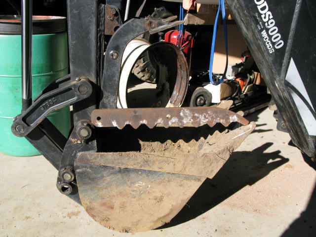

This is an old thread, but I have a newer tractor, and one with a mechanical thumb on a BH77. Giving Dave credit, I shamelessly copied his idea on paralleling the curl cylinder. Works great! (thanks Dave). Here's some pictures and notes:
I used this 2 X 20 cylinder as it has adjustable port positions which I thought good in this app. http://www.baileynet.com/product/19560
Close up of Hydraforce solenoid valve. Had to special order from one of their distributors - they wouldn't sell direct. I had to use two fittings to attach it to cylinder as the SAE 8 to 6 90* was out of stock - When I get it, I'll remount and also install a bracket for the valve - it is probably sturdy enough if you don't bonk it.
Taken before wiring Solenoid.
I wanted the waterproof push button switch on the joystick. Switch from Amazon, aluminum bracket from my little machine shop.
Finished switch install, shrink wrap on joystick shaft to keep it clean.
I used a Powerlet jack and plug (also referred to as Bosch or BMW plugs - and may be still sold by JD dealers) to plug into the tractor's 12VDC. One neat "happy" was that Kubota, on the B50 series, supplies a wired plug end at the left rear of the tractor AND the plug is a match for the Powerlet waterproof outlet - - how cool is that?!
http://www.powerlet.com/shop-by-product/plugs-sockets-wire-more/PWRDIST
One little "oops" occurred at the rod end of the cylinder. I needed about .360 more width, so made two .180" spacers. However, once installed, the ram end didn't end up on the pin centered - - took both spacers on one side (shown) to fit up nicely - guess this is due to a slight misalignment on the dipper stick bracket from the factory.
There was probably enough slack between the 25mm pins and the 1 inch cylinder end holes so the ram would have centered, but I used .012" brass shim stock to make bushings which took most all the slop out.
Tested it picking up a big rock - works great! And no more having to get off the tractor to deploy or put away the thumb.

The 2 X 20 cylinder I used, while having the correct stroke (10") for my app, is overall about 2" too short on the BH77, which has a welded on bracket for the manual thumb. i.e. with thumb fully retracted there's a couple of inches or rod still extended. And with ram extended fully, thumb is extended, certainly a usable amount, but not quite all the way (probably could go another 2". Works, but it could be better.
So, when I get the time, I plan to saw off the upper cylinder tube and weld in a spacer. It'll also give me the opportunity to correct the ram positioning issue (both spacers now on one side of ram as upper bracket is apparently not quite square with dipper). I'll weld the spacer to the cylinder first, then tack weld the spacer to its tube with cylinder mounted on the hoe - so I can get the alignment right.
