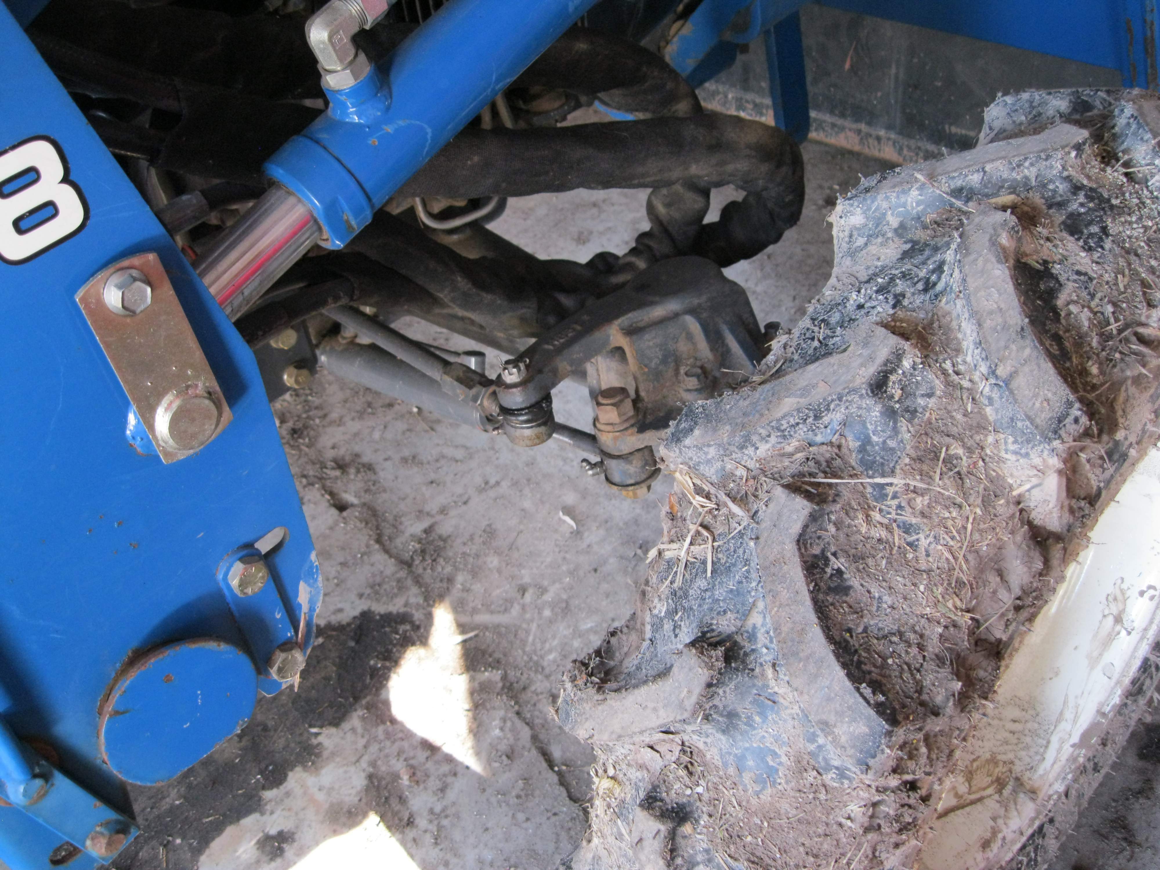

Hello friends,
I farm vegetables with a New Holland 1925. After much research I recently had help customizing my rims and tires to allow me the correct width to straddle a growing bed. The ag tires are now 5ft. on center, and the tires are slightly larger than the ags recommended for the tractor (necessary to accomodate these particular rims), which give higher clearance. Great. But when I got them on and tore out of the garage I found that a tight turn rubs the front tire against the upright of the loader. Not great, especially since that upright corner is very sharp and almost punctured the tire before I noticed it.
It's very close (in fact it doesn't look at all like it would rub -- seems like an inch or so in either direction would clear it) and so I cut out the sharp corner of the loader upright. Still hits it. Now, I'm not sure what to do. I invested a lot in these rims and tires, and can't go out any further with spacers (or get narrower). I'm wondering if I fiddled around with the toe in to see if that'll clear it? Any other ideas?

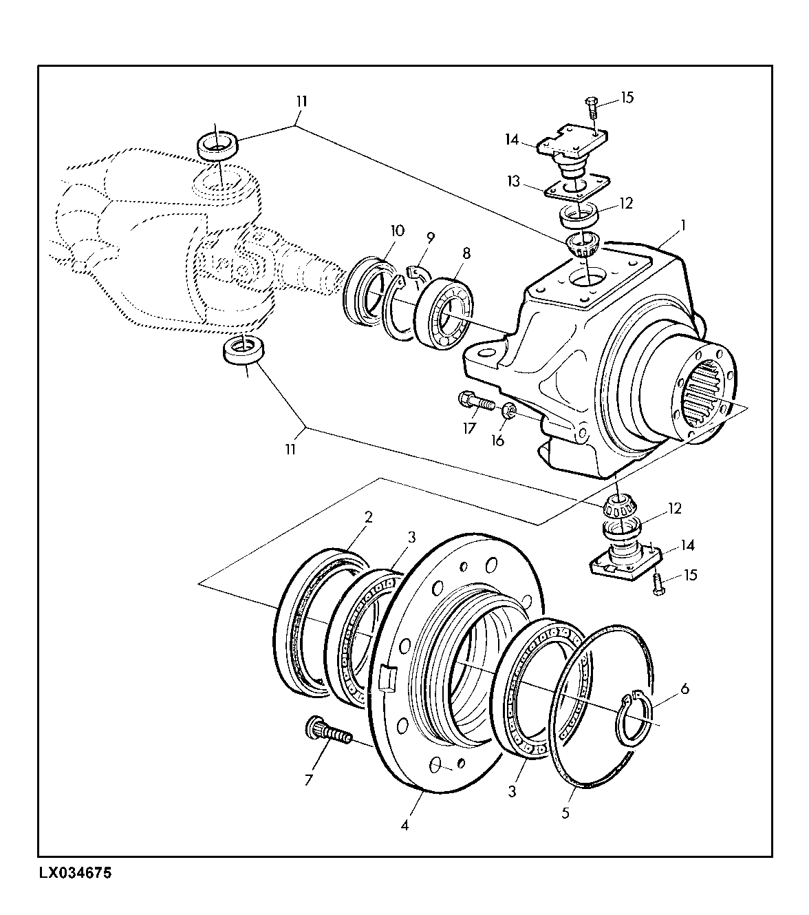

Does your axle have steering stops you can adjust?
/ Custom tire width issue
The people helping me with the tires recommended steering stops. What do these look like or entail? Would it be a big job to install such stops? They are not ideal, as I have lots of tight spaces and need my turning radius, but that would be better than nothing.
In the above pic you should be able to see the mud on the loader upright indicating just where the wheel is rubbing. Not much, but I was also trying to check my own steering.
On my tractor the knuckles have a bolt and a locking nut for steering stops. Key 16 & 17 in the picture
/ Custom tire width issue #8
Yep, just adjust the steering stops out and re-tighten the jam nut. Or remove the loader and brackets.

Thanks all -- That was my next question: I adjust the bolt out, not in? They are seized up quite a bit, but I got one loose and adjusted it in 5 mm. No effect. So, once I get the other one moving I should take them both out, so they are longer?
Jeff
/ Custom tire width issue #10
Yes you want the bolt to hit the jam on the steering knuckle before the tire hits the FEL frame.

Thanks for the continued help on this. Thanks to your help, I now understand the issue a bit more, but still am trying to get to the bottom of it: The jam which the bolt should hit is so far away from the bolt end that it would seemingly take an extremely tight turn to get near it. Long before it would get to that point, the wheel rubs against the loader upright. Though my turning radius would be greatly reduced, stopping the turn just at the point of wheel-to-loader contact still gives me enough to get around.
Also perhaps relevant is the fact that there is a mark where the bolt must have hit the jam at some point in the past, with a past owner. But that mark does not seem to be aligned with the current bolt placement?
Thinking I just needed a longer bolt, I got two (75mm) and put them in. Because they are just 10mm bolts I suspected they would bend or snap off. They did bend as soon as they hit the jam. The jam seems to be at an angle; the bolt doesn't hit it straight on.
So now a question: are there bolts of this size that might be hardened to the point that they would not bend? Why would the current bolt be so far from the jam? Because I use the loader daily, I can't really take it off, and so am hoping for the bolt fix. I can use the tractor now (and will be needing to use it a lot soon, if winter ever ends!) but cannot stay constantly focused on not turning the wheel too far -- I'll probably ruin the wheels, or worse, in no time. Note: the bolt in the attached pic is the old, shorter bolt.

[1] Once you recognize the bolt length required, raise the front end and turn the wheels till the bolt head contacts the 'pad' to see what the angle diff is. Square up the pad to match with a hand grinder, repaint.
[2] Look for '10.9' on a metric bolt head to get the strongest one commonly available. If it bends or breaks, repeat '[1]'. (Final grind angle will differ according to bolt length/adjustment.)

IMHO as long as the loader frame isn't "snagging" and trying to tear the lugs off the tire, I would just let it rub. it will cause additional wear on the tires but you won't lose as much steering. my next idea would be to move the loader back/up and away from the axle. but that could cause other issues.

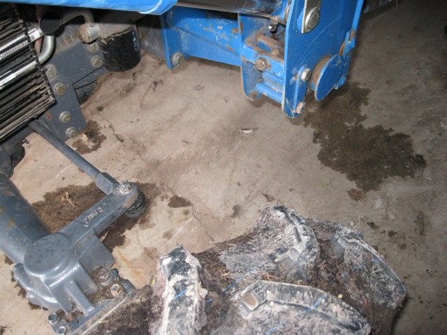

Because I like this spacing, I like your idea, CliffordK, of making some more permanent modifications so that I don't have to worry about bolts snapping, etc.
A few questions though, considering I am a novice who can't weld and doesn't have a lot of tools:
I did cut off the sharp corner of the loader, because it seemed like I only needed an inch or so. Seems like I still need just an inch or so.
Because I'm so close, I like the idea of swapping the rear mounts. It would definitely interfere with the clutch though. What is involved in "rebuilding the clutch not to rub?" Also, it looks like I wouldn't have to redrill the front mounts?

For the interference issue, check the worst case situation as the axle pivots up/down over terrain. If it doesnt hit on the flat land it may be tolerable at worst case if you remove as much metal as possible and smooth the edges and are careful to watch the inside wheel as you turn. Also, when youre not in 4wd the independent brakes can sharpen a turn a little tighter than the fronts are actually turned. This could make up some for setting the stops out a bit.

There may be a couple of axle mounts (front and rear?), but you should be able to cut an inch or so spacer or spacers out of solid steel or solid aluminum.
The tilt stops above the axle would have to be extended. You might be able to make a bolt-on stop, but I'd probably just weld it on.
You can do some welding? Right?
Check the brakes. It didn't look like mine would rub if one reversed the rear bucket mounts. But, it might depend on wear and condition. You wouldn't want anything blocking them in an emergency.
The clutch pedal would either require removing and bending it, (Forge?), or cutting and welding on a straighter bar.
From your photo of the tire, it doesn't look like it should rub at all. But, obviously when you turn, the tire goes through an arc in which the furthest back spot is probably near the bucket mounts. The axle spacers would make this worse, with the arc moving further forward/back.
I'd encourage taking the front end loader off, jacking up the tractor and putting it on blocks. Or however you want to do it. Tilting the axle to 100%. Then turning the front wheel to observe the angle it goes through, as well as any other potential rub points.
No sense in doing custom mods to gain 1" or 2" only to find that the wheel goes through an arc which would still cause it to rub.

Based on this picture, As CliffordK said, take the loader off and try turning the wheels. You may find that with full-lock turning your tires still hit the loader mount, nevermind the loader upright. If it still hits the mount, pull the core out of the valve and with help squish the tire in past the mount to see how far it will actually go. No point modifying the upright only to still hit the mount.
The problem you are dealing with is called "scrub radius" which is the distance between the center of the contact patch of the tire to a line drawn thru the kingpins. Scrub radius - Wikipedia, the free encyclopedia Wheel spacers greatly increase this distance as you've discovered.
Is it possible that a wider axle from the next size large machine could be swapped in which would reduce the scrub radius back closer to stock?
How wide are the spacers (or chance in rim offset) you've added?
