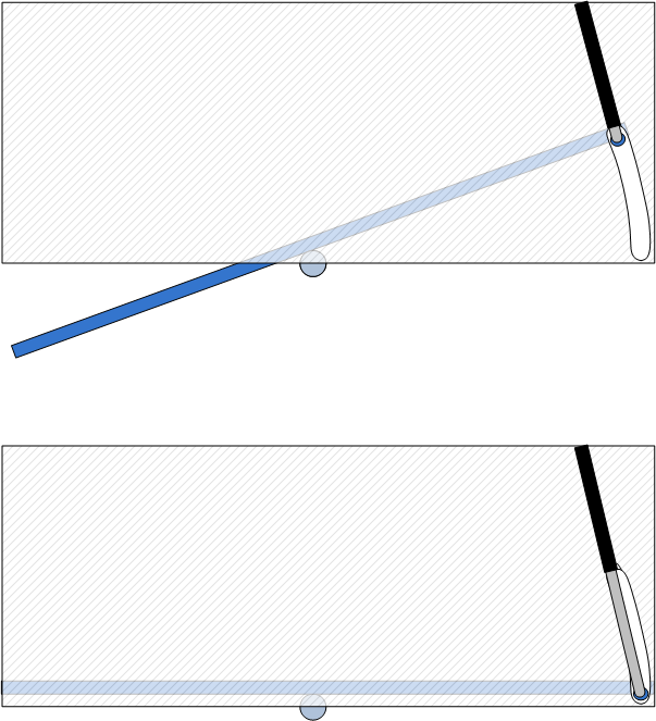

What if you made a tilt deck similar to this one with a vertical cylinder (or cylinders) in the front corners to lift it up?
You could add a flip up front with a pair of cylinders up there if you needed a longer ramp or something to restrain your chair.
Speaking of which, how are you planning to planning to keep your chair in place as you are bouncing and rocking around?
Aaron Z
I've tried the tilt bed, and lowering floor ideas several times. But they just don't seem to work very well with a small amount of space inside the machine. It looks much more functional on a large flat surface like a trailer. There are a number of different electric tiedown systems that I can purchase. I haven't decided exactly what yet. But that's the last my concerns, I just want to have something that moves.
What if you made an arc shaped slit in both sides and had a rod stick through to connect to a pair of rams?
Something like:
Makes sense.

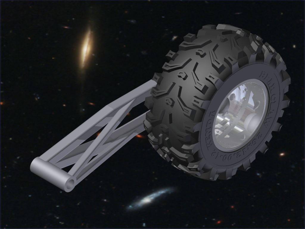

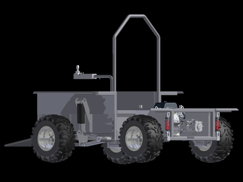

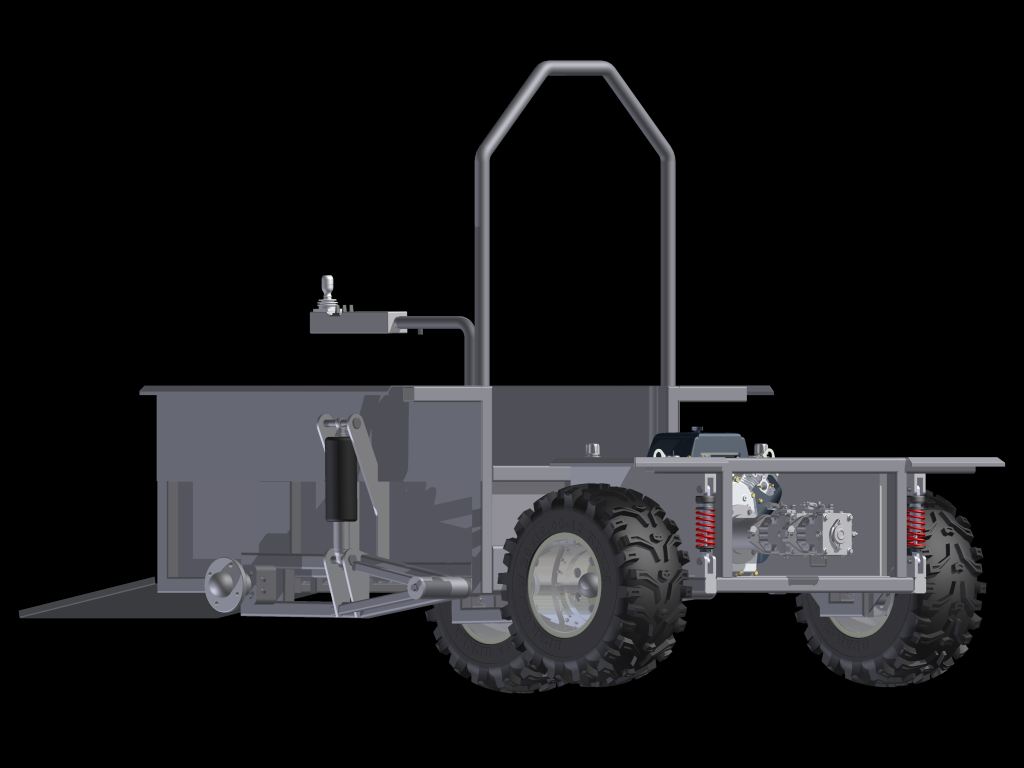

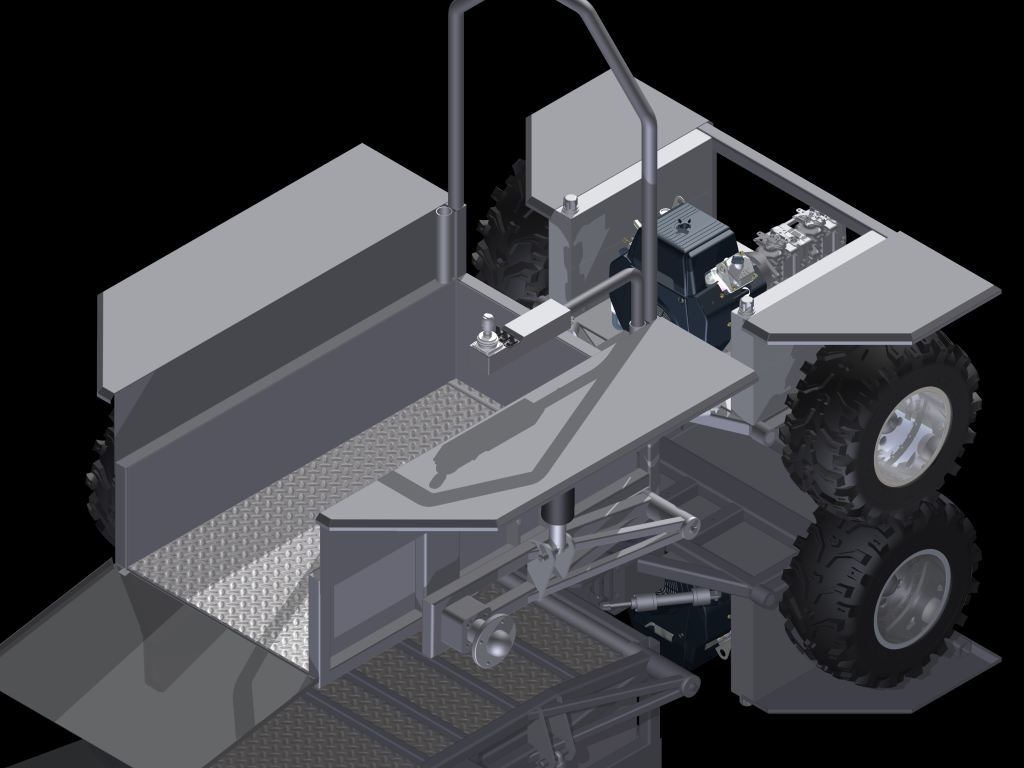

I made a few changes to the pivot arms, I added some more bracing to help the sideload when turning and being on slopes. just looking for some feedback as to whether it will be strong enough or not. The main shaft in the back that holds it all together, is 1.5 inches. It goes completely through the back of the machine to the other side.
