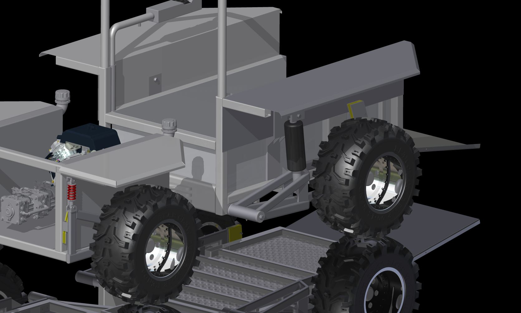

I'm looking for some opinions on which would be the best bushings to use for the front suspension. I've attached a photo that shows where the front suspension mounts and should be self-explanatory as to how it works. What would be the best materials for this type of application. I don't think it'll be too high of heat, but it will be quite rapid movement if the train is rough.

If your talking about the pivot point, I would think a needle pin bearing would be best for smooth operation and load capacity,

Look into what they use on VW suspension arms. ... I know dune buggies have a similar design.
You maybe able to use a sleeve and rod made from Steel. And then just keep greased with a zerk.
Of course bearings could be installed too...

it seems like urethane bushings are used a lot on pivot points. They are maintenance free, but I'm not sure how long it would last on an application like mine. Does anybody have any experience with them.

that's a good information site, but unfortunately they don't have the size that I need. I need 1.5 ID to 1.75 OD. I was hoping to get a tube of it and just cut the length I need. But that's proving to be difficult. But it does appear that plastics are the way to go.
