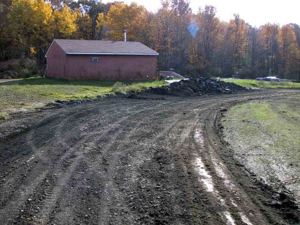

Not to steal your thread but .....
I don't have answers on this as I haven't started to research it yet myself but I have a great deal of interest - our house is cedar-sided with a stone and brick front. I'm not happy with the stone and would like to replace it - with the stacked fieldstone you mention or rounded river rock. I'm really not all that keen on the existing brick either and would like to replace it as well, but practicality (and economics) prevail.
We also have a 28' x 32' concrete block shed right at the entrance to our driveway - it is very ugly. The wife wants it gone but I'm unwilling to waste it - so we came up with a good compromise - turn it into a greenhouse. The thought was to disaseemble the shed, removing the roof but saving the trusses, then remove the block walls down to the 5th or 6th course and then stud frame it back up from there incorporating cheap (free, scrap, salvage) windows for the side walls and maybe some of that translucent roofing material for a roof to let the light in. And then cover the 5 or 6 courses of block that remain with some kind of stone facing.
This project is aways off for me - maybe next year or the year after .... but I'd be interested in any replies you get.

I was really expecting something different when I saw your pictures. Beauty is in the eye of the beholder, but to me,that's a fine looking building. Is there anything wrong with it other than you don't like the looks of it?
Ripping apart a building to convert it to a greenhouse is a very expensive way to go about building a greenhouse. Sort of like buying a new car to make a go cart. Lots of waste for something allot less than you started out with. But that's just my opinion.
Have you considered plantng a screen of trees or bushes in front of the builiding and turning an eyesore into an attractive landscaping feature to you land?
Or if you really want a greenhouse in that location, what about building one right in front of the building you don't like? You could make it exactly what you want and still have the other building for storage.
Eddie

My father built this back in '69 to store his tractor back when they built the home here. My Kubota won't fit in it without folding down the ROPS ..... I was gonna just put an addition on it for the Kubota but the wife said "You should just put up a bigger barn." ........ so who was I to argue ? :D
EddieWalker said:
Ripping apart a building to convert it to a greenhouse is a very expensive way to go about building a greenhouse. Sort of like buying a new car to make a go cart. Lots of waste for something allot less than you started out with. But that's just my opinion. Have you considered plantng a screen of trees or bushes in front of the builiding and turning an eyesore into an attractive landscaping feature to you land?
I see your point. It surely would be alot of work and not a insignificant expense. I have considered screening it, that would be fine coming into the lot from the street (north and west sides), it can't done though on the side (east) the driveway is on because it runs right next to the building, and I don't want to screen it so I can't see it from the house (south) - from a security standpoint (the building is probably 400' away from our house - but only about 30' from the road. We are the only people that live on the road, which is a dead-end ...... but still )
Now that's a thought too - screen the roadside of the building (north & west) with shrubs/trees and put a greenhouse on the southside, which would hide it from the house. Hmmmm ... choices, choices ...... :)
rswyan:
Why not just sheath this building in stone?
It would improve the looks, and you would not lose the utility of the building while the work is in process.
I have sheathed a small section of an interior wall in natural stone (irregular pieces about 1" to 1 1/2" thick, maybe 1 to 3 square feet each.)
I used the concrete backerboard screwed onto studs and mortar mixed with a lot of the acrylic concrete bonder in it for good adhesion to hold the stone in place. There is a concrete slab floor under it, but I made no specific attempt to transfer weight to the floor. I did fill in the gaps between rocks with the mortar also, so there is some weight transfer. The section is only 4' wide, but it is 8' high and there has been no problem at all over the last 16 or 17 years.
Take your blockhouse and pressure wash it really well to get a good clean surface. Wash the bonding surface of the fieldstone slabs really well, mix up some moratr with the bonding agent in it and start going.
Two tips.
Start on the side of the blockhouse you don't see from your driveway. Your skill will improve rapidly, and you want the mistakes to be on the side away from you.
With irregular rocks you need to get an area on the ground the same size & shape as the wall you are covering. Take your time and lay out the rocks in the exact pattern you are going to place them on the wall. If you spend the time, you will be able to generate a pleasant pattern with no cutting and very little rock breaking. In general, not doing this is what makes a DIY job look that way. Someone has mortar setting and hasn't really laid out his pattern so he just picks up a rock he sized by eye from 30 feet away and tries to get it to fit. Ends up with a kludge.
