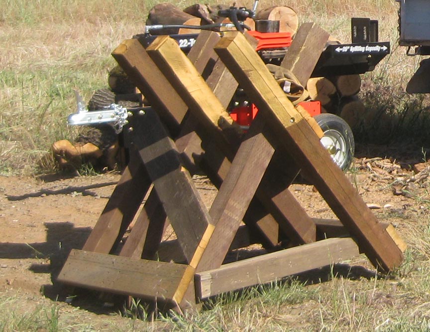

I found saw buck plans at instructables.com using 4x4x8' pressure treated lumber, so I decided to make one:
I adjusted the left to right spacing of the Xs to that I got 18" (my preferred split length) from the left side of the left X to the right side of the center X and 36" to the right side of the right X. In use, I drop a log or branch onto the buck with the left end flush with the left end of the buck. Then I run the saw bar down the right side of the right most X, then move to the right side of the center X and make another cut. I get two 18" pieces that way every time. If there's a drop from the first cut I put it back on the buck and do it again. When I'm chunking wood in the field, i try to aim for some multiple of 18", usualy 6'. That doesn't always pan out, but if I end up with short ends at least they'll always fit in the stove!
